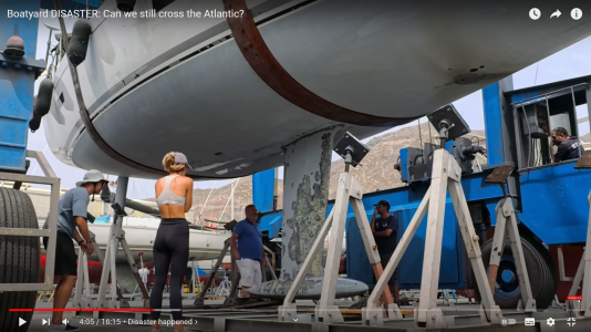

The boat looked perfectly level when it was being power washed and when they were inspecting the Hull prior to the incident. Not sure how it could have shifted to then require it to be put her down on the Keel. I cant see it being good practice to do so either. I would think the yard needs to explain why they did put it down and how they intended to control or alter the angle the boat while it pivoted on the keel whilst the weight of the boat was in essence off/out of the slings. If They needed to alter the boats angle they should have placed it over the cradle and sat her down on it while they then made adjustments to the slings. This way they would have had greater control over how the altered the boats position and crucially a safety net if something went wrong. So with the information Ive taken from this thread I believe the yard were careless while handling the boat.
Surely by placing the weight on the keel even if it should have taken the weight. the boat would only move off centre. Is it practice to place a keel on the ground and move a hoist sideways to correct/shift the boat in/on its slings. I can see people might do it, but it certainly sounds cavalier if not reckless.
Steveeasy
With a travel hoist the 2 slings can operate independently as can the props on the cradle. The norm is to lower the boat level using both slings until the keel touches the blocks then bring the props in to meet the hull before finally releasing the slings. There should be no need to lower one end with this type of lift.
My interpretation is that the boat was not sitting with the keel vertical and bow/nose down. so to correct this they placed the weight on to the keel which would clearly place excess force to the front structure. What I dont understand is, what they were trying to achieve is doing this, and how this would work. I think they have some explaining to do.

Where does it show that the keel has "fallen off"? The structure of the boat has been damaged but it is unclear how this happened - lots of assumptions and theories but no clear explanation.

looks perfectly level to me.
I see it the same way.
The smart money is on a pre existing problem that was revealed by bringing the boat ashore. It highlights how unsuitable these types of design are for adventurous sailing. Not just the keel but the whole concept and execution of the thing is up the spout for serious offshore amateur stuff. Racing design, even way back, sets fashions that are often poor cruising compromises.

I can't see anything from the video that would allow a viewer to say with certainty that the boat was level in the travel hoist. The owners state that the keel did not touch down evenly, hence the boat was not level.
I have discussed similar with marina travel hoist operators when an employer's racing boat was placed onshore. It was critical that the boat was suspended, supported and propped up in accordance with the OEM instructions before the load was released from the travel hoist. In later years there were dedicated cradles for certain racing yachts because setting down took so much time and effort.
The small chord keels, grid foundation, construction and design sensitivities have been well discussed in this forum, notably around the Cheeki Rafiki event and subsequent MAIB incident report. Whether this boats keel had previous damage or not, doesn't retract from the fact that load this type of keel wrongly and the margin of error between recovery without damage, and damaging the boat is very small, compared to similar keel designs that have wider chords.
Such a shame for the couple in question and maybe if the yard had not been so rushed, or had a better understanding, or the owners had information on how to shore up the boat without stressing the keel joint, the event would not have happened.
A very good summary. Worth noting in addition that the boat is 14 years old and well used. No way of knowing what has happened in the past - it may have been badly handled, grounded, dropped etc before with no visible effects and this was the last straw. Looking at how much dismantling was required to inspect the grid doubt it was routine so there is no "before and after" comparison. As others have observed the damage seems severe for a one off incident.
Cheeki Rafiki had been repaired from previous grounding damage it wasn't quite "as designed" when it failed.
This one looks like a manufacturing defect or previous grounding damage to me. The boat must have been lifted before, so I'm guessing someone had crashed it.
Possibly that Orca attack. They didn't do an episode about the rudder repair.
I note a number of images where the boat is shown from both the beam and aft - they all look perfectly normal. The above oblique shot was taken as the boat was raised after the disaster, nothing adverse to see there either.
