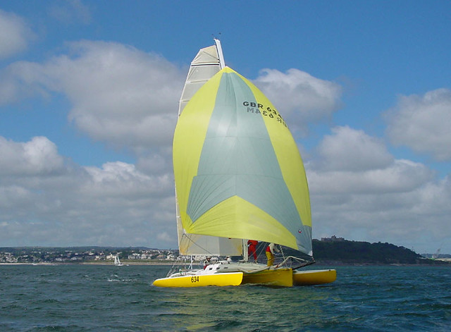

Here's an archived pic of 'Triohe', Richard Roscoe's fine handbuilt Farrier shortly after he 'n me won our Class in the 2003 Fastnet Race, completing a Series Win with four Firsts out of five RORC Starts, and a Second.
I can't now remember how much twinging and tweakery we used, but the boat was - at times - startlingly fast.
