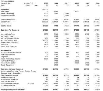

It's great fun sailing a yacht on the Mediterranean and enjoying life, but it's difficult to calculate reliable costs and figures for planning purposes. Many owners don't want to talk about the real facts and figures?
I have tried to make a plan over 6 years with the relevant cost estimates. As a newcomer, these are estimates with experience as a holiday charterer. The plan shoul be valid for a used Princess 50ft motoryacht, age 15-20 years, propulsion appx 2x 700hp.
May I ask for comments from experienced yacht owners: corrections or better values or wrong estimates I will gladly include in the plan.
All values are Euros.
Insurance looks too low. Also, are you master of the toolbox or will you be relying on outside help for general maintenance? I think you need to allow at least £3k PA to cover ongoing maintenance & replacement. All sorts will require attention, from batteries, toilets, AC, refrigeration, passerelle etc, in addition to engine maintenance.
While it is understandable that you are budgeting, there is a LOT in that list that can go wrong.
Also it is very dependant on where you intend keeping the boat.
It seems to me that you should consider this as a "moving" budget.
We bought our Princess 67 new, 17 years ago and I didn't budget to that degree.
Of course, you have to know that you can afford it.
I don't like paying over the odds so for me every expenditure is scrutinised.
I may not be the average boater but I've never planned to that degree.
One of your larger expenses is mooring costs which, IMO, are about right "on average".
However mooring costs will vary enormously from location to location.
Annual contracts will bring the mooring costs down as well.
For example on the South of France and in Mallorca, your mooring costs will be too light but (say) on mainland Med Spain, you will make significant savings.
As an example in our marina (Sant Carles - Spain) you could get a 15m berth privately rented for around 4500 euros for the whole year including electricity and water etc.
OK, so thats an extreme example but it shows my point.
So, to recap, I don't think I can comment too much on your overall costings.
Yes, you have to have some kind of budget but I wonder how useful a detailed list like this is.
And remember, boating is full of unexpected costs.
The spreadsheet is a personal choice, but I don't love this approach. It is just a bunch of guesses.
No-one can help you with mooring costs until we know where. Insurance looks light - you need 0.6% Fuel looks light at 1.55 next year. Engines surely D12 not D9 in this boat (?)
Treating depreciation as an annual thing, in same way you have treated opex, is ok if that's what you want to do but I'd question the sanity. Depreciation involves involves no cash outflow,
The bottom 1/3rd of the model doesn't seem to work. If looks like fuel is 11,160 in the first year, yet you have written 17,298. You seemed to have grabbed a value from the cell above, or something.
"Italy France Croatia Greece" is a very ambitious cruising schedule for such a small boat. I don't want to say you can't do it but I'm fairly confident it will present challenges. Especially unstabilised and with only 2,000 litres of fuel which will rule out some of the long legs of this type of cruise.
I agree.... To ambitious for a 50 footer....
Insurance looks too low. Also, are you master of the toolbox or will you be relying on outside help for general maintenance? I think you need to allow at least £3k PA to cover ongoing maintenance & replacement. All sorts will require attention, from batteries, toilets, AC, refrigeration, passerelle etc, in addition to engine maintenance.Hi
Hello - and thanks for your remarks.
I am a systems engineer with over 40 years experience, I own a MBA and I can fix many things with my own hands. I have no deep knowledge with marine diesels - but basic things will be learned. I have a Swiss yacht master licence and around 4 years of charter experience. But for some special maintenance I will relay on professional help.

Thanks - I have to be more specific:
The plan is to have a berth during winter time (october - april) in Italy. Some place around Genoa, perhaps Varazze, or Arenzano or La Spezia.
During summer time I will be around an other place: 2025 will be Italy & Sardegnia / Elba. 2026 South of Italy, Naples, 2027 perhaps Croatia - and one or two years I would like to cruise the Aegean Sea / Greece.

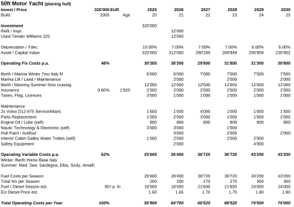

Ok - version 2 of my "Pirate-Yachting" planning ... with some clarifications and corrections >
As above, how useful is estimating depreciation in understanding opex? Equally why not include food and drink and other living costs?
What does your workbook really tell you other than that if your guesses are more or less right, and nothing unexpected comes up you will have spent a number of euros?
It's very simple: I am not a Billionaire with an anual income of 1-3 Mio. - I have to find some balance with my live and my family ... I do not count on each 1000 euro... The adventure and hapiness of cruising around the Med. has high priority - the magic moments living for some time on sea can not be valued in a "workbook".
The last three years I did not find people or owners who are really telling you the facts and figures ....
