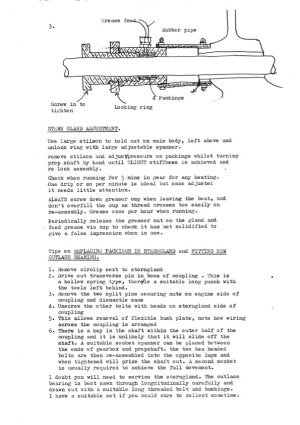

PM me if you need a bit of info on how soeone else has done something things on a 25, you mention the stern gland, adjustment is 'easy' as long as you are small enough and agile enough to get into (and more importantly Out of) the Port cockpit locker, replacing the packing is a bit more difficult but with luck you won't have to.
I use 'Ramonol' white grease, available from most chandlers, for stern gland greasing. To make sure that the plastic grease pipe is clear of solidified grease, undo it at the stern gland and turn the greasing knob and see if grease comes through.
I have a Sadler diagram and stern gland servicing instructions which I can forward to you if it helps.
