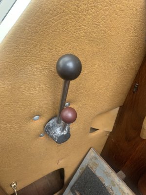

So to close this thread I have a picture of the throttle/gear control. Black lever to change gear and red for throttle. Further down the track I’d like to consider converting to a single lever system.
Not possible to get a single lever setup with the watermota JType gearbox because of the loads on engagement
I would suggest looking to see if throttle could be adjusted to prevent movement going over centre
It is possible that it was originally set up to avoid it

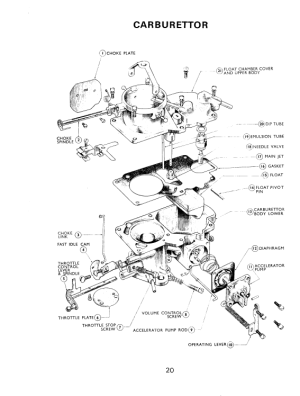

Hi everyone first post on here. I have bought a Birchwood 25. It has a Ford Watermota engine. I am working through the boat getting everything working before turning to the gelcoat and detailing. My question is about the throttle. To the left of the drivers seat is the standard 2 lever set up. Throttle and gear change. Now please bear with me this is my first boat. You push the throttle lever forward and it revs up. You pull the throttle lever back and it returns to tick over. But it’s not like that. You can pull the throttle back to tickover and if you accidentally continue to pull it back it revels up again. Surely there should be a mechanical stop that won’t let it pull back further than tickover? My thoughts are that the lever box has worn (50years old).
Apologies if this is a really daft question.
The throttle control in the cockpit push cable connects to the Throttle Control Lever and spindle. There is a stop to control slow running. It is almost imposible to get the lever to operate by pushing the cockpit lever forward or backwards. Unless there is serious bad adjustments made by some one who does not understand the working.
