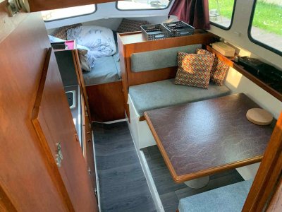

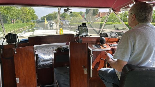

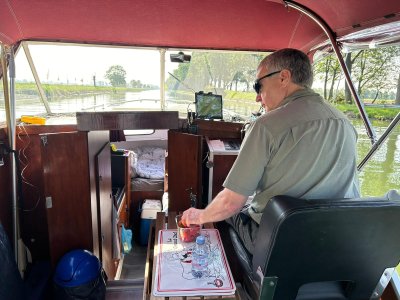

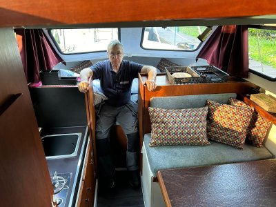

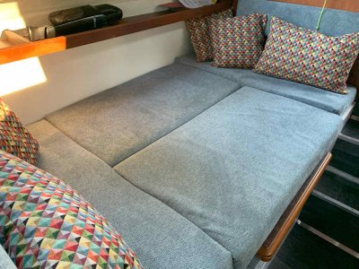

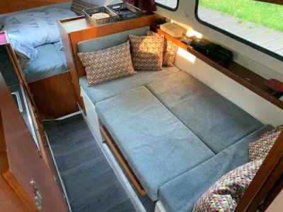

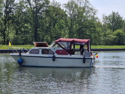

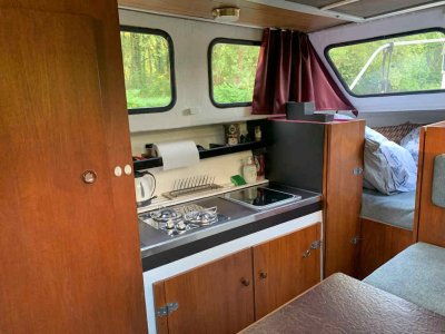

My boat is a canal/river boat, a Placom 750, she is 7.5m (24.6ft) x 2.5m (8.2ft) and allegedly can sleep up to 4 in the cabin, with a double berth in the bow and a dining table that goes down to provide another double berth, I'm 1.74m tall (or short...) and they are just long enough for me, my wife is 1.68m and she finds them cramped, she loves everything else about our boat but the beds, the bow feels claustrophobic to her and the dining table too narrow and short. Mind you a previous owner was 2m tall and he did extensive trips on the boat sleeping on board.
The boat has an inboard 2 cylinder diesel Volvo Penta MD7A 13hp with a S110 saildrive, she uses about .5litres per hour at 8km/h and at full throttle about 2litres per hour @ 11km/h boat and engine are 45years old now. She has a short keel that protects the saildrive and gives a mounting point for the bottom of the rudder, helpful when you get too close to the edge of the canal where it can get very shallow.
She is called Casper
Gives you something to look at when in the heads ;)
