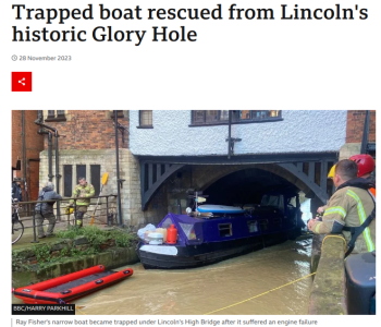

The flows on the river Trent can be strong and up to 3kts especially on the tidal river so being under powered is not what you want.
Okay 40hp might well in theory be overkill on a 25ft river boat if you never intend to go as far as The Humber but it should be more than capable / eg should not overheat if required against strong flows. If too little power is available this could result in difficulty in making progress.
The Fossdyke of course has no significant flow ordinarily. But where the navigation exits Brayford pool and becomes the River Witham there can be strong flows when water levels are high. On such occasions some extra horsepower may be welcome.
Trapped boat rescued from Lincoln's historic Glory Hole
