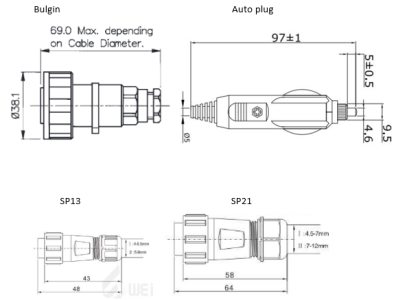

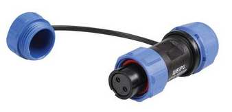

Bulgin are quite bulky and have got expensive. I have used these ones which are in two sizes either 13A or 30A in the 2 pole version. Inline and bulkhead versions of both pin orientations are available.
You need to be able to solder which will be easier on the larger version.
CPC plugs
CPC plugs
Are they more bulky than cigar lighter ones? Not sure there is much in it and I know which is the more reliable😄
Not much in it for cigar plugs but the SP13 ones are much cheaper, smaller and a higher current rating and also come with fitted dust caps. I have been pleased with the ones I used but as the OP is not keen on soldering they are not an option.

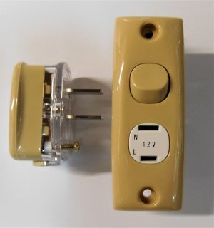

If you can find them then Clipsal is old school and very high quality. Will cope with high ampage. Our boat was installed with them in every cabin. I have things like an electric blanket and high power laptop charge on them. I try also not to mess about with cigarette lighter sockets. They're rubbish.
  • motorhome-caravan-clipsal-electrics-single-12v-socket-plug-switch.-5999-p.jpg
