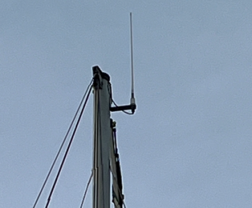

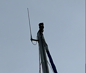

We havea centaur whicxh has no wind vane and I am missing it, We have a mast head aerial as in photos and my queston is if I purchase a VTRONIX Mast head Whip Antenna C/with Wind Vane or similar is it simple replace, are the wire connectors all a standard type?

The vtronix ones usually come with a cable and connector. Good opportunity to replace the old cable. You won’t know which connector is up there until you go and see it. Mousing a cable is quite straightforward.
samfieldhouse
18 Sep 2016
125
No, there are different connectors.
I replaced both my VHF and AIS aerials with Glomex Glomeasy models and corresponding RG8x cable - they use a specific connector.
An older aerial may have a different connector.

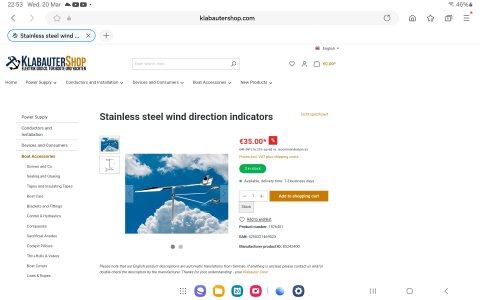

I Have a very nice powdercoated stainless steel stand alone wind vane that screws to the side of the mast. Its been extremely fat bstard seagull and his mates proof for the past 30 years and still looks like new.
I think mine is swedish but i found something similar (but not as nice) but since android has just updated i now cant find how to post a link. Grrrr
