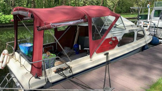

That's cleaned up really well. Years left in that canopy. You must be very pleased.
Yep, quite pleased with it, it's an old canopy from 2008, from the date in it, so the odd stain here and there is to be expected, I did try and get it cleaner but that was the best I could do in the time available, we are expecting a down pour at about 16:00 so wanted to get the tent back on the boat before that happened, I did have a waterproof cover over the boat for the past few days.
The guy a couple of boats along from me is about to change his as it is about worn out and his is less than 10 years old.

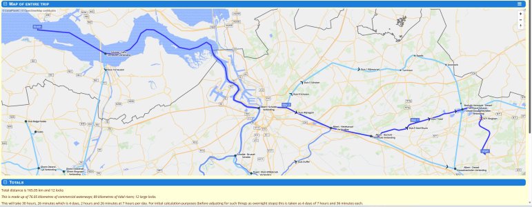

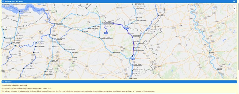

From us to the Scheldt in Antwerpen is about 60km as the crow flies... or 165km to the North Sea via canals: ( have to start at Leopoldsburg as that is the nearest point they can calculate from so -5km)
To the Maas (Meuse) about 38km as the crow flies or 85km via the canal:

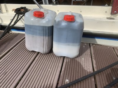

Nope, can't find the leak yet, tank tests out sound and is dry all along the bottom of it. I suspect it might be a combination of a leaking fuel pump and/or someone spilled a fuel can of diesel, plus when someone was changing the engine oil they just unscrewed the oil filter and the oil flowed into the bilge under the engine. The engine has the correct amount of oil in it, I checked before and today.
I have dried out the bilge and wiped up as much of the gunge as I can reach, the ballast concrete bricks are holding a lot of diesel in them and they are leaking out slowly, I have new bricks to replace the old ones with and 150kg of gravel to put back in the bow. Under the cabin there is no real access, it is suspended maybe 5cm from the bilge floor and is a sealed unit, taking off the cabin is more work than I am prepared to do at the moment, it is what it is. and the boat is stern down to let anything that is under the cabin flow to the stern.
Sounds like a big job. Obviously would be gutting to rebuild then have the leak return!
I've got to the point where I have to monitor the bilge and see if or where the diesel is coming from, now that all the liquid has been dried up I have absorbent pads down in the bilge and under the engine.

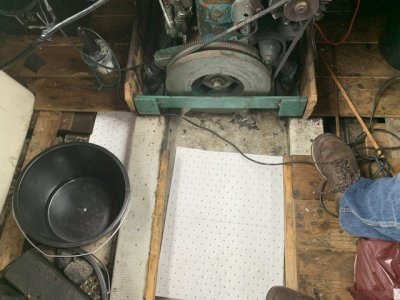

Went to Casper today and checked the bilges, the bow is dry and the majority of the stern is dry with the oil absorbent cloths picking up a little diesel from behind the engine, still need to keep an eye on that.

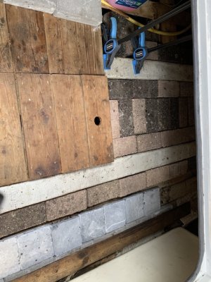

Today I was replacing the old clinker ballast with the new clean and fresh clinkers, that is 200kg replaced this morning and already the boat feels a lot more stable than she was with the ballast removed, I think I will have to add more to her tho as she is still too high out the water
No phone/camera with me yesterday

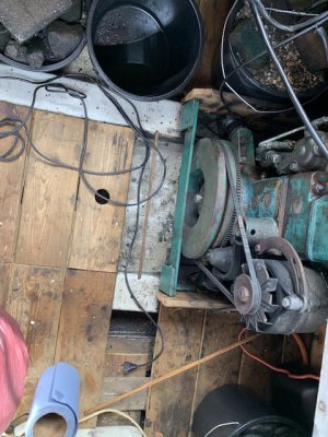

So this is the current situation
Bilge full of the old ballast

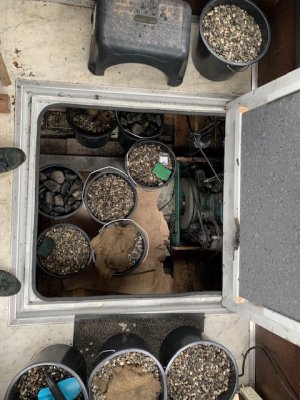

Ballast laid, now need to put the cockpit floor support back and remove the clamps that are supporting the floor just now then I can lay the lazarette deck again with new planks
125kg of stones in the bow and I’m going to tut a floor over that to make some better storage under the V-berth
