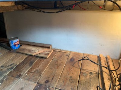

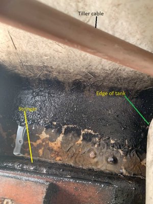

It's a 120 litre metal tank resting on two wooden supports which are also supporting the beams that the decking was screwed to
You can see the diesel oil against the stringer
the long grey part is the engine bearer, there is a load of small stones under the tank too, the yellow pipe is a T off the water line

Checking under the tank I can find no leaks or drips, and the bilge there is still dry after a few days.
It is dirty water that is coming into the bilge in the bow and that is coming in slow, a few hundred ml over night, not even half a litre, where before it was diesel.
The concrete blocks in the picture above are releasing the stored diesel back into the bilge too, a lot of the planks are soaked in diesel and will be replaced, with others there is no way to replace them without splitting the boat and taking the cabin off, and that is just too much work for me, it will have to do for now, I have done it before but I was nearly 30 years younger then, and this boat would have been 12years old then :)
The tank is aluminium and feels solid, I have ordered up new flexible fuel hoses and a Racor filter/ water separator. They should be here on Monday and I can replace the feed and return to the engine. The filler hose is hard and I will have to cut it off to replace it

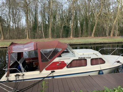

If you want to renovate your 'tent' then have a look at this video.
Red sprayhood revival.
I have got some cleaner and waterproofing for it, just waiting for the weather to improve a bit to get it done, I got a waterproof canvas cover to put on the boat while the tent is off.

Just home now and had a chance to look at the video, wow! it's even worse than mine!
At least mine can zip out and leave the frame on the boat 👍
UltraMar is the stuff I got, it was not that cheap but is supposed to be quite good, I seen it on this channel:

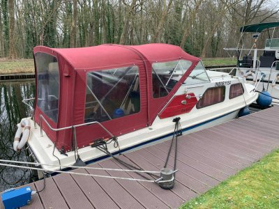

looking good. what did you use to clean the covers? I have to do the same in a few weeks.
Thanks, just the first treatment.
As per post #32 Ultramar, it's taken a good lot of the green and gunge out of the canvas but still needs another going over there is lichen growing on the top of the tent :oops:
https://www.ultramarxl.com/en
It was not that cheap, €80 for 2.5litres shampoo. + 2.5litres waterproofing. + 1litre of power cleaner, + spray can of clear plastic renovator, + application brush & 1litre spray bottle - that is a good quality one too with brass weight at the end of the pickup tube
Ouch it is a bit dearer in the UK! https://www.ultramarxl.com/en/collections/bundles/products/2-5l-complete-bundle this is the bundle I got.

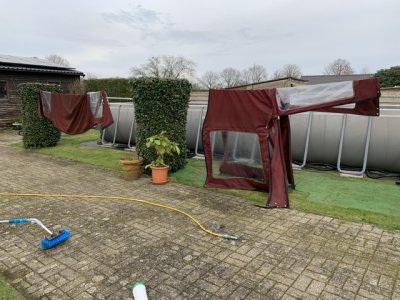

Day 2 of tent cleaning…
Clean…ish, they look a lot better now, just waiting for them to dry and then I can re-waterproof them.
I am glad I am using ground water as it would cost a fortune to take it from the tap to rinse the soap out of the canvas.
A question, how long do tents last on boats? This one is from 2008.
harvey38
27 May 2008
1,948
Friction and UV are the biggest killers of most covers. Their longevity can be maximised by keeping them taught to minimise rubbing on tubes, cabin sides etc caused predominantly by wind and as you have done, us a UV protector. Keeping them clean also,helps protect not only the fabric but just as import, the stitching. Those covers with clear panels in should be rolled and not folded, a good machine shop will replace clear panels if they become cloudy.
