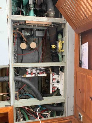

I was lucky enough that the previous owner had fitted a pair of Racors for each engine before the engine mounted diesel filters, looking at the old invoices it cost around €1700 to fit them in June 2020 :oops:

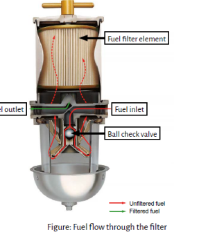

The Aluminium Ball can stick causing the fuel supply to be cut off. the following is copied from MAIB Safety Digest 2/2024
charter angling boat | machinery
Sometimes, it is the smallest things that cause the biggest problems. In this case, a 38ft charter angling boat became stranded due to a tiny mechanical fault while at sea with eight anglers and a lone skipper aboard.
The angling boat was some 800m from shore and in an area prone to fast-running tidal streams when the engine stopped. Attempts to get it going again proved unsuccessful and the skipper used very high frequency (VHF) radio to call for assistance. The local Royal National Lifeboat Institution (RNLI) all-weather lifeboat was dispatched and towed the angling boat back into port, where the anglers and their catch were landed ashore. A simple tale with a happy outcome, but certainly one to learn from.
The skipper investigated and found the problem with the engine after many hours of head‑scratching. Within the fuel filter was a ball check valve comprised of a buoyant aluminium ball designed to prevent fuel being syphoned back through the fuel system when the engine was switched off. This ball check valve was positioned at the inlet to the fuel filter and so exposed to a flow of fuel that had not yet been cleaned (see figure). The restrictions in the chamber where the buoyant aluminium ball sat had become clogged with debris over time and eventually jammed the ball, stopping the flow of fuel to the engine and causing it to stall
