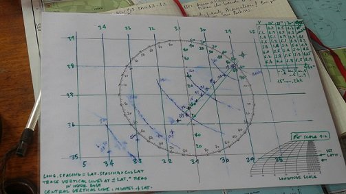

plotting sheets and a nice big chart table. I still have those plotting sheets on my boat but I doubt many do.
I have a home made one (laminated and used with non-permanent markers), seldom used and not for astro, though nice to have sometimes.
This was an approach to Horta, the sheet covered a few degrees lat/long, there was some very serious weather coming and I had the option to try and arrive before the worst, or if too late divert to the south to seek shelter, I had drawn some sort of iso-distance and iso-chrone lines to monitor the advancement of the boat vs forecast during the final days. Dimensions on the large scale chart were too small, draw all that into a plotter really not practical.

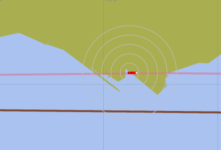

Back on the tools, opencpn plugin lets you plot a whole load of sights & compare. Today's graph didn't seem too bad but is 4Nm out from the last one. Wonder what's going on there, taken from exactly same spot, IE nearly zero both times, time taken from exact on the web... 🤔
Brown LOP is today.

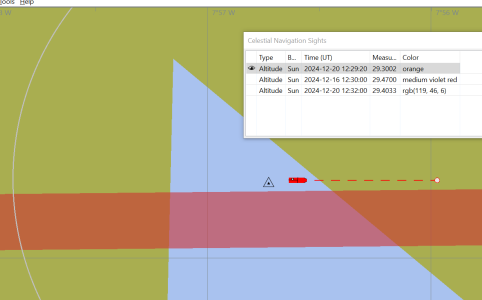

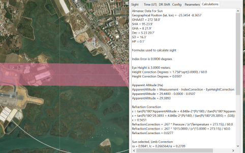

Brown LOP is today.

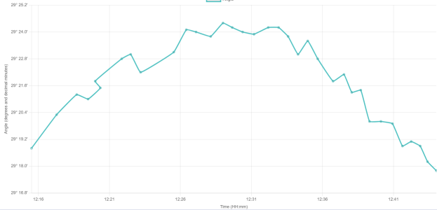

That plot looks very odd, the samples are not connected in time order, looking at points 1,2,3 and 4 which is the order of connection yet point 3 was taken earlier than point 2. Surely the correct order in terms of time is 1,3,2,4. Perhaps not significant but it wouldn't be normal to connect the data points of a time series other than in time order.

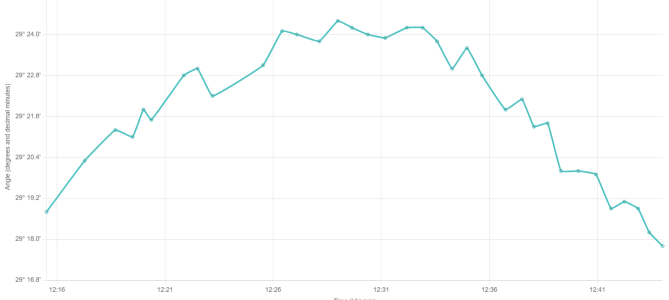

Yep, you're right. It draws the line in ascending y axis, not x. Doesn`t really matter though, it's just a tool to bang out sights & see instantly any differences. Which it's doing very well so far. So easy to focus just on the actual sight taking. I'll have a word with the AI & fix it 😎
Fixed, well spotted 👍

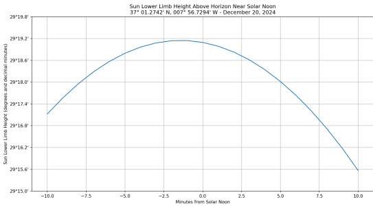

perplexity wrote some python in a moment but getting it in javascript for the web is a bit more involved apparently 😁
Doing a reverse meridian passage calc to get what the actual Hs should be at solar noon & working out the local solar noon time puts the lop in opencpn within 0.15Nm so that works then :) And good for the brain working out how to do the calcs from scratch 😎
you worked-out by hand to check the AI result :unsure: I think that I'm missing something :ROFLMAO:
Curiosity! 😁
And it might be wrong, or some source of numbers might be wrong. Major part of nav, trust nothing, if the answer is the same from various sources it's probably right.
The plotting bit is just turning a load of numbers into something visual so you can see anything interesting going on. And it was on a few sites looking at local noon thinking, I should be able to figure that out from 12:00 GHA & from sun dec what angle the sun is above the horizon at noon with ever having looked at a book so go on then, and do it with no paper.
Far more educational than blindly following what's in a book & forces you to visualize what's going on. Me anyway.
So GHA is on your side or 0º at 12:00 today , GHA- 0◦33.1, dec - S23◦26.1, so with a plane extending out from 0º long the sun has already gone past that so if you are further west then solar noon will be less than your long converted into time.
Same with lat, if the sun was over the equator and you were at the north pole the sun would be 90º to a line shooting straight up.
Just doing sums by rote teaches you nothing, figure out how to do it yourself & it all makes much more sense 👨‍🏫
That was all done converting base 60 minutes into decimals and working in base 10 again, calculator came out for that, wouldn't trust doing mixed addition with integers & base 60. Better dig a book out & see how they do it now 🤔, not that there's a right & wrong way in maths or geometry if it gets the same results every time.
