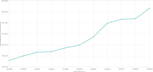

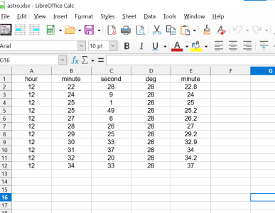

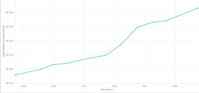

this thread is a nice bit of motivation to dig out the sextant again & get some practice in 😎
Graphing by hand is boring and reduction is just maths, once you've got the hang of 2 + 2 = 4 repeat as often as you want, ain't going to get any better..
Taking sights though is muscle memory like playing a musical instrument so seems a good idea to spend 10/20 minutes every day banging sights out like running through scales on a piano. And quicker than it took to type the 30 words asking an AI it wrote a webpage to plot sights against time.
Either input one a time or save on a .xlsx spreadsheet & upload.
click here
Time vs Angle Graph
There if anyone wants it, spreadsheet needs to look like >
which was a few from today.
So now it's just put the time in, trying anything which comes to mind changing halfway through & see what happens, stand different, UL or LL, bring the target up or down, try stuff with an open mind just to see what happens can be very educational & a great way to learn more imho.
Looks like >
What's your look like?
click here
Time vs Angle Graph
Looks like >
That's an interesting approach and, for you and other like-minded geeks (meant to be a compliment) combines a couple of your interests.
Re the plot: 1. can you correct X-axis scale? 2. if you show correct time/scale, can you make it draw a "best straight line fit"?
The (potential) problem with computer generated best line fit is that it will take all data points into consideration. When I look at my sights, I may think "oops, that one isn't right" so ignore it.
I'm afraid that I'm polar-opposite and don't find that "graphing by hand is boring", I rather enjoy the whole process.
Yeah noticed the x axis, I can't fix anything but know an AI that can...
Got it to write some python as well which is well on the geeky side, that will be interesting just to see what can be done & learn more about statistical analysis techniques.
Putting in some numbers and clicking plot isn't actually all that geeky, just really quick :)
There if anyone wants it. 💐
edit: x axis fixed
