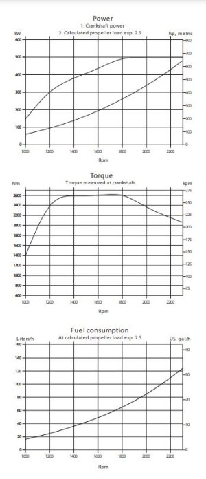

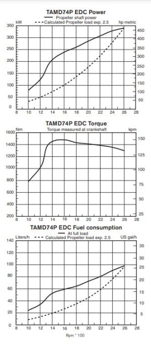

My friend is interested in a 2002 Princess 50 who has the TAMD74 480hp engines. Boat is ashore and the broker can´t tell any numbers about speed etc
Does anyone have experience of how it performs with these "small" engines? How underpowered and tired is it?
Option(which most boats of this size and year has) was the D12 675hp who has tons of more torque. Must be a huge different
I guess this particular boat will be hard to sell due to the 480hp engines? Stupid to buy?
My friend mostly cruises at 7 knots so he still considers this boat if it can be bought for the right price

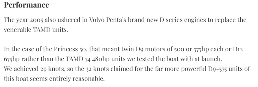

The Princess 50 (mk.1) was available with D12 675hp in just some months after its launch in late 2020.
With 675 it reaches like 34 knots. I had a 50 from 2002 for sale (now sold) with those engines some years ago.
