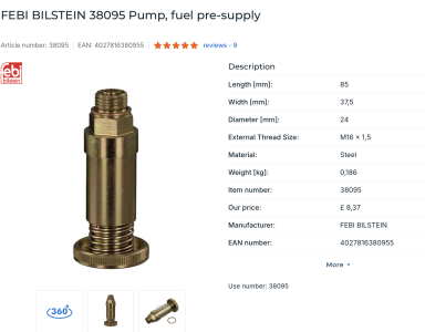

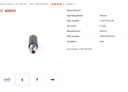

And can anybody tell me whether this sort of thing might be suitable instead? (One review of the same thing from another supplier mentioned it replacing one on a tractor.)
1749414041701.png||

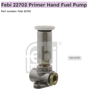

This (below) seems a similar thing but I can't see how it would be used except with a further fitting with a non-return valve (which is presumably what the lower part of the Febi primer above is?).
But how do you know if the one you're buying is decent quality? I suspect that at least some of the name brands are exactly the same thing except dearer.
The Quicksilver ones, for instance, seem like good quality and last well. Or, buy one from the likes of Peugeot or Citroen etc, they fitted tens of thousands of them.
View attachment 194536||
That style does work, i have one on each engine just like it.
