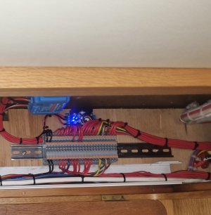

Just accept that you are wrong. The wires don't look well supported.
You are sitting on you boat several thousand miles away and you have never been on my boat so how can you be so certain based on a photo. This is a forum and I posted the photo in answer to questions about using Wago connectors. Nowhere have I sought approval for the way I have clipped the cables - the method I have used is appropriate for the location.
I don't need your, or anybody elses approval for what I do on my own boat.
Fit DIN rail
Clip connectors onto the rail
Strip the ends of the wires
Crimp on bootlace ferrules to the stripped ends
Push into the connectors
If you need to remove a wire press the orange release catch and pull it out
Available in 2, 3 or 4 way variants, plus more with the stacked ones.

Badly supported wiring is not appropriate in any location, boats or anywhere else.
I don't need your, or anybody else's approval for what I do on my own boat.
Indeed you don't, but you have been politely told that the cables are not correctly supported, your arrogance prevents you from learning something, hopefully others reading the thread will not suffer thus.

You posted a photo of something that looks poor. You can't take the criticism of a professional marine electrician. You are never wrong are you

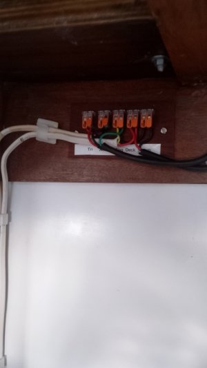

This is the small panel I made up for connecting the cables from the mast. Wagos stuck onto the board with superglue. I have use similar in a variety of places in rewiring the boat.View attachment 204204
Sorry to add another criticism. Good to see a proper label, so often omitted, but it's obstructed by the wires. Why not put the label above the connectors?
