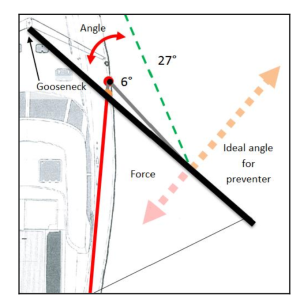

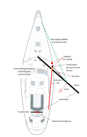

When I bought my boat, like most sailors I checked the control systems and realised that there were no preventers. That is not to say that the previous owner never rigged something up but It was something that I had to consider. There are various methods of laying out control lines and devices that use friction to stop the boom accelerating violently. After a lot of thought I rejected all the pre described systems focussing on what I wanted to achieve which was to safely get the boom into a position where I could control it with the mainsheet and mainsheet traveller. I achieve this by setting a block on the gunwale further aft with control lines running from the boom to the cockpit This allows the boom to move freely for about 30 to 45deg before it is held by the restrictor and at this point it is under very little load as the wind has not yet caught the sail. In this position I can now take control with the mainsheet and Traveller. My Preventers live most of their life hung on the guard rails ready to be clipped on when needed.
Like others, I'm having a big of trouble visualizing this. Do you mean you aren't restraining the boom at all from forward? Maybe I'm just not seeing it, but that doesn't sound good to me. Why?

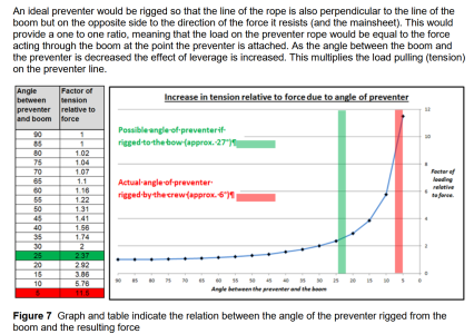

1. As others have said, if the boom has scope to move, it will be able to build up momentum which will greatly increase the force on it. It doesn't need to move all the way across the cockpit for this to be a factor.
2. What is the angle of the line to the boom which you are expecting to restrain it? This is critically important, because the angle magnifies the force, up to many orders of magnitude. The closer the attachment point is to being under the boom, as opposed to being ahead of it -- so the angle calculated by horizontal vs. vertical distance between boom and attachment point -- the greater the magnification of force.

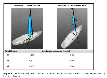

That is why best practice is considered to take the preventer all the way to the bow, which improves this angle, and why preventers taken somewhere midships are considered extremely bad practice.
The definitive resource on this question is the Platino accident report, which you can find here: https://safety4sea.com/wp-content/u...-NZ-Platino-Accident-Final-Report-2018_07.pdf. No one who has not studied this carefully, can consider himself up to speed on preventers.
The accident in this case, which killed two sailors, resulted from improper rigging of a preventer, in this case near midships rather than right out to the bow. The accident report gives all the physics and math to show why.
I am in the camp, along with several others posting in this thread, who rig their preventers right out to the bow, and who put them on hard to reduce motion as much as possible. My preventers are Dyneema to reduce motion further. As someone else commented -- if the boom can't move, it can't develop a lot of force. The force of the sail being taken aback is manageable so long as you don't have momentum of a swinging boom to deal with.
Note, however, that there is yet another problem with preventers, not solved by taking them out to the bow -- if you have aft-swept spreaders, as I do, then the boom may not be far enough out to get a reasonable angle. Which has an additional bad effect of loading up the gooseneck. On my boat (YMMV) the angle is OK when running off deep, but not good enough on a slightly broad reach with the boom in further, but not in far enough to not need a preventer. In bad weather in such a posture, I use a jockey pole to change the angle of the preventer.

This is the best resource on preventers I've ever seen; this and the Platino accident report should be required reading.
Basic summary points from the extremely well-researched and engineering-literate series of articles:
1. Preventers should always be rigged to boom-end, never mid-boom.
2. Should always be run as far forward as possible; never midships.
3. Should not use elastic cordage.
4. Should be strong enough based on calculations (a spreadsheet is provided).
5. Should be fixed to an appropriately strong fixing, and never a mainsheet bail or outhaul car.
6. Turning point at the bow should consider doubling of the load for a 180 degree turn (bring across and back the other side if this is a problem).
7. Should be set hard with no slack and some pre-tension.
8. Should be used from a beam reach and anything deeper.
All definitively proven with math and engineering.
In addition, John doesn't like boom brakes, and argues persuasively against them.
