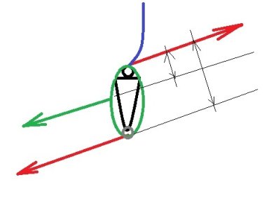

If you are attaching your preventer to the place where the main sheet attaches, then, even if it's a bit forward, presumably the boom is engineered to take the loads there.
i guess what i don't know is whether you have drawn the whole boom in your figure, or whether you have drawn just to where the main sheet attaches. I know you have said the boat has a short boom, but is it end-boom sheeting?
modern boats often have end-boom sheeting, and the boom is not really designed to take a bending moment forward.
But there is also another potential problem; the loads on the preventer itself
the further forward one attaches the preventer, the greater the potential loads.., irrespective of where the main sheet attaches.
so the next question is: is your preventer and all its attachments strong enough to take the load generated by that geometry? Your main sheet might be 4:1, or 8:1, is built with strong fittings, and is designed to handle the load..., whereas the preventer is probably a single line..., what are the fittings?
as shown above, the further out on the boom you can get the preventer attached, the lower the loads on that system, and the difference can be dramatic.

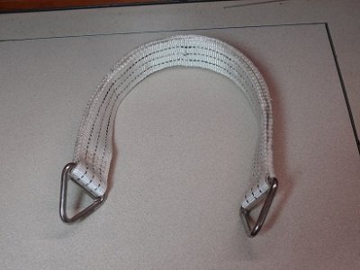

The boat had several version and the sheet arrangement came in various types: end of boom tackle, two/third boom tackle (two multi sheaves blocks or various single sheave blocks spaced apart - which I have), even single sheet German, the boom can basically resist everything; the mainsail is relatively small by modern standards.
This is the boom strap I made for the preventer (should probably be enough to lift the boat :) ), all the other components are roughly sized accordingly.
I also replaced all the mainsheet block attachment padeyes formerly located along the lower side of the boom with straps, when sailing downwind the blocks are free to turn around the boom so it removes a lot of the torque on the gooseneck; with all this talk of extraordinary loads, these attachments (for preventer, sheet blocks, etc) on the underside of the boom are a punch in the eye in engineering terms :)

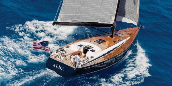

The Swan 54, which I have sailed on quite a bit, has an aft cockpit but with companionway sheeting for the mainsail. I think it's an excellent cruising boat; if you can afford it...
some of those 54's also have the ability to sheet to a traveler, if racing - you can switch back and forth.
but the companionway sheeting is much safer for cruising on a boat that size.
Laser310
15 Sep 2014
1,457
A stock photo of the Swan 54 - but it happens to be the one I have sailed on
The sheet is actually well forward of the cockpit - you definitely loose a few degrees of point, but it is a safe setup
That's a German mainsheet. I had that on a previous boat. The most polite thing I can say about it, is that it sucks!
A really powerful hydraulic vang will mitigate that suckiness somewhat, but only mitigate.
We had a normal rope vang, so the suckiness of that arrangement was unmitigated. Never again.
