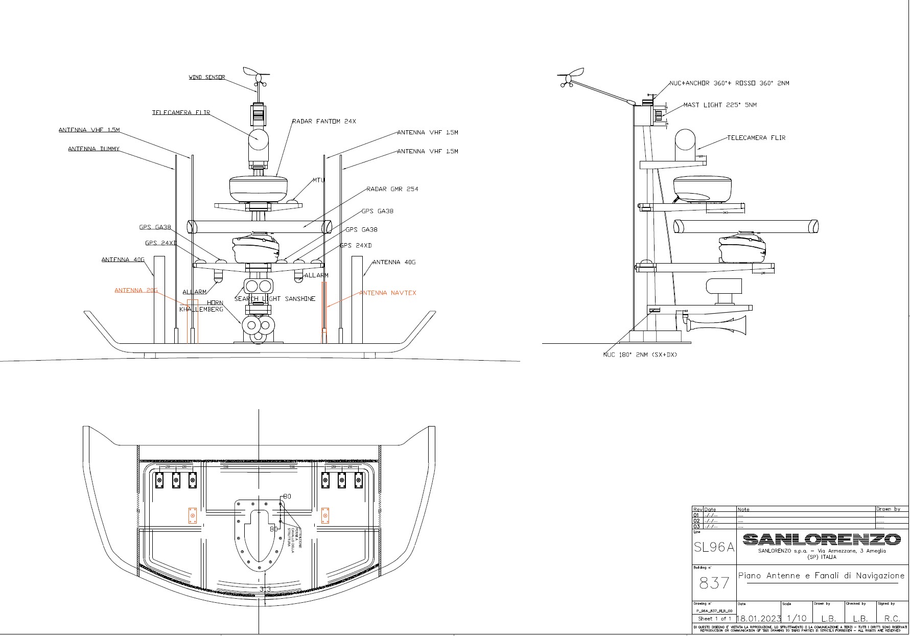

This image is easier to understand 🤗I am alone in wondering how its all going to work ?

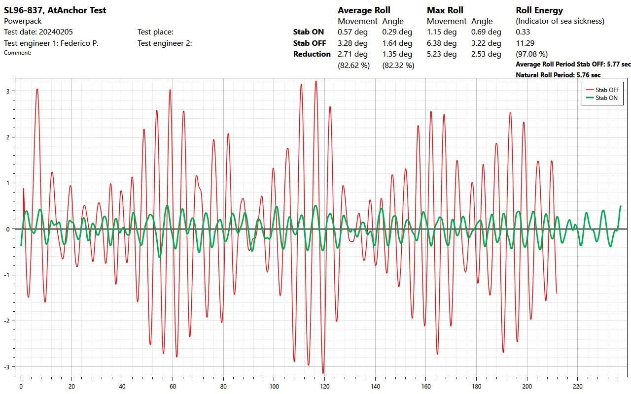

In other more interesting news, the boat had its first sea trial yesterday. Below is the graph from Sleipner of the stabiliser performance. This is raw out-of-the-box, before any fine tuning, and as you can see it wasn't a rough day, but nevertheless the results are very decent indeed. Also it's nice to see that the natural roll period is a slowish 5.76 secs, hence the pleasingly long X axis of about 3 and a half minutes. That roll period is about 5x longer than a 40 foot itama, and all that brain bashing that occurs on an itama might explain a few things :) .
I don't have any other pictures (yet). As regards timing, it is feeling like the handover might well happen just before Easter holidays, which would be nice.
Very, very interesting, J.
Many thanks again for sharing all of this with us - against all odds, if you see what I mean... (y)
It's probably neither here nor there in terms of relevance for the on/off comparison, but out of idle curiosity:
what's the difference between movement and angle, in roll measurements?
I can't recall to have ever seen it in some other similar sheets (albeit for non-Sleipner stabs) I came across in the past.
Indeed against all odds :)
It reflects the asymmetry of a roll. Movement is the total angular stroke of the roll, whereas angle is the max deviation of the boat from pure horizontal. So movement is always about 2x angle, but not quite, when the roll is asymmetrical. It's not that useful for everyday users like us :)
Slightly interestingly, you get more asymmetry (eg 1.15deg movement vs 0.69deg angle ) with stabs on than stabs off, which is what you would expect because the stabs are interfering with mother nature and are not even trying to achieve symmetry.
