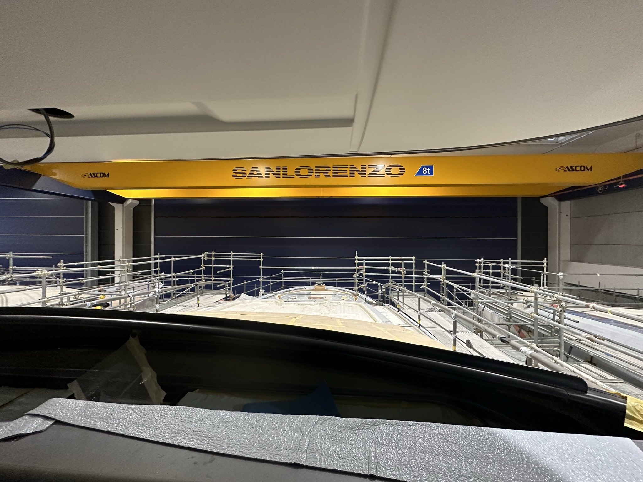

Fastforwarding now to week 1 of December 2023, and there's quite a lot of progress. Sanlorenzo said that building this boat is quite like building a prototype, and that they have increased the workforce on it to the size normally use for prototypes, so progress has been quite fast.

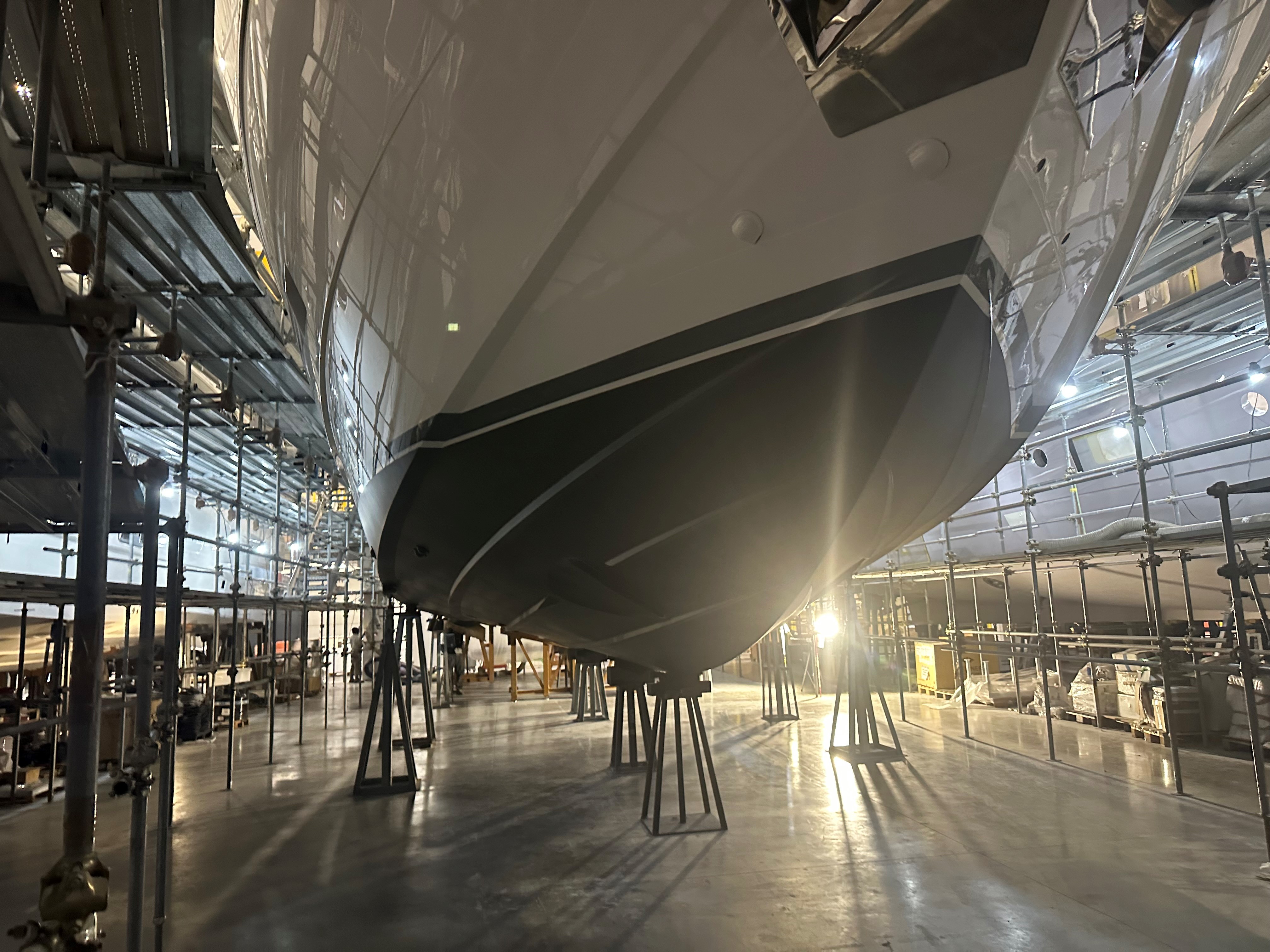

First the hull is all antifouled (sprayed) and boot topped, and basically ready for launch apart from Propspeed (which has since been applied). The waterline has been painted 60mm higher than standard, because from seeing the boats in the flesh and online I think it is painted too low on the standard boat, and this one is also a little heavier than most:

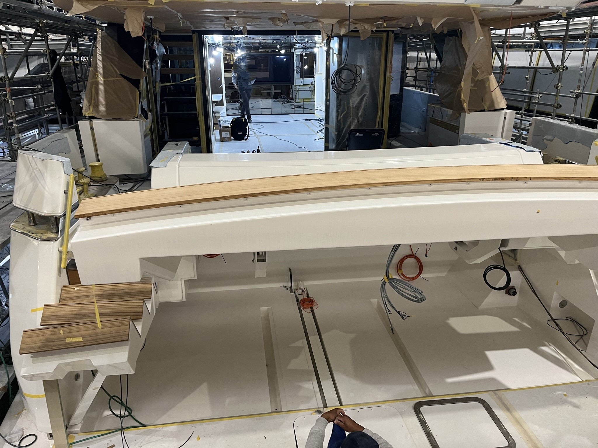

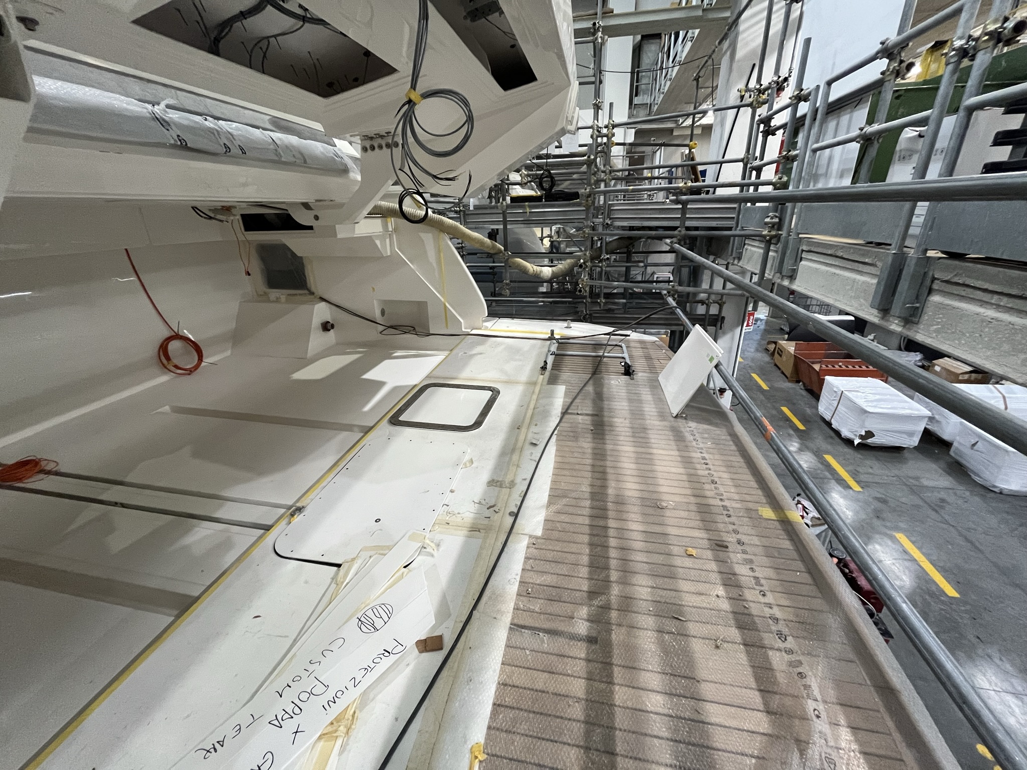

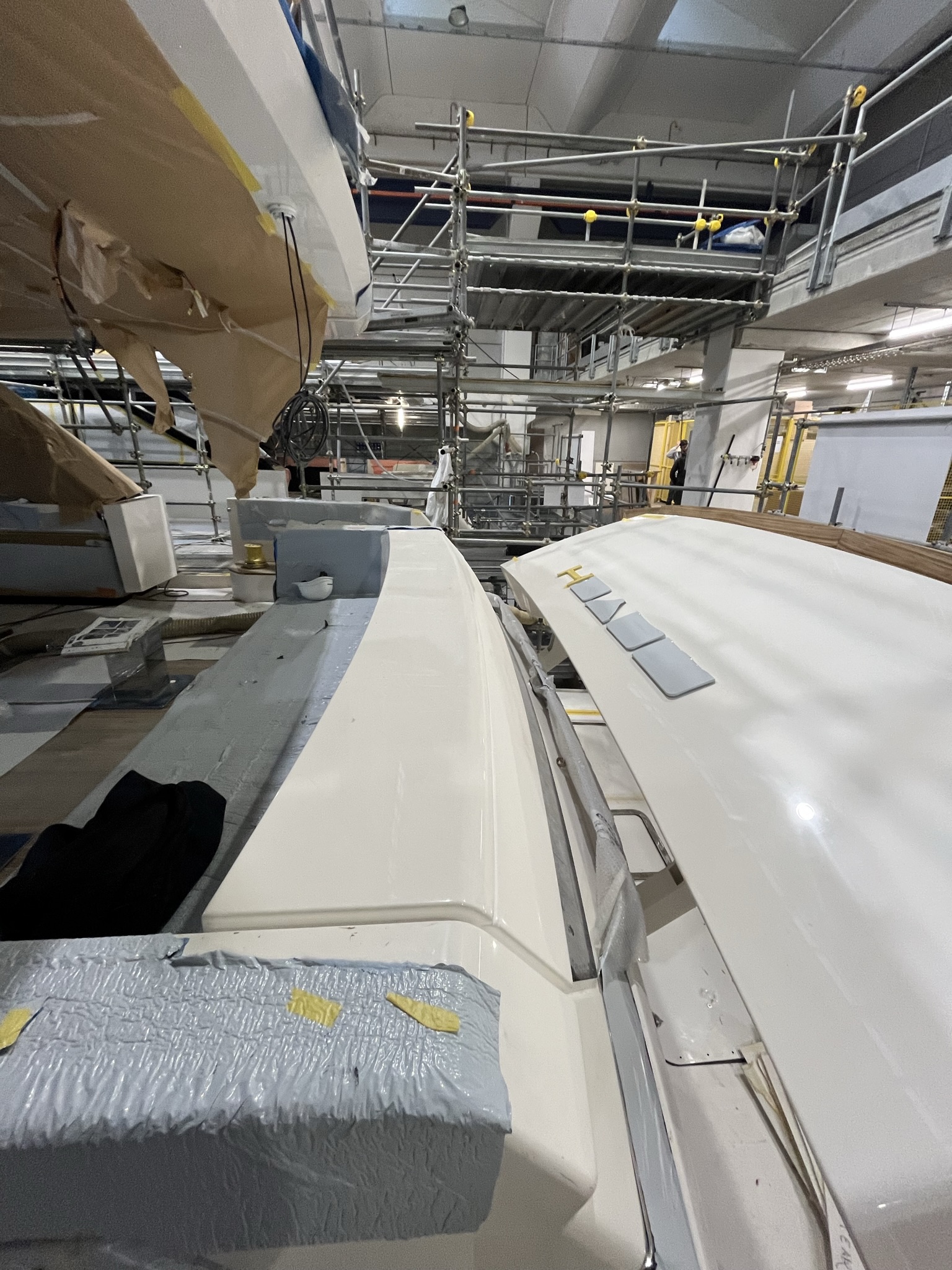

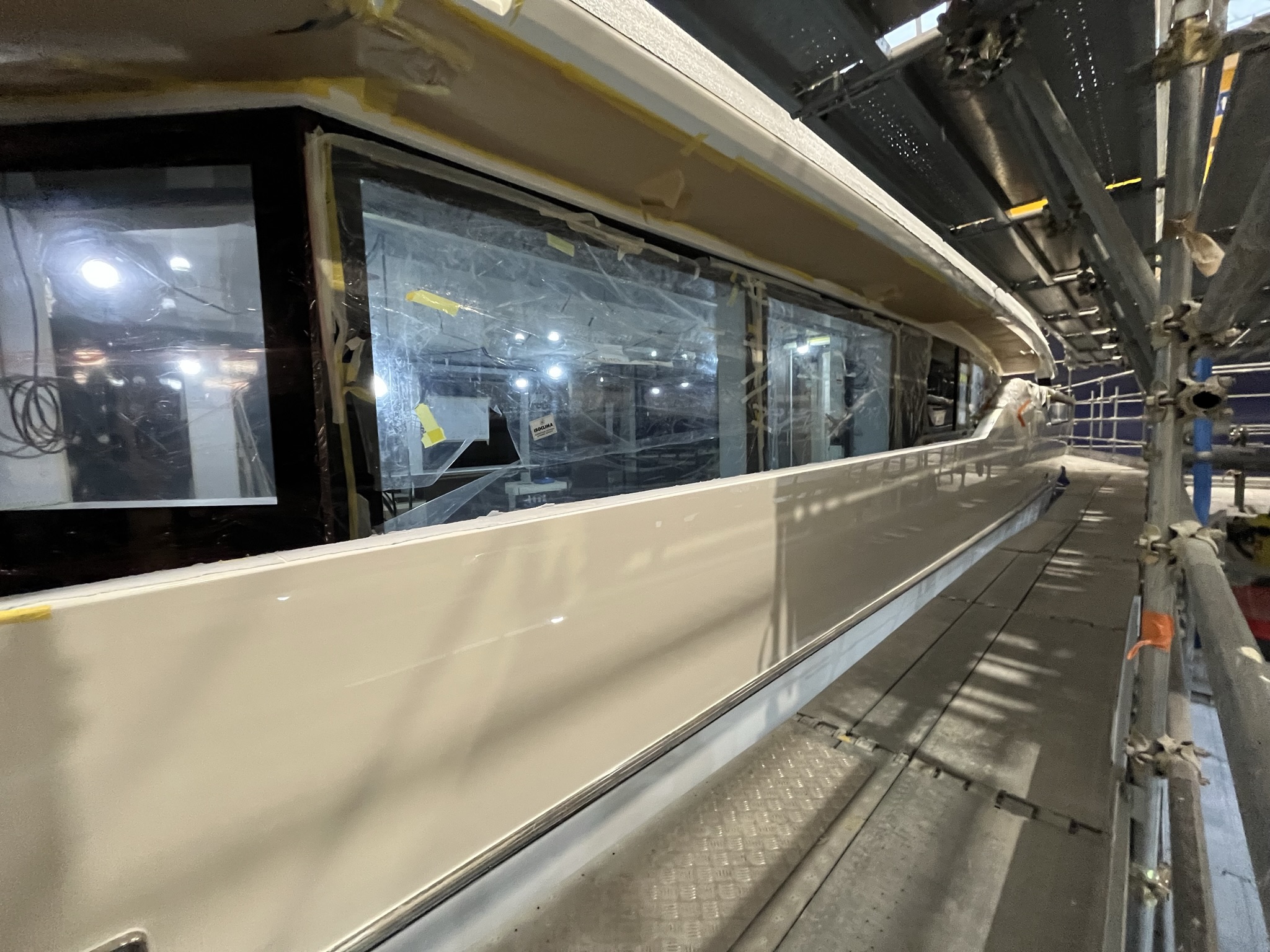

Next a few pics of side deck and garage area, again well on the way to completion:

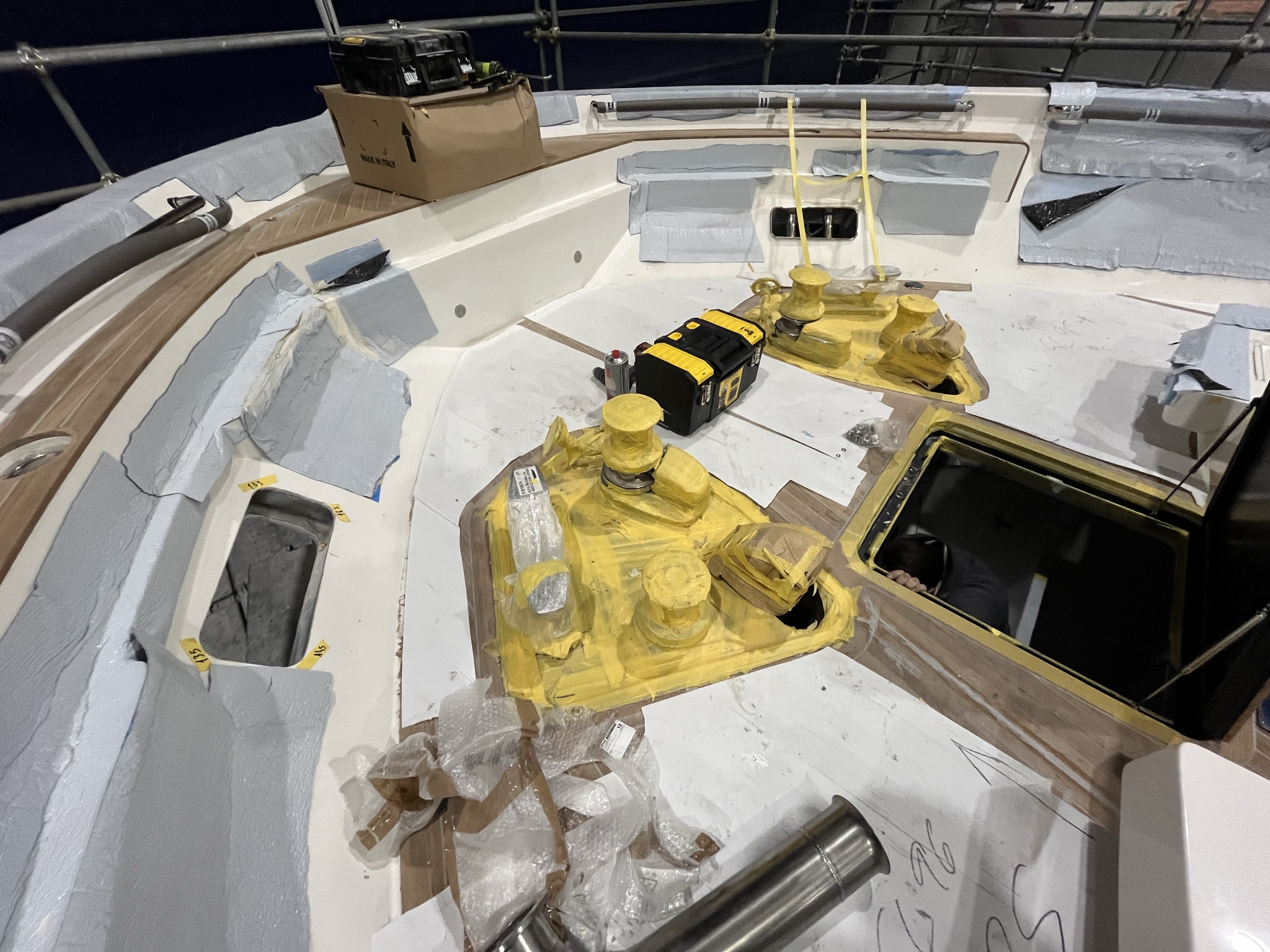

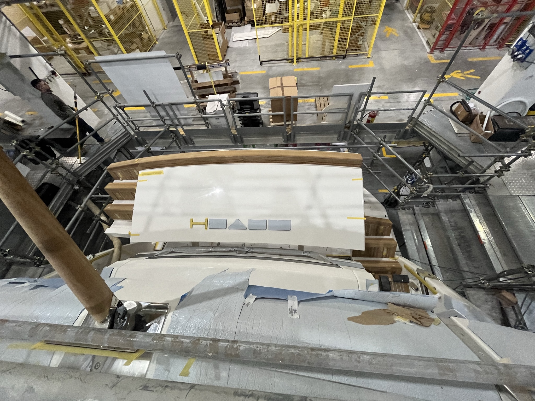

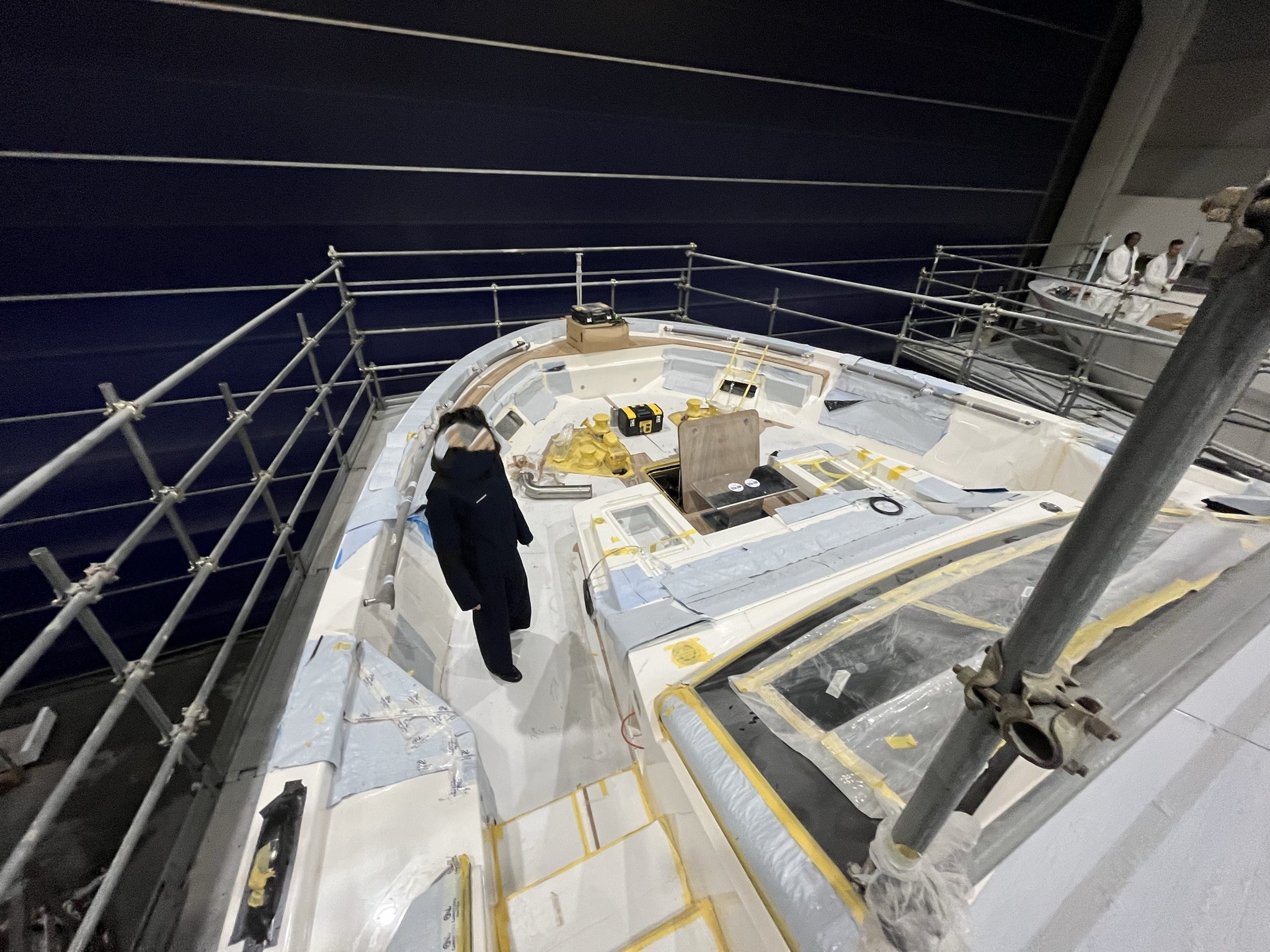

Foredeck is also close to completion. You can see (wrapped in yellow) the extra capstans I asked for, so 4 capstans in all. All 400v 3ph electric

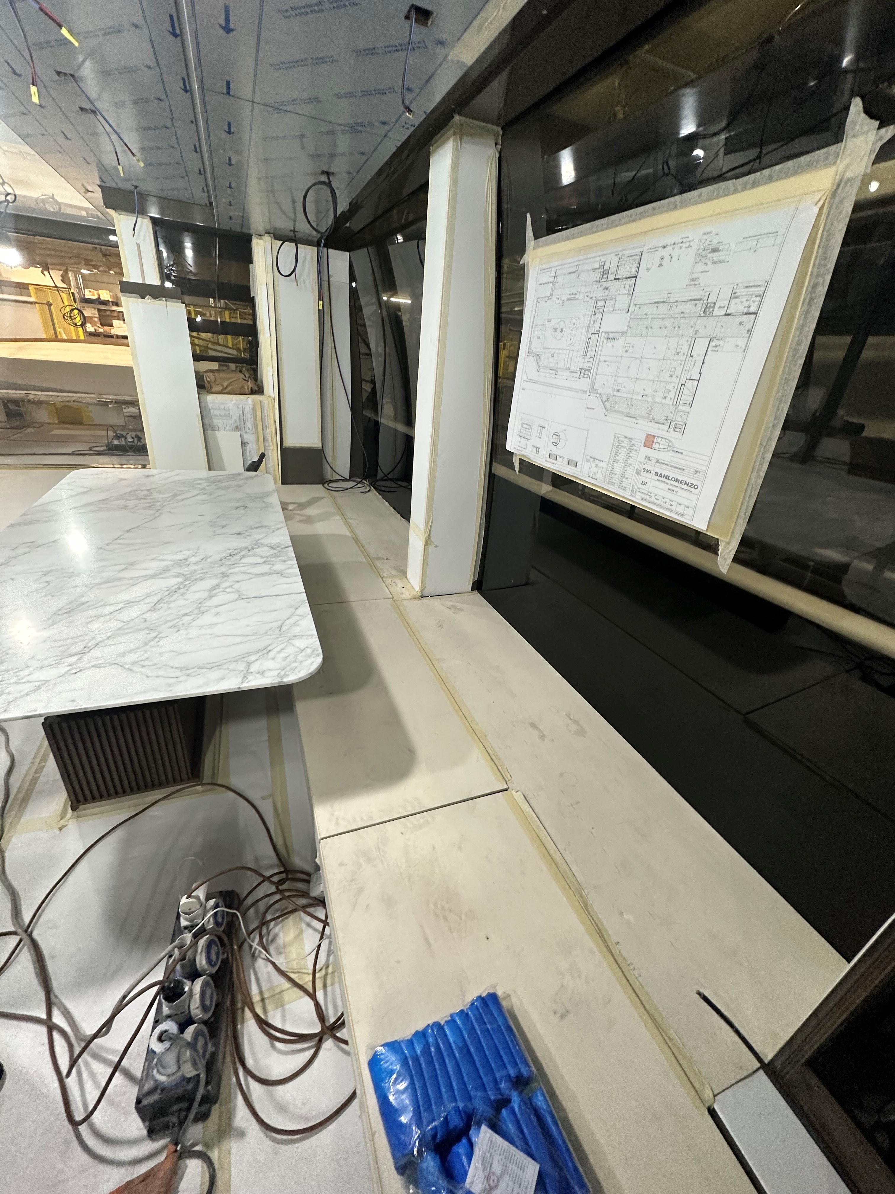

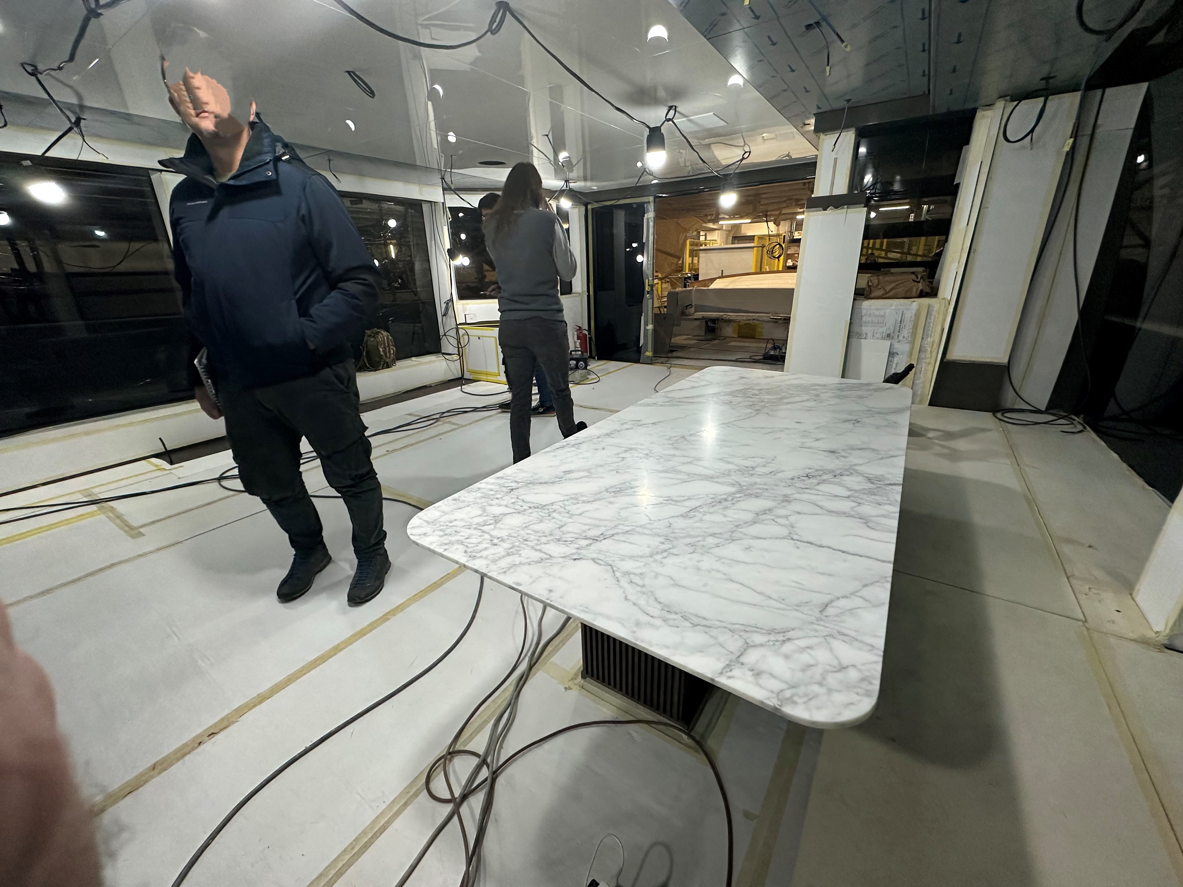

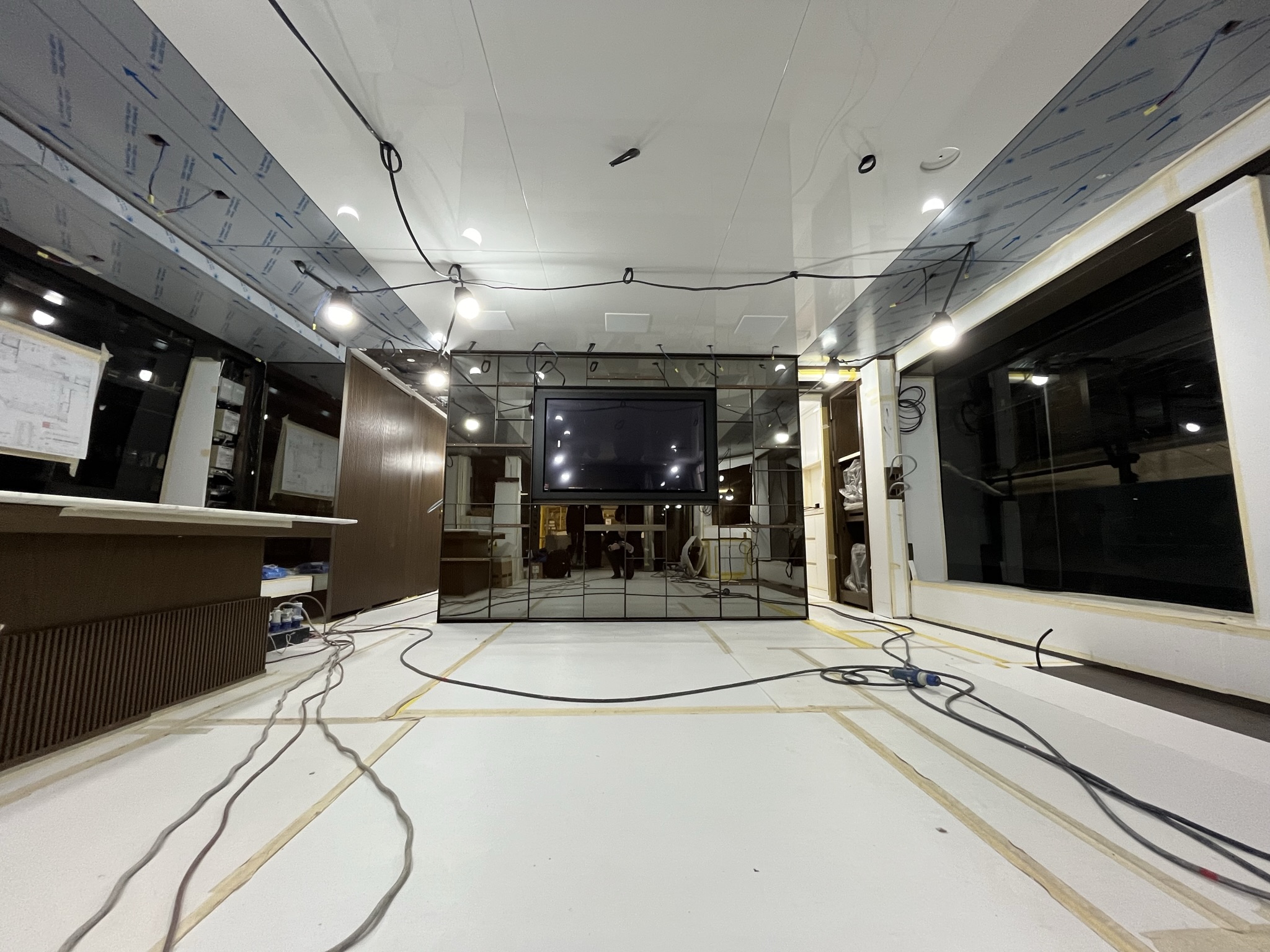

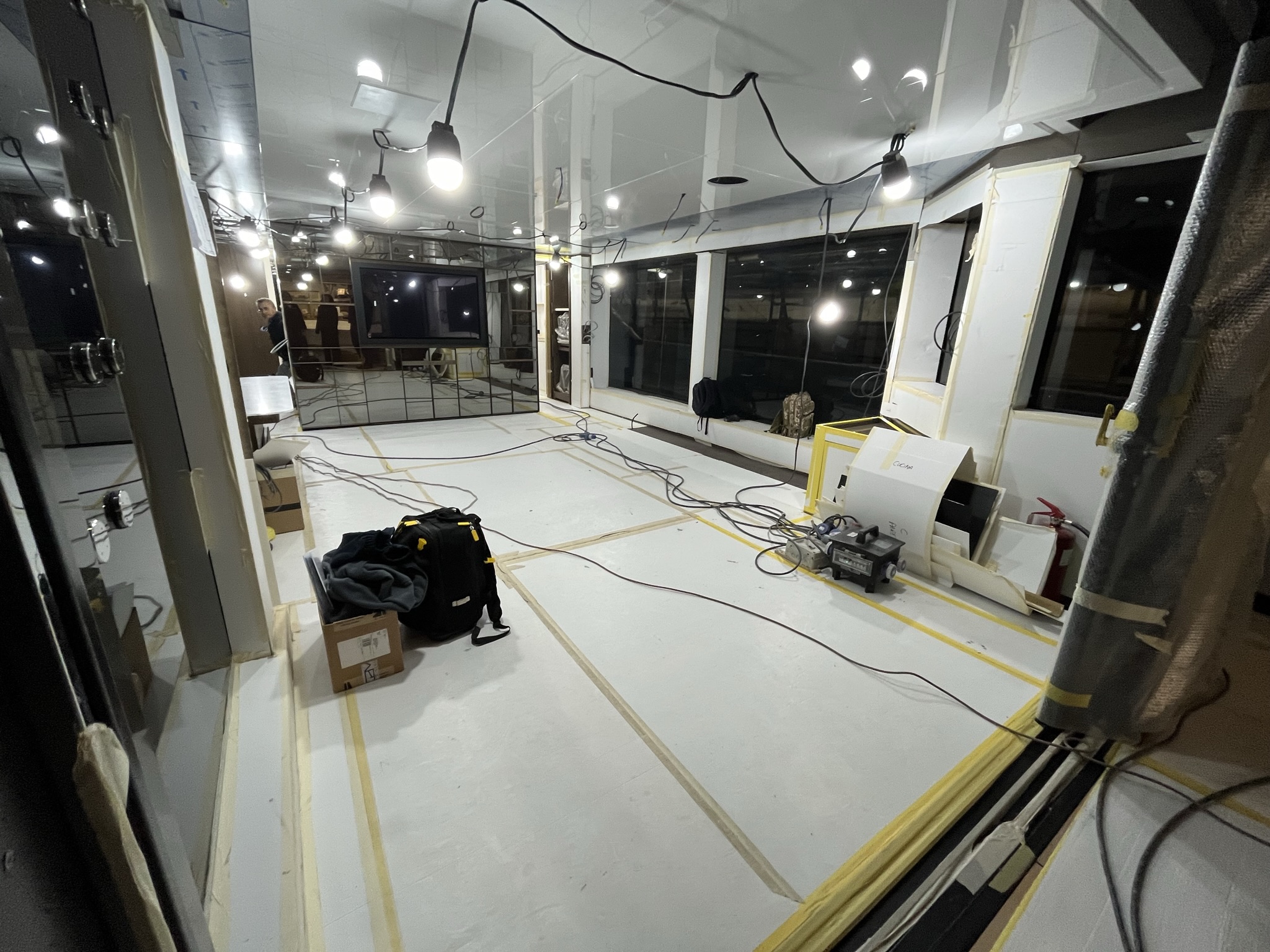

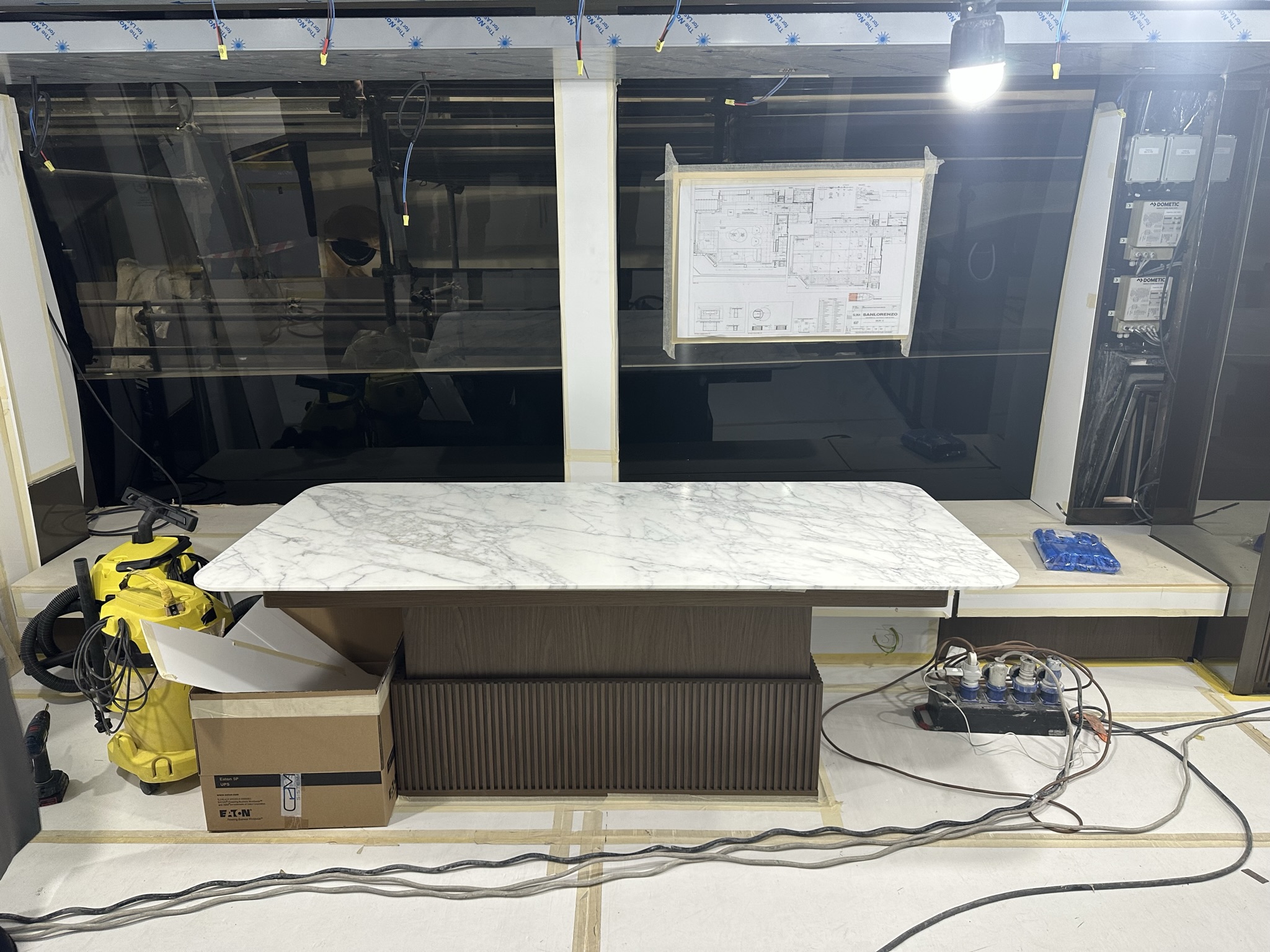

Now moving to the interior, below is the salon, well on the way, though sometimes hard to see because of the protection material. The wood floor is laid but covered in white protection, apart from one little patch on the starboard side where you can see the (dark) colour
The stbd side of the salon will have sofas and along the port side there is this long window seat. The table is on an electric hi-lo mechanism and also slides athwartships a bit

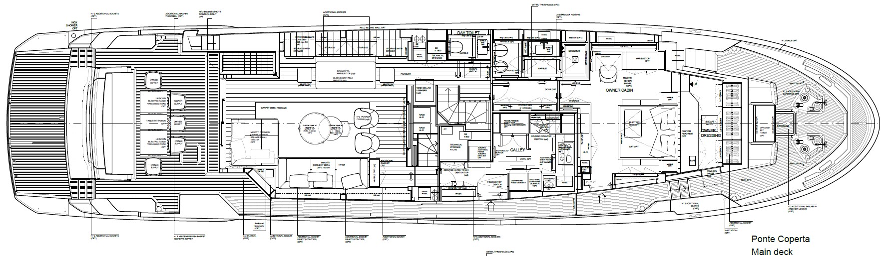

Reminder of layout:

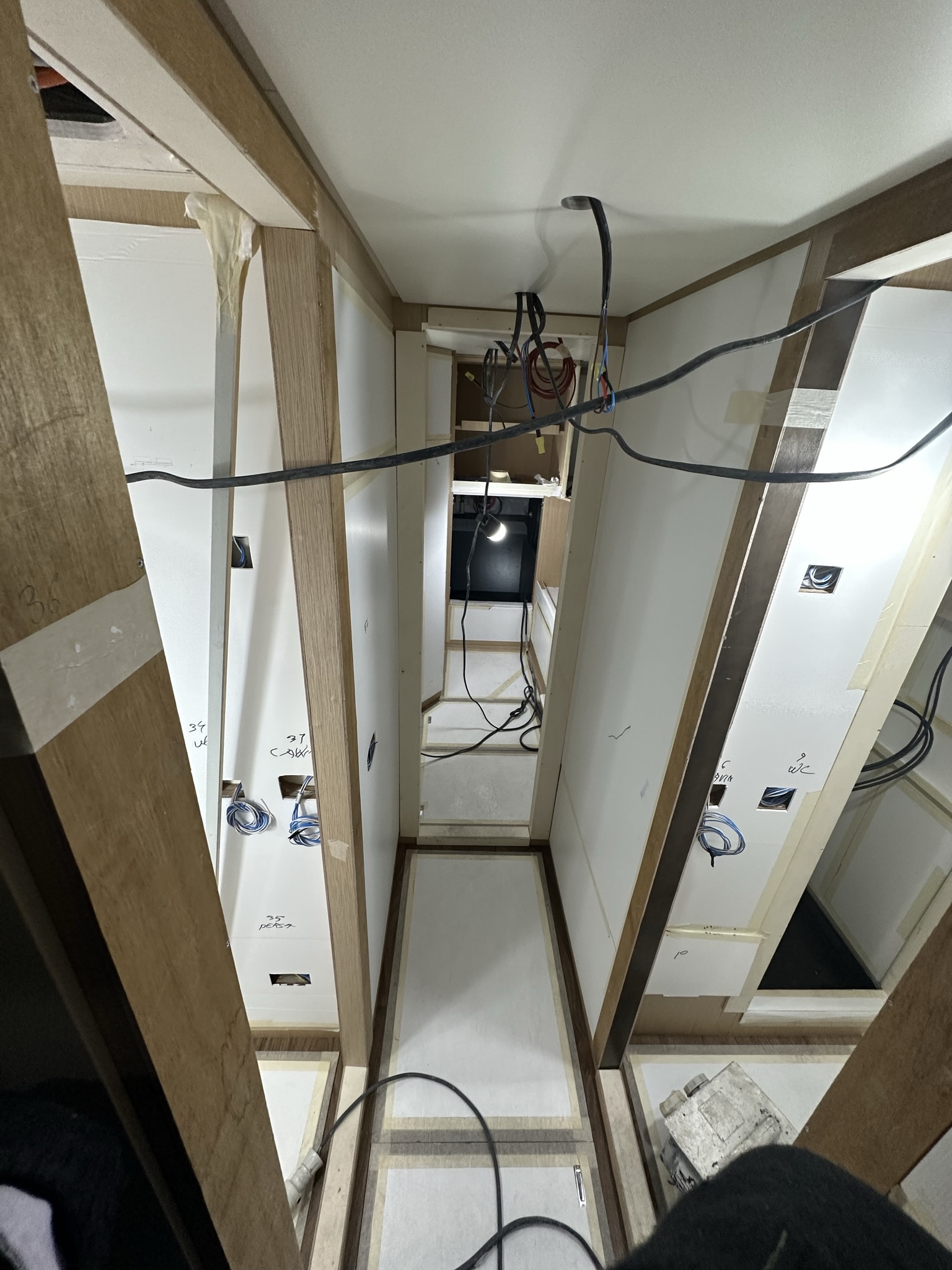

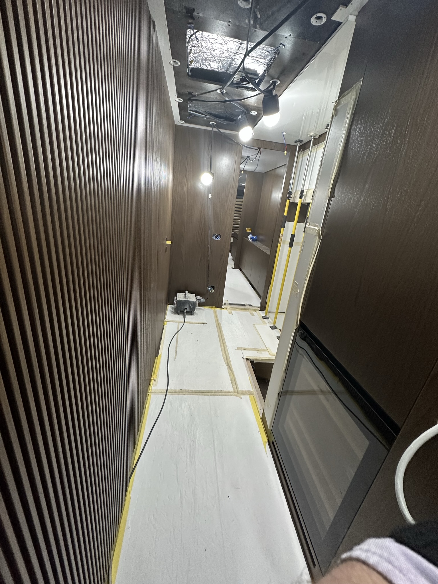

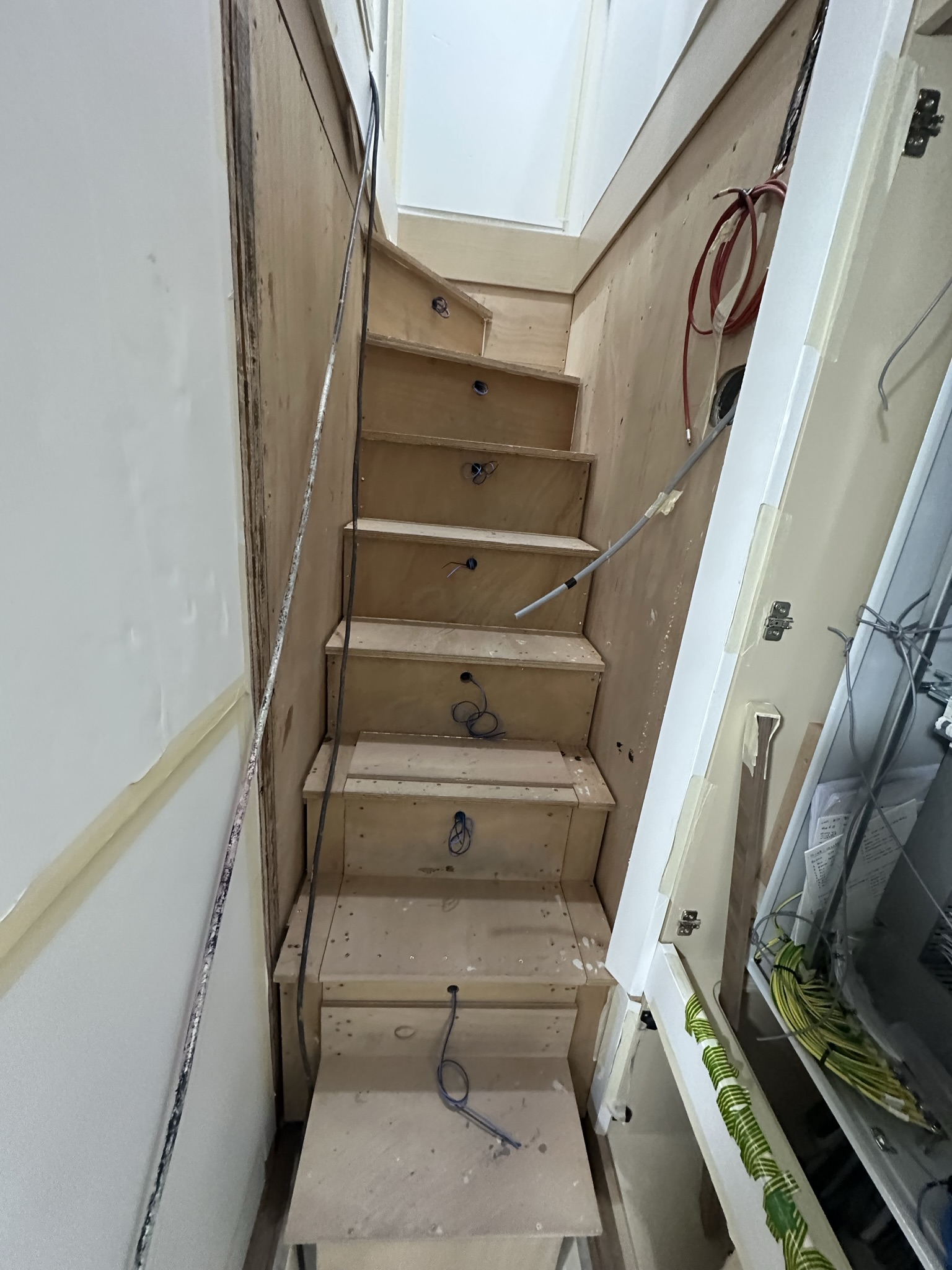

Now moving to salon port side forward, and the corridor that takes you to day head, guest staircase and owner cabin:

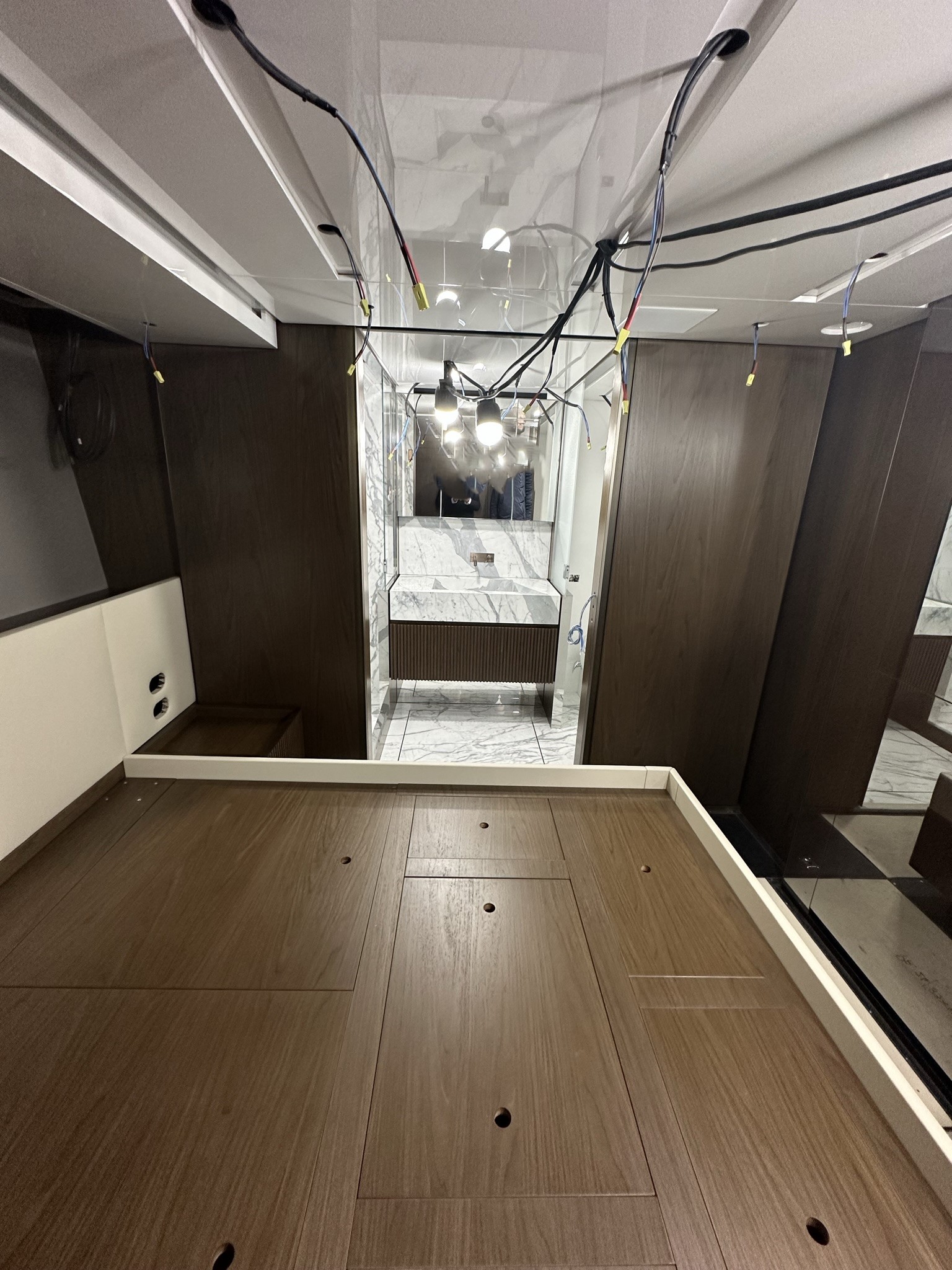

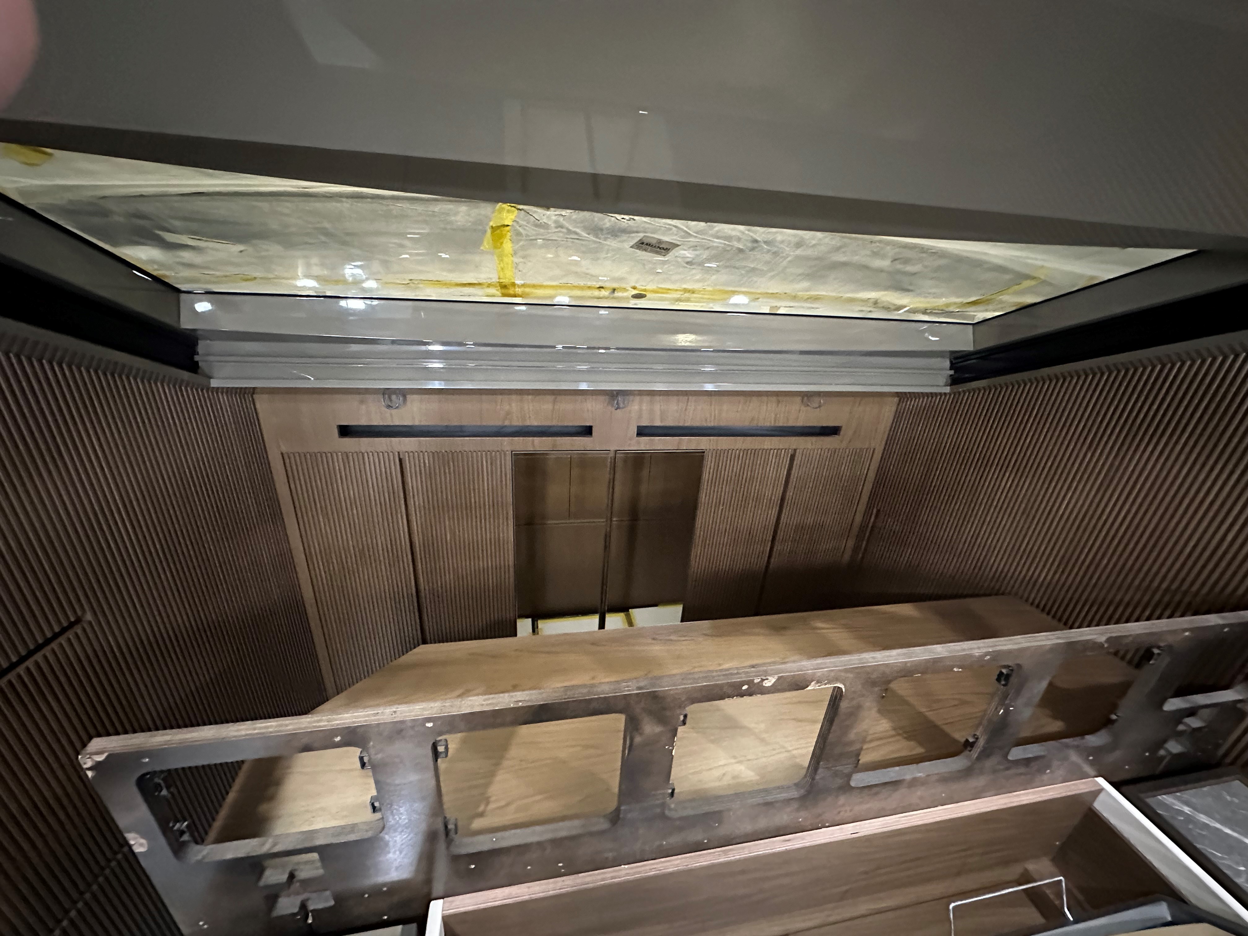

Then below is owner cabin looking forwards:

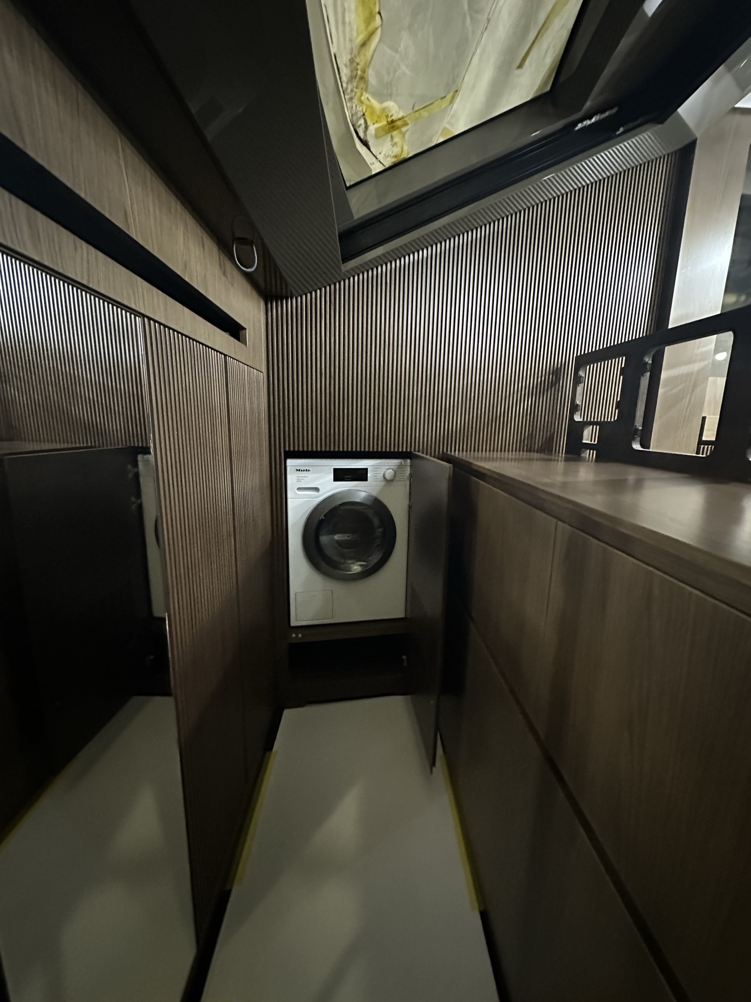

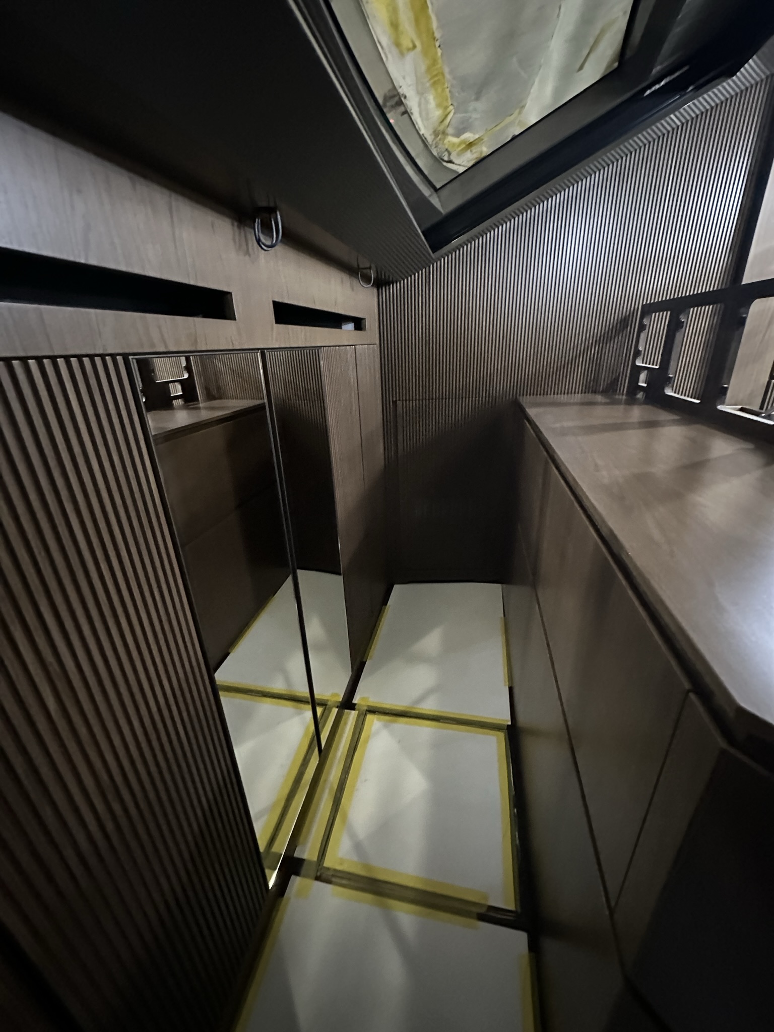

Then at the forward end of owner cabin looking down into the dressing area, and the dressing area itself (where, as yo can see I added a washing machine just for this cabin so as not to need to use the crew-operatred laundry zone):

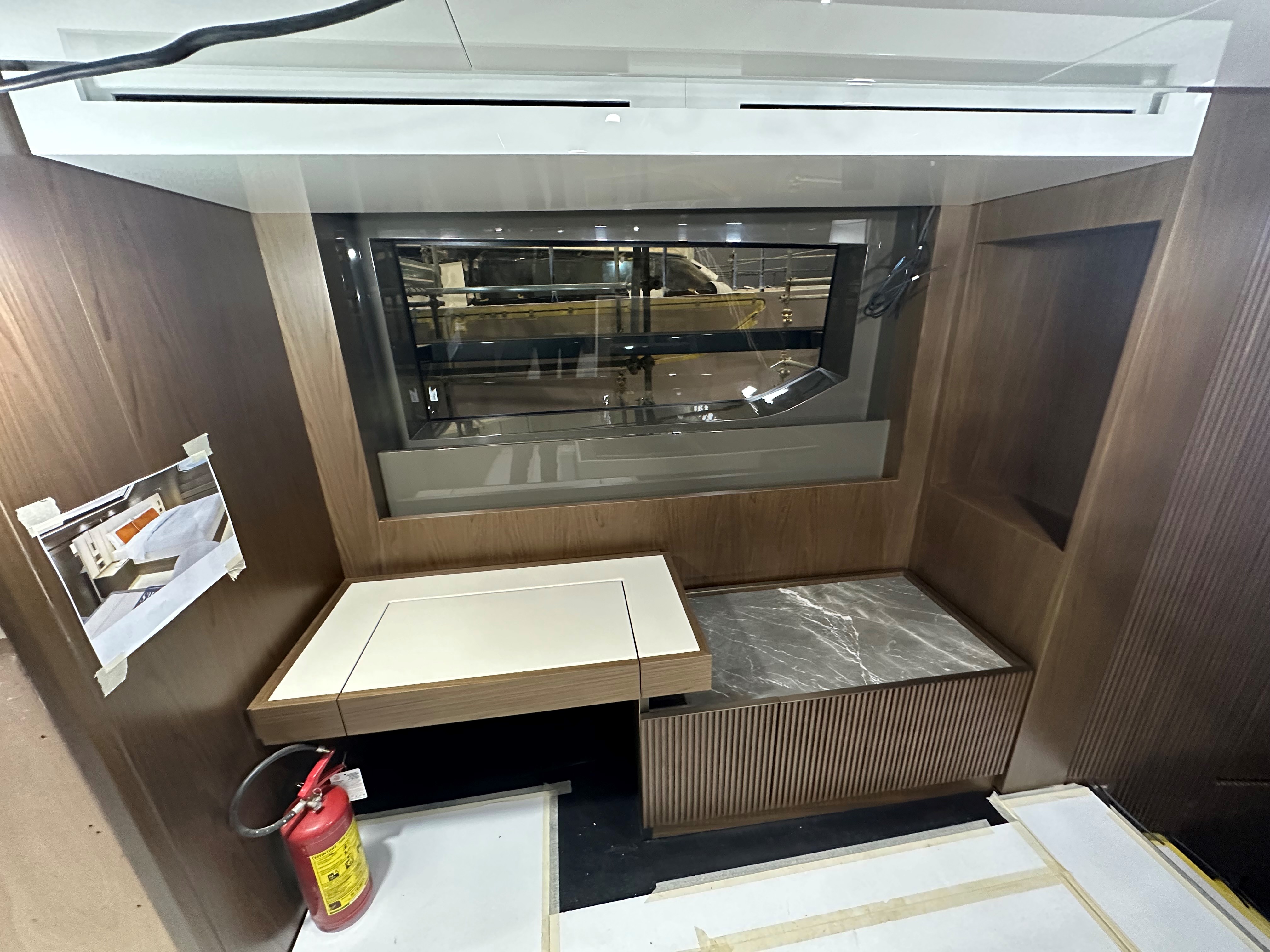

Below is the bureau to port side of owner cabin, and a close up of one of the nightstands showing the slatting, bronze framing, and marble top, all custom. There is no door handle, just an edge at the top that you can grip. There are no door knobs or handles on any cupboard in the boat

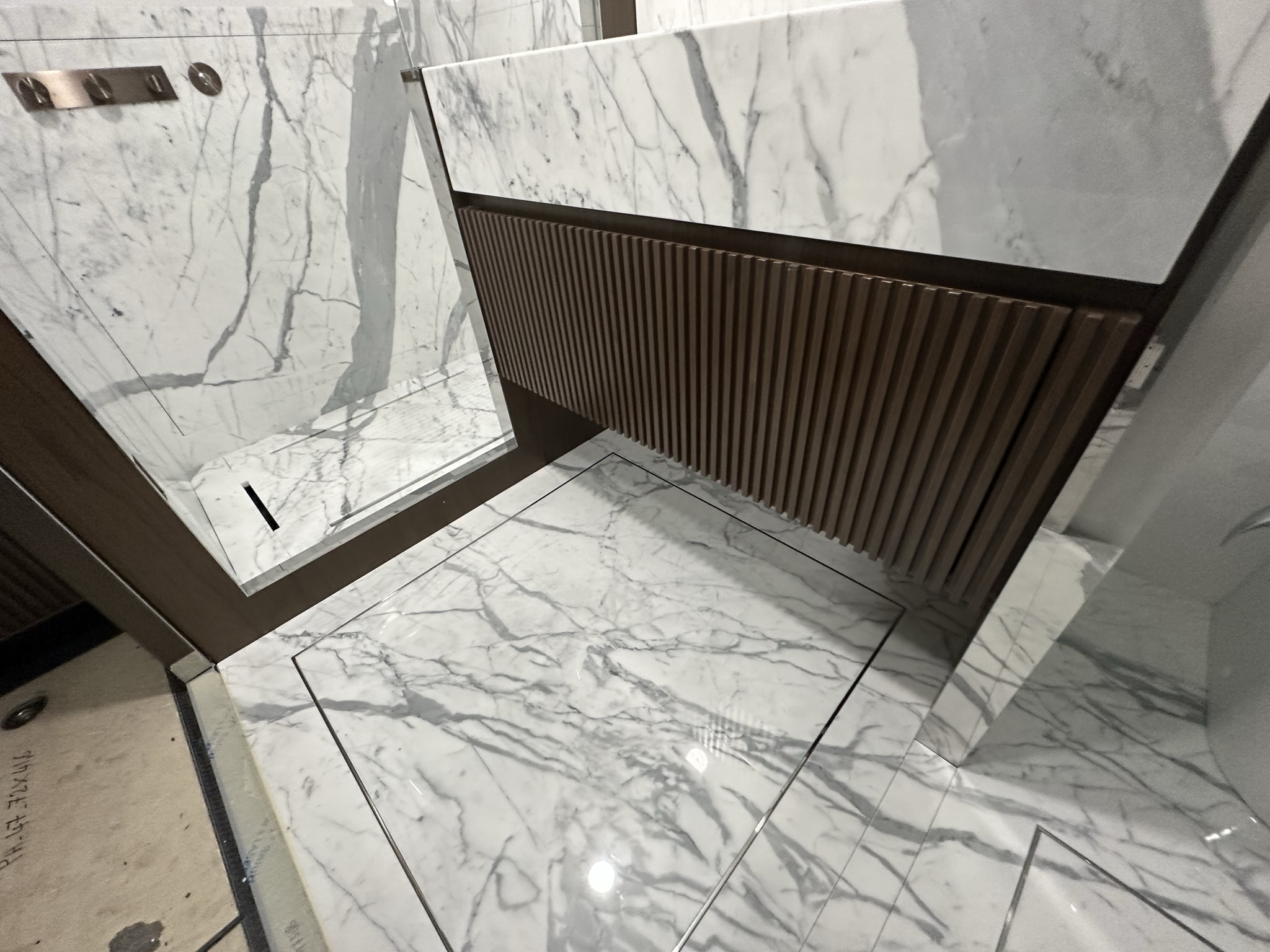

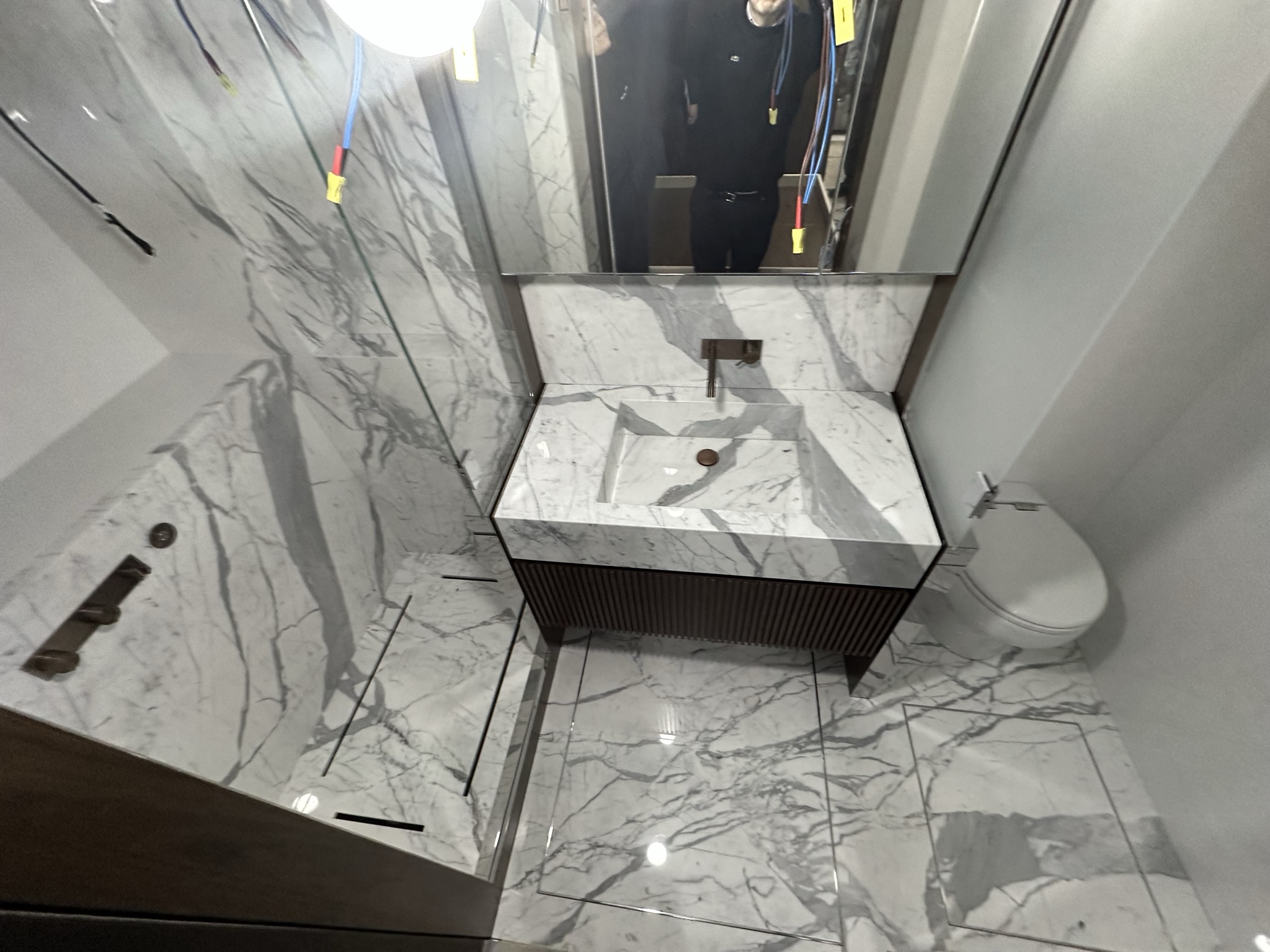

As you can maybe see in the GA, there is a lobby that you enter before getting into the owner's cabin proper, so you pass through two door before getting to the bedroom area. The bathroom is port side of this lobby (photo is looking aftwards)

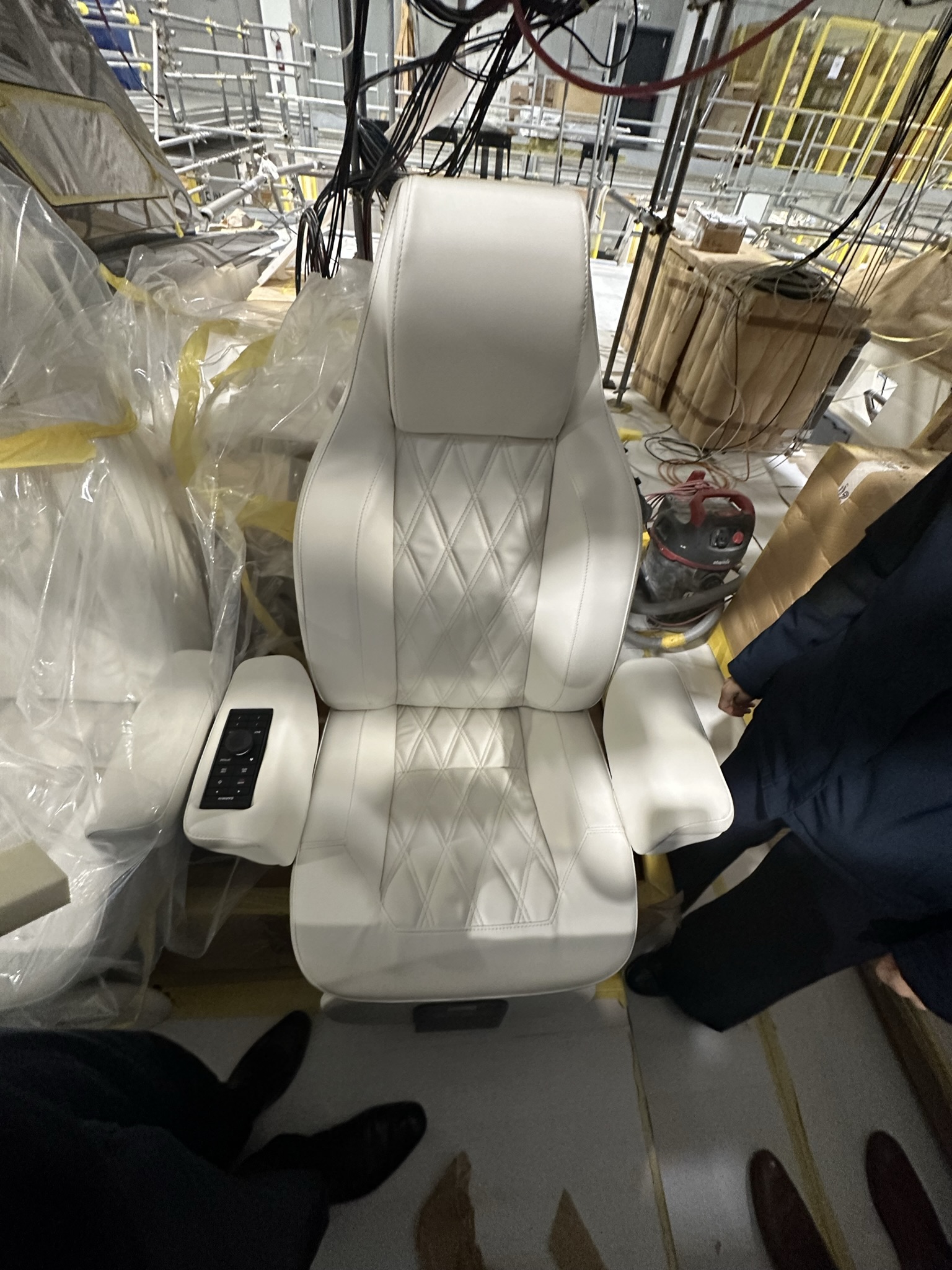

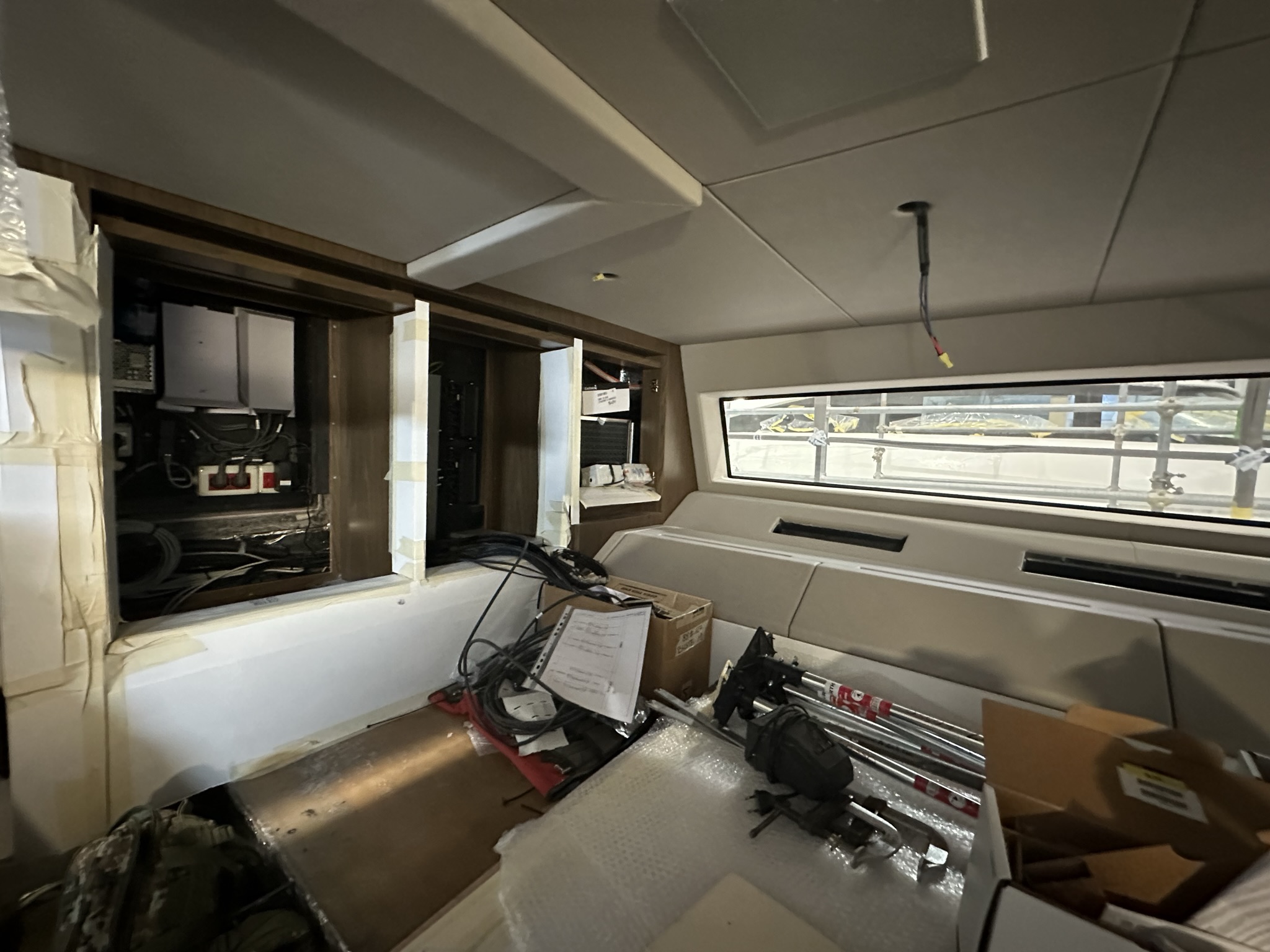

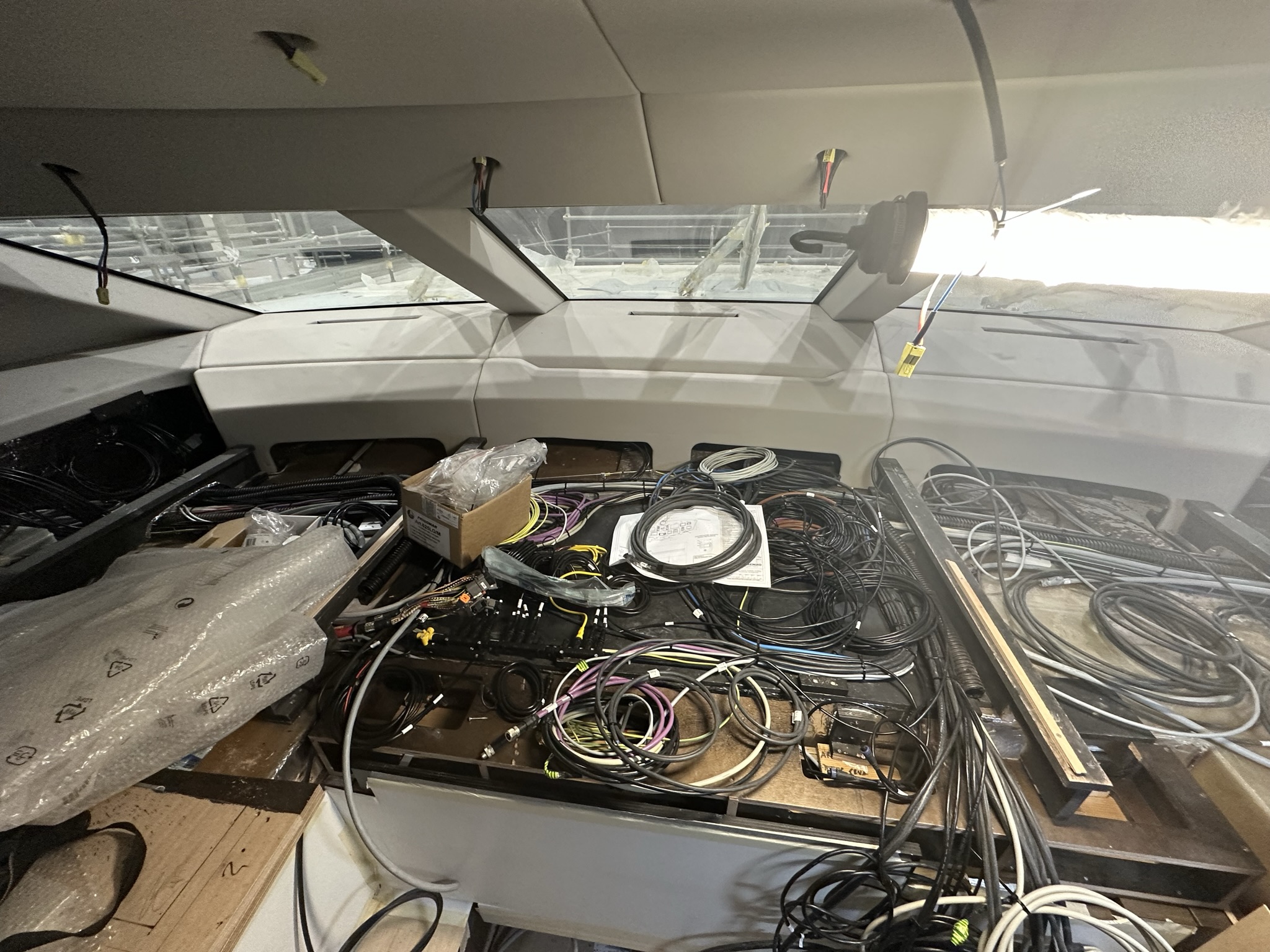

Quick look at pilothouse. Lots of work still to do and km's of wiring. I have departed from the black colour inside the pilothouse and used a light stone coloured leather.

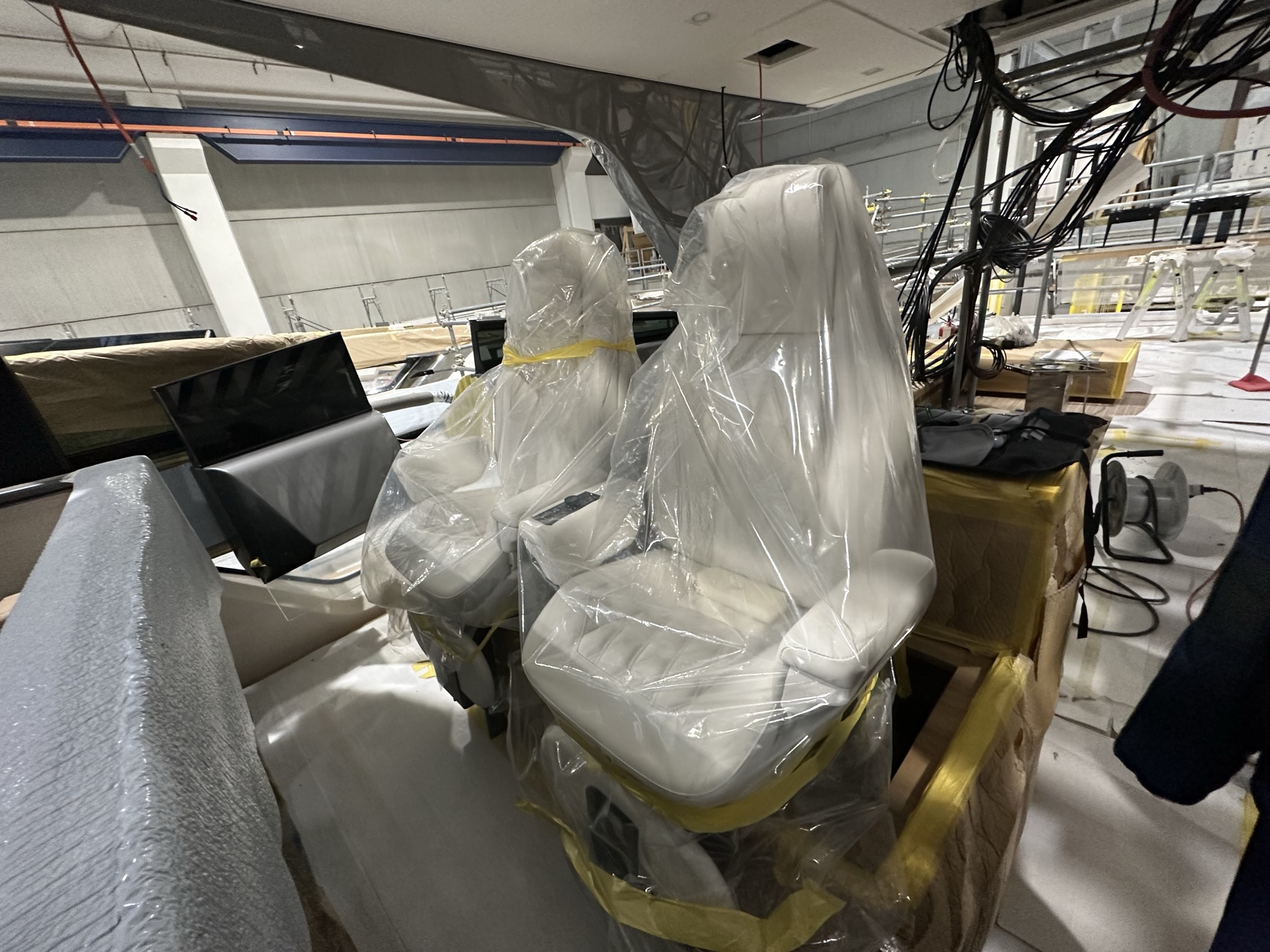

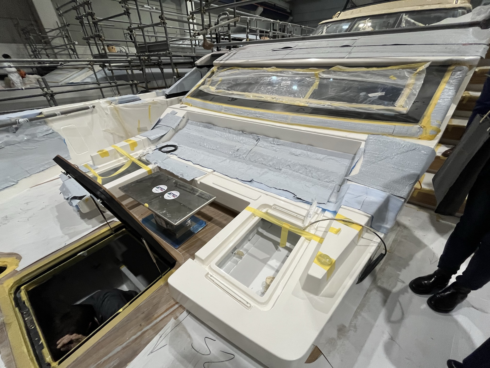

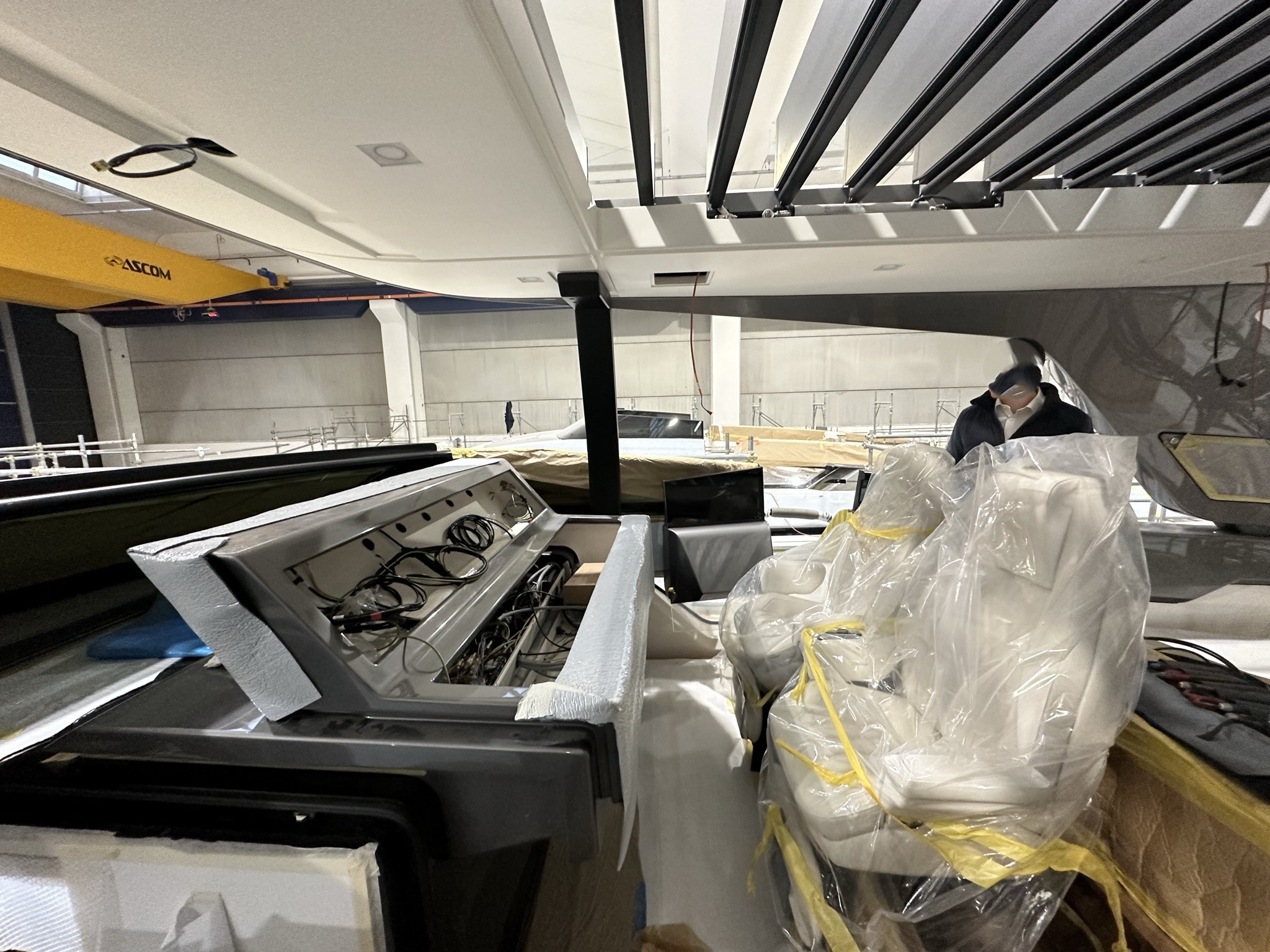

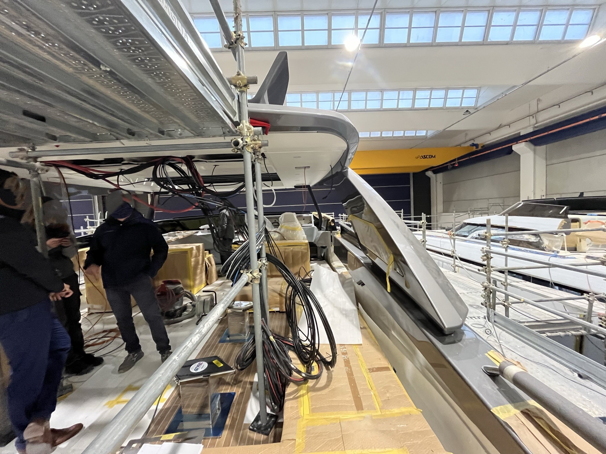

Next, a load of pics of flybridge:
This black mounting rack has been specially made to hold 5 x 22 inch Garmin screens, sort of floating:

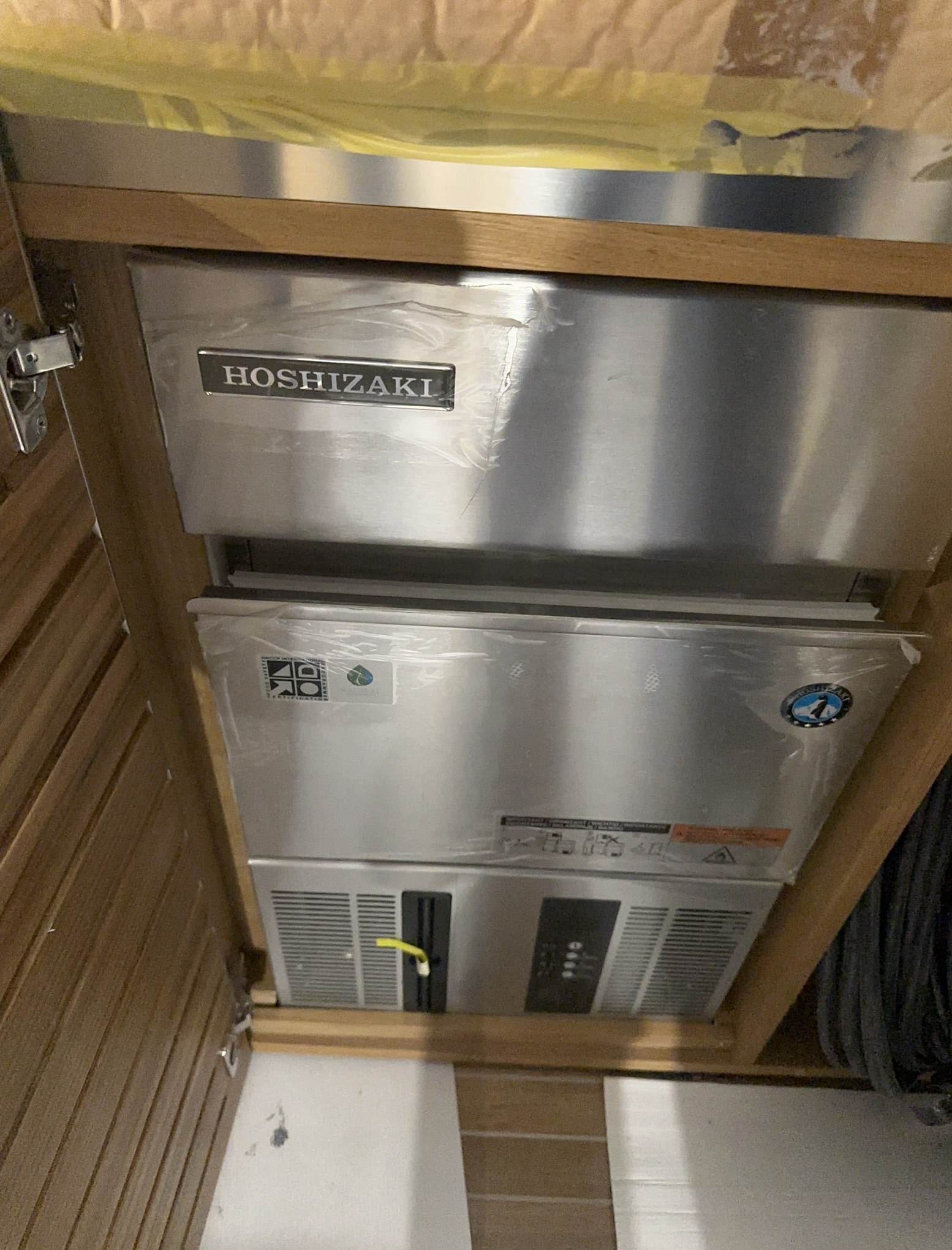

There are two Hoshizaki restaurant quality icemakers on the flybridge - I don't want to use/repair U line icemakers any more

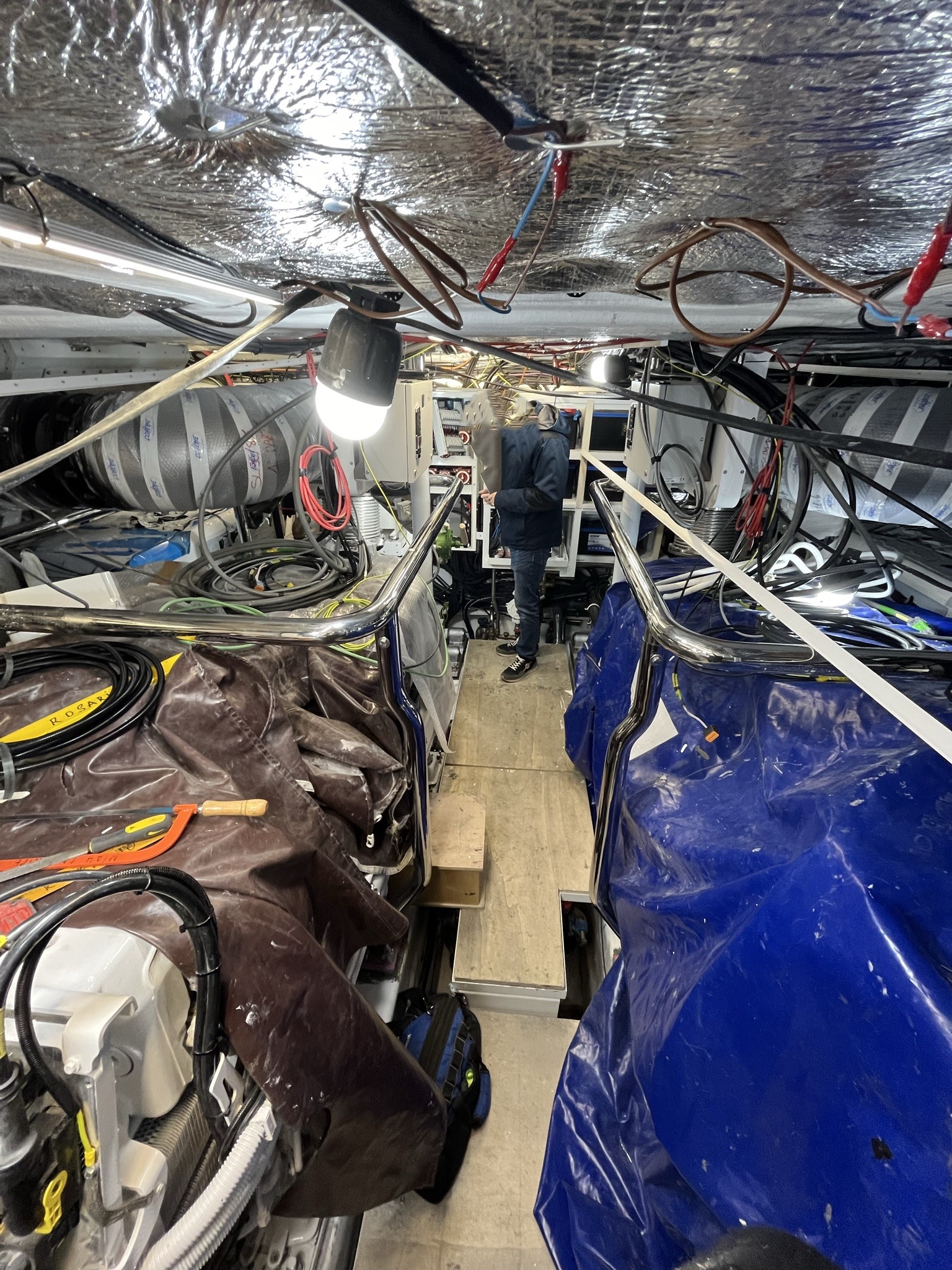

Finally, aft deck and engine room. engines are very hard to photograph because space is tight and they are covered up, so I will get better pictures later.

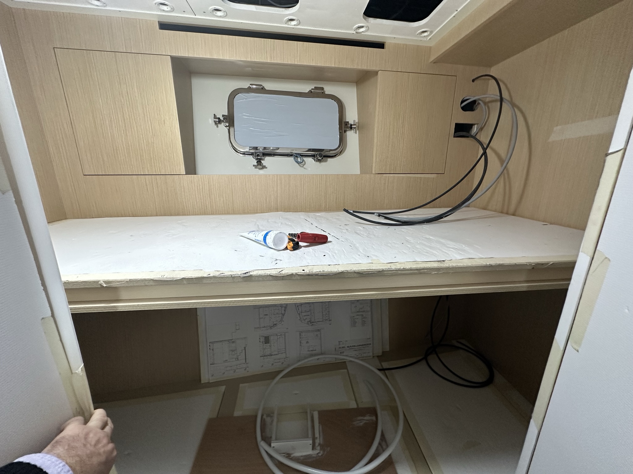

Oh, nearly forgot, a few pics of crew area. There are 3 crew cabins each with twin bunks and each with ensuite shower room. Again. all covered in white protection board - the panels are actually light oak and the floor is Amtico style darker oak:
The bow cabin, for the captain or senior crew, has turned out really nice:

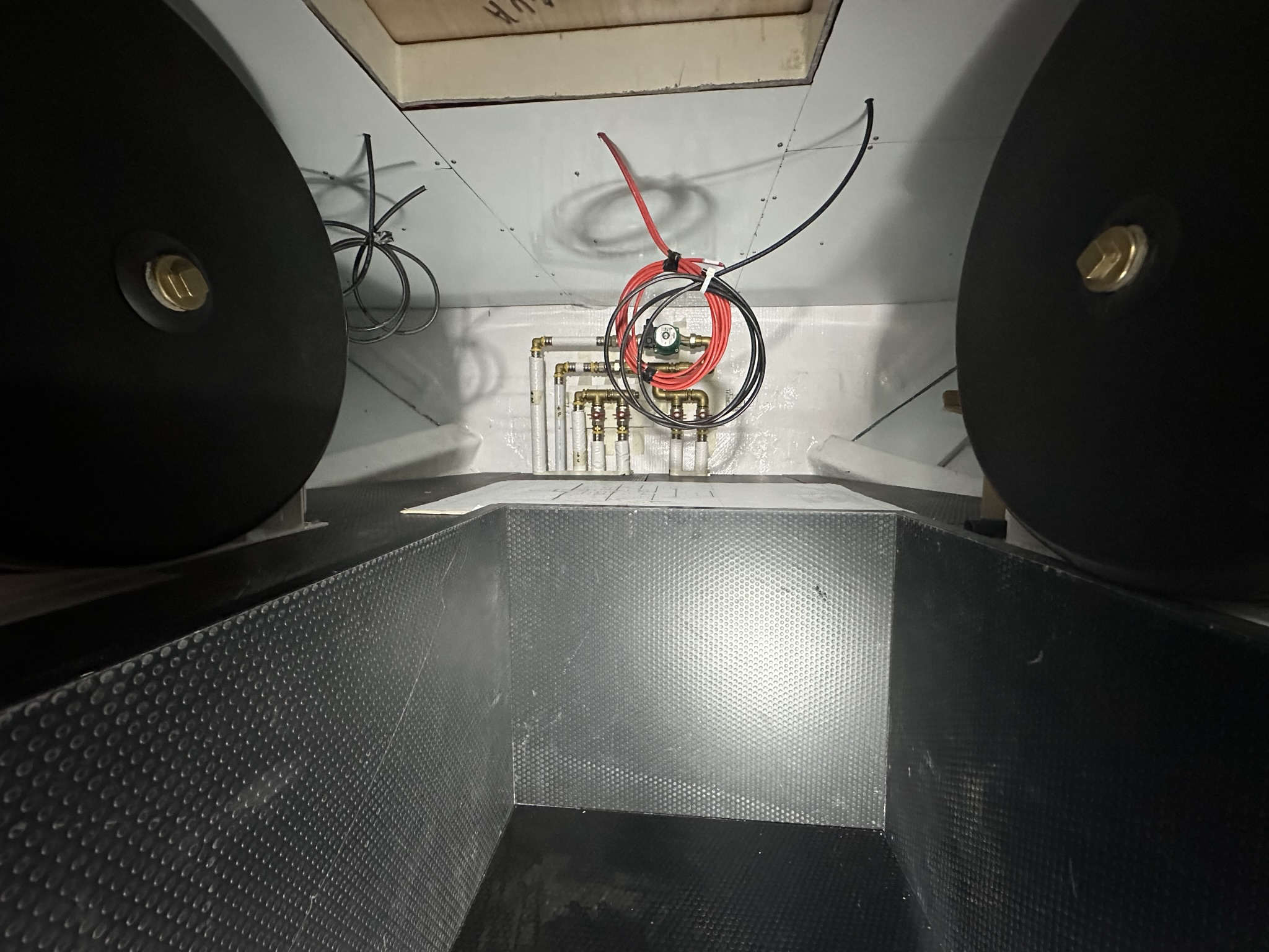

At the very front of crew zone is a storage compartment in the v of the bow. Here you can also see the hot water circulation pump and plumbing. The whole hot/cold water system is plumbed in brass fittings and manifolds, solid pipes, and crimped "hydraulic style" flexible hoses, insulated in the case of hot water pipes. There is no Hep2O type piping as you would get in a fairpinseek.
