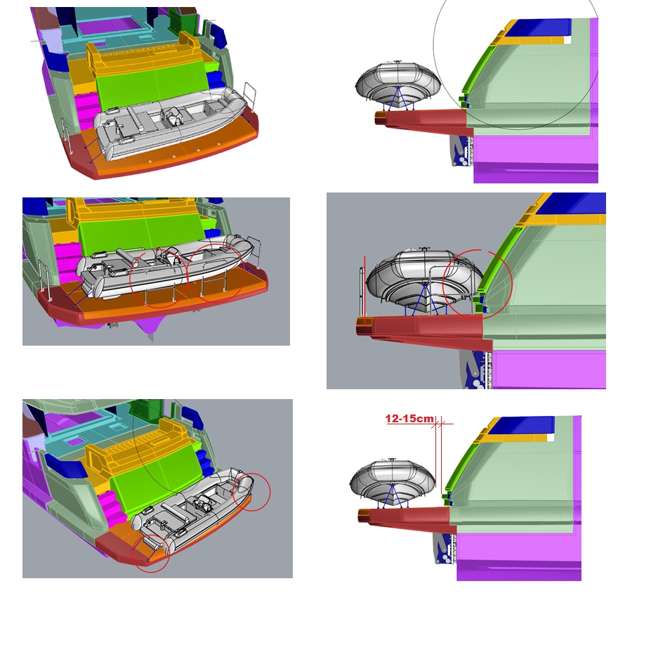

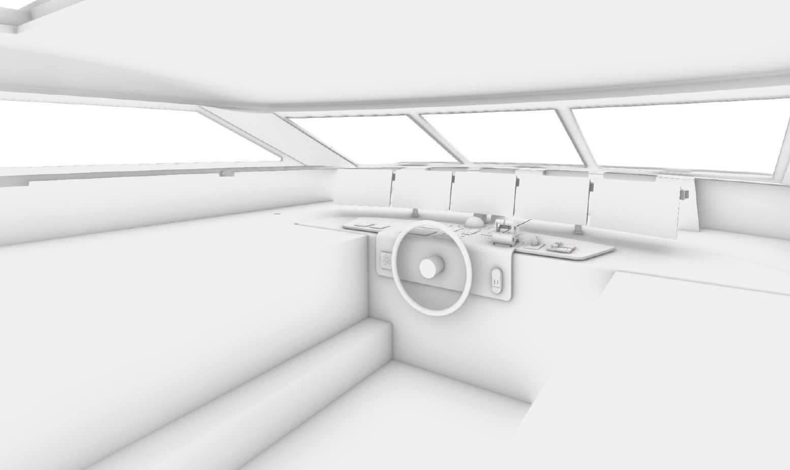

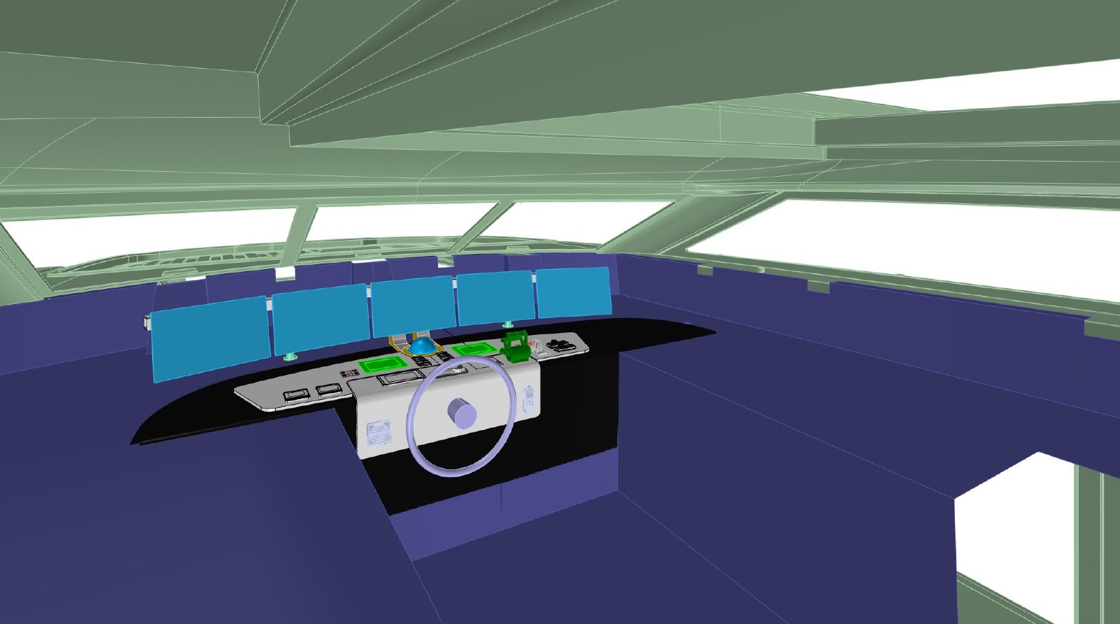

@jakew009 and anyone else who knows 3D modelling, here are a couple of examples. Would be grateful for any insights on this whole CAD design process. BTW a long time ago I did my degree in Mech Eng and worked as an engineer for a year, but that was right at the end of the 80s so it was before CAD arrived on the scene in 2D let alone 3D - I missed al that by less than 10 years and literally did hours of drawing using an actual pencil. In a nerdy way I find this whole process (3D modelling) fascinating so would be grateful for any thoughts/observations/lessons you can give
I have zillions of drawings like the one below, which is the base of the fly helm and co pilot seats. This is a fresh custom drawing for my boat, not off-the-shelf, It it 2D or 3D? The chairs are Besenzoni catalogue items so I guess Sanlorenzo have taken a 2D or 3D model of the chair provided by Besenzoni, and incorporated it into their drawing/model of the base (?)
Next below are some others - these look definitely taken from 3D models - correct? In the first picture, the blue screens are I guess 3D models from Garmin and the green screens/throttle heads are 3D models from MTU, and sanlorenzo have combined these into their own model of the pilothouse, correct? And the last picture below is to show different positions to place the tender (which normally goes inside the garage by the way) and seems to have a 3D model of the 435 williams, incorporated into Sanlorenzo's 3D model of the boat. Is that how it all works?

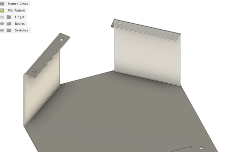

@jfm typically what now happens is the initial model is drawn as a 3D object built from a 2D sketch.
It's easier if I explain with some photos...
We start off with a sketch that may look something like this:
Then it gets 'extruded' to make it a 3D object (or in this case turned into a piece of sheet metal):

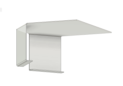

Then some flanges are added:
Then some sketches may be drawn on other faces (in this case to add some holes:
And then those sketched holes can be extruded through the 3D model:
And finally some pemnuts might be inserted into the holes to give us threaded inserts. The models of the pemnuts are downloaded from the manufacturers website (you can see the instances of them on the left hand side):

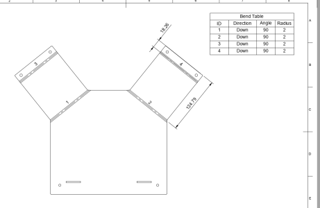

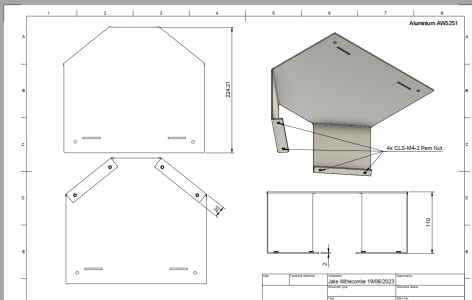

From this 3D model we can then generate a 2D manufacturing drawing which will be used on the shop floor:

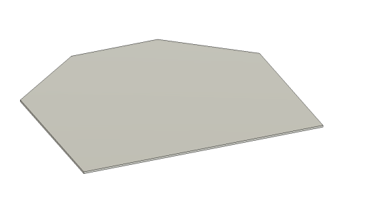

And the software can also generate the 'flat' pattern automatically. This shape can be lasered out of a piece of sheet metal and then press braked into the correct shape. The software calculates all the K factors to allow for the material deforming during bending:
If you go back to the 3D model and change anything on it, the 2D drawings will automatically update. So effectively the 3D model is the 'master'. It's known as parametric CAD.

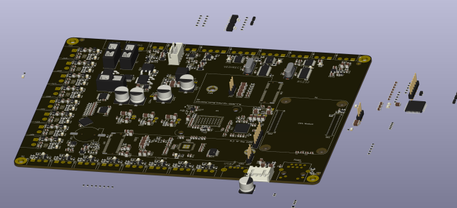

You can go down to an extreme level of detail, modelling every nut and bolt etc. It massively speeds up the development process because it's much quicker for example to try different length bolts on a computer screen than it is in real life. You can also see how things fit together so much easier by being able to position them in space and then build mounting brackets etc around them. You can also then generate the BOMs (down to every last nut and bolt) and link all that to whatever ERP / PLM (product lifecycle management) type software you are using. One of the most tricky things is tracking the revisions of things you manufacture and then being able to supply spare parts to a customer a couple of years down the line when you've moved on a few revisions. Having accurate CAD models makes it a walk in the park.

In your photos it looks as if they have a very complex model that they have 'simplified' whilst they are only working on some parts of it. When the model gets enormous it starts to become slow to work with because there are so many individual components. I imagine there is 10s of man years of work to model a yacht like that.

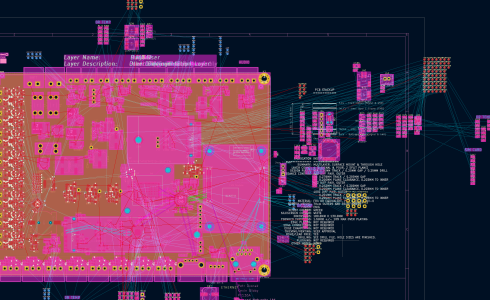

And from that it generates something like this. Every single little line is a 'wire' that you have to carefully route without it getting in the way of another wire. It's bad enough on a PCB where really the wires only go in two directions. I can't imagine trying to do it on a 100ft yacht :D
And finally it can generate a 3D model which you could import into your mechanical CAD software:
