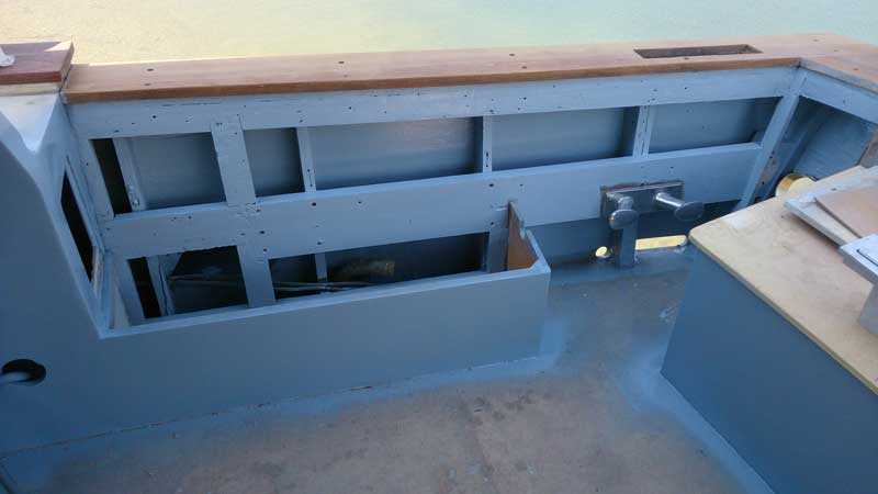

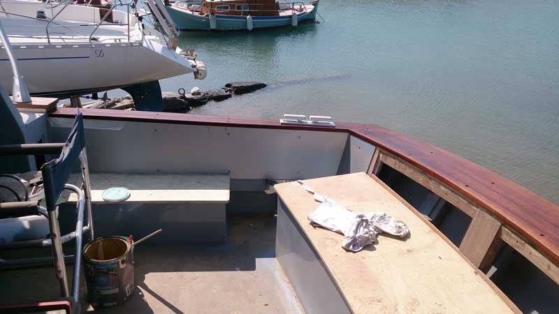

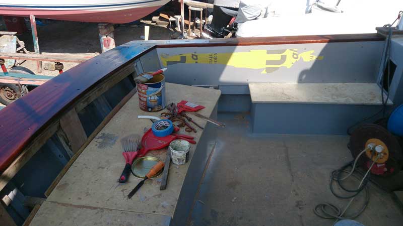

Right, one of the small things that had to be done was sorting out and finishing with the aft deck lining. That includes the side panels along the steps to the bow and the lining over the aft seating. I'd noticed that when I put them together a year or so ago, there was water dripping down the lazarette from the capping-iroko frame to the ali sandwich panel. So this time, after properly painting all the inside, I used some relatively crappy clear silicone I found lying around to seal the panels. Idea being I don't want too good adhesion as I wont be able to remove the panels without damaging them at a later date. And I'm not so keen on redoing these panels anytime soon!
Obviously, before fitting the panels back I had to sand (up to 180iirc) the iroko capping and get it 5-6 coats of Owatrol (part 1)
And now a series of unrelated jobs that are worth mentioning for one reason or another.

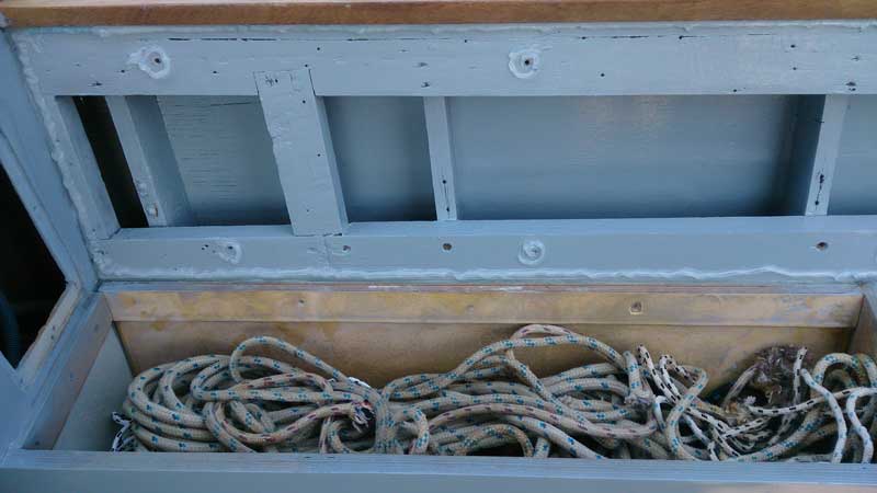

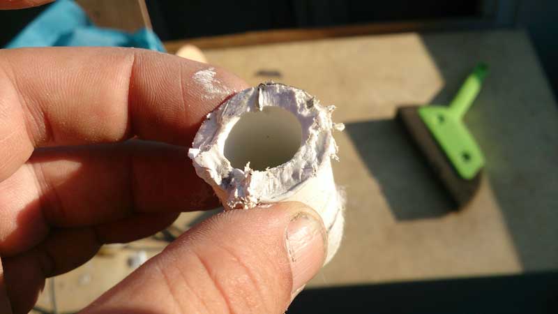

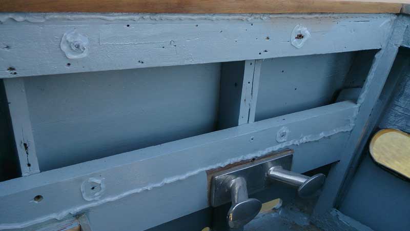

At some point I had to remove a truedesign grp skin fitting (cause I was stupid and tried to tighten it before the sika 291 (iirc) had properly set. So it turned, and I wasn't happy.
Removing a skin fitting is easier said than done, as I couldn't have a decent grip underneath there's a couple of tiny recesses where you're meant to use a custom key (nicely coloured flat grp piece tbh) which wasn't enough, so decided to cut it off with a chisel. Didn't want to use an angle grinder mainly because my cutting disk was so small that I'd not have any luck without messing the hull around. Anyway, ten minutes later and after a lot of sweating (and a fair amount of swearing) I cut it off. Here's the piece. My verdict is that there's no fcking way in hell that this would break if I'd step on it even hit it with a sledgehammer. If someone is thinking going grp (to avoid dezincification, bonding or whatever else) I think it's absolutely safe.

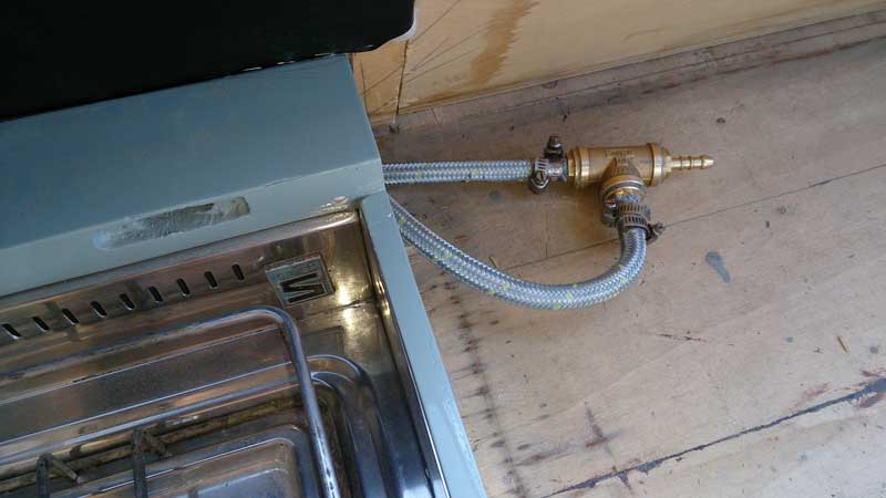

MiToS had originally a 6-7mm copper pipe going from the locker/seat on the f/b around through the ceiling slats to the galley. Not a great distance, but wasn't happy to have an almost 40yo pipe especially as I was told that it's not legal to use hard copper pipe on petrogaz/camping gaz whatever you want to call them. So Got 7-8m of proper rubber pipe with ss wire sheathing suitable accessories for the oven and hob and a tee to join them all together. Not hard, just time consuming. So now, gas bottle is at the f/b on the 600X600X250 box on the stbrd side of the seating bench and all that comes nice and round to the two appliances. Hob works, we cooked a couple of times and made a few espressos, oven I haven't tried it yet, have too hairy hands to get a small lighter in there trying to see how to lit the thing. Got to get one of these flexhose lighter thingies for that.

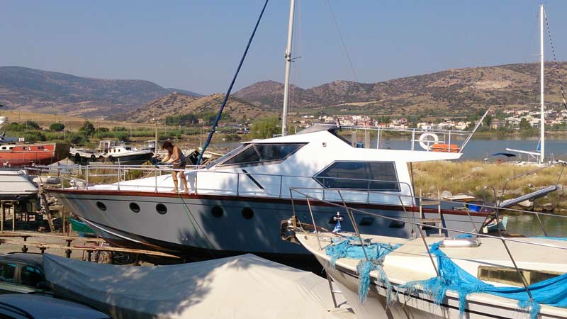

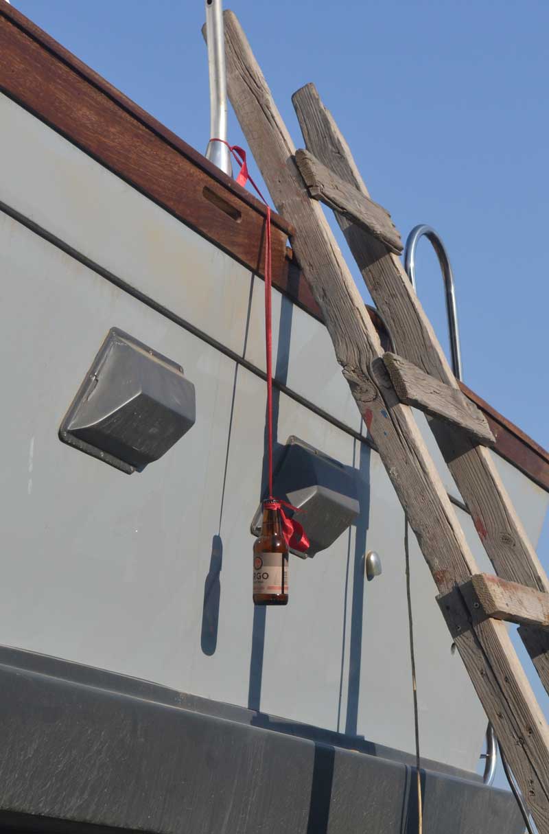

A good friend, work colleague and avid follower of the rebuilt (must be the one that paid more visits than anyone else - bar the ones that had boats in the yard that is...) came with a small beer bottle tied up with a nice red cloth tape thing. Explained that due to recession he couldn't afford to offer a champagne, but he could do a bottle of nice ale from a local microbrewery. Definitely recommended to anyone visiting the area. Beer called Argo (from the Jason and the Argonauts story) and is produced two blocks away from my house.
Looked rather funny, so left it there. This caused two different discussions:
One with the boatyard owner, who's actually using the launching slip as a private beach for him and the family and who asked me not to break the bottle just in front of the slip in order not to have accidents (with him or the kids stepping on broken glass)
Second, Alekos came very anxious and really worried one day to warn me that if I hit this bottle on the side of the hull i'm definitely going to mark it and asked me politely not to do it
I explained to both that I'm not planning to do anything silly indeed the bottle is still hanging (only inside in the aftdeck to port) and I need an occasion to drink it :D

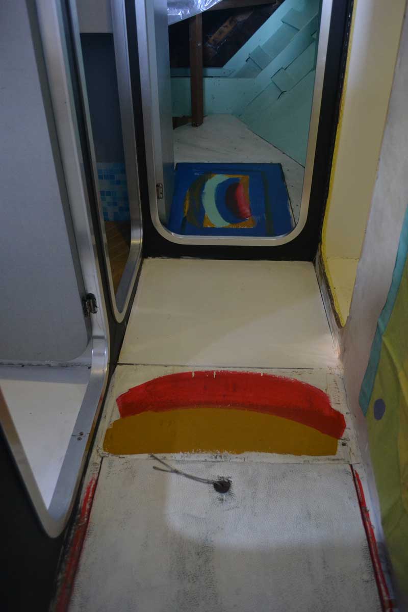

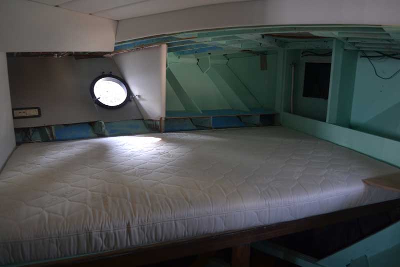

Enough with all that, now, wife following the realisation that MiToS IS actually going to get in the water (she never believed any of my predictions-I don't blame her!), decided that she had to come and actually help and contribute to the project. Needless to say that she rarely appeared when it was all dusty, dirty and messy, but now she was keen to come and help. After some much needed help in cleaning and tidying up the place, I explained that noway in hell was I going to fit carpets right now (for various reasons one being I'm not fond of carpets...) So she decided to come and paint at will (floor and bare hull inner areas) obviously without even noticing what I was explaining regarding missing panels, or panels and furniture that would cover up what she was planning to paint. So I let her loose (literally) and the following pics show the end result. Looks interesting, vibrant and matches nicely with the whole theme, some will stay, others will be covered once various missing panels are put in place.

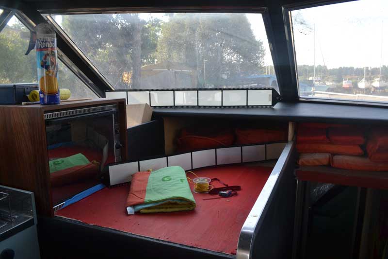

Original plan was to lay cedar on the cabin floors a la teak with TDS seams at al. Maybe I can skip that for a year or two and relax a bit whilst thinking various detailing jobs I want to attend (and catching up on real job)

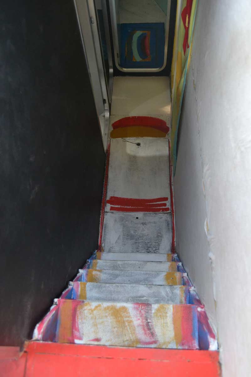

some of her artwork will be covered...

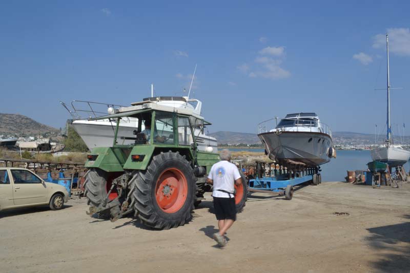

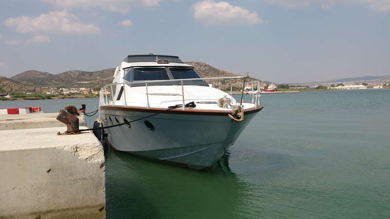

Time for the launching update (albeit a month and a half after the actual happening!)
OK, so after a series of delays, date was set for the last day of summer, so effectively kept my promise that MiToS would be in the water during the summer :p

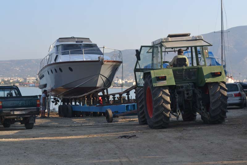

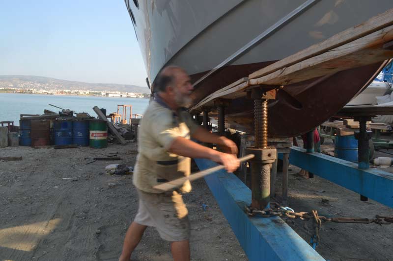

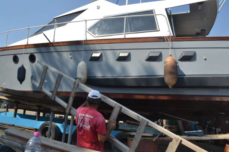

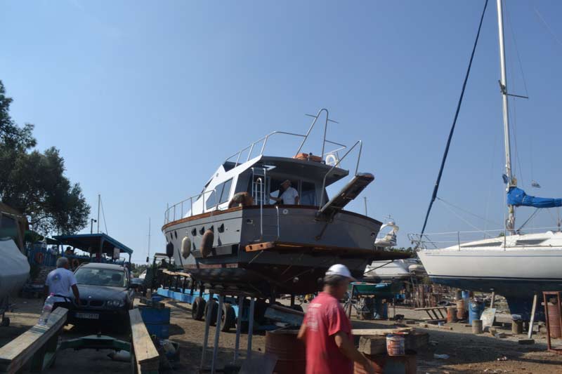

Launching starts with the trailer coming under the boat, secured, checked, main keel supports removed together with the two massive aft supports.
father and son discussing it:
Gregory sorting out the loads on the hull:
Anna doing the final cleaning up there:
me being rather stressed and exhausted (no, don't remember what she told me to piss me off...)
big moment, staircase gone, me and Dimitris (the next boat neighbour with the P45) onboard getting ready:

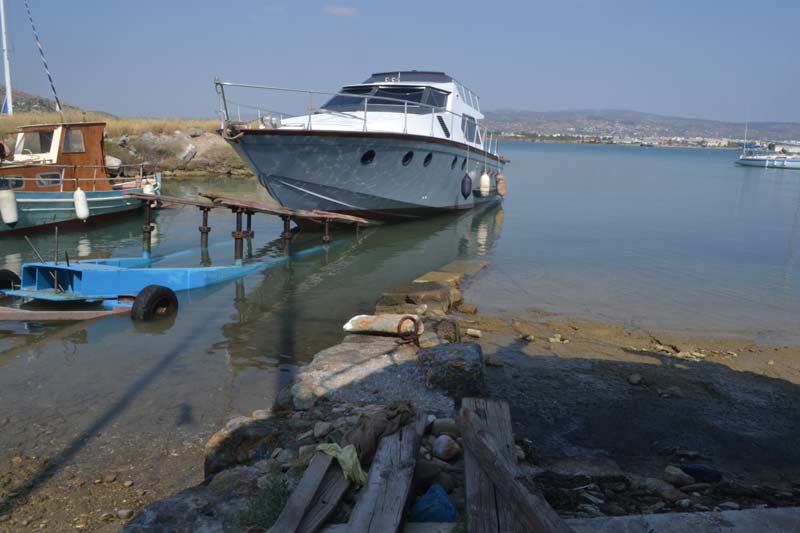

have to travel almost the length of the boatyard to be able to sort the direction and get us in the slip:
yep, she's in!

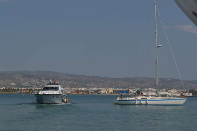

started engines, back out slowly as there was another sailing boat waiting to be pulled out, everything went smoothly:
pushing the levers a bit more, and realising that the port controls are rather stiff when the engine is running and in gear. Was fine on the hard and engine switched off...

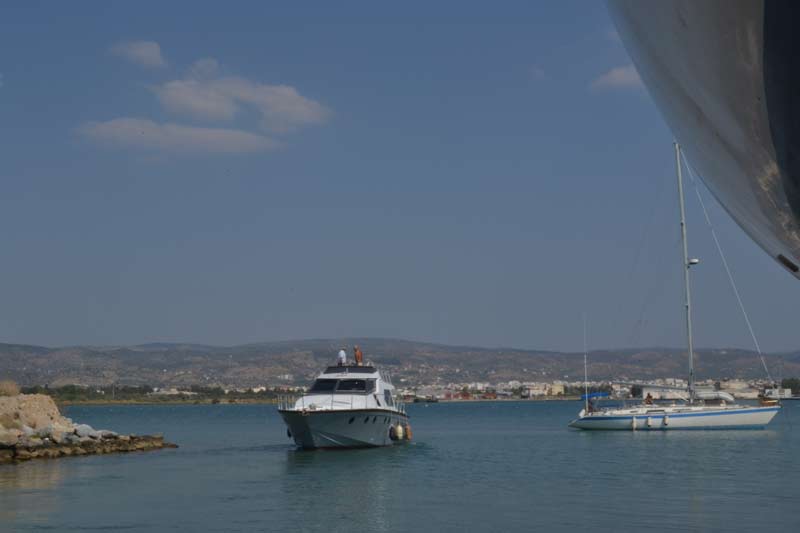

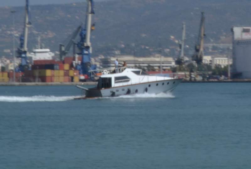

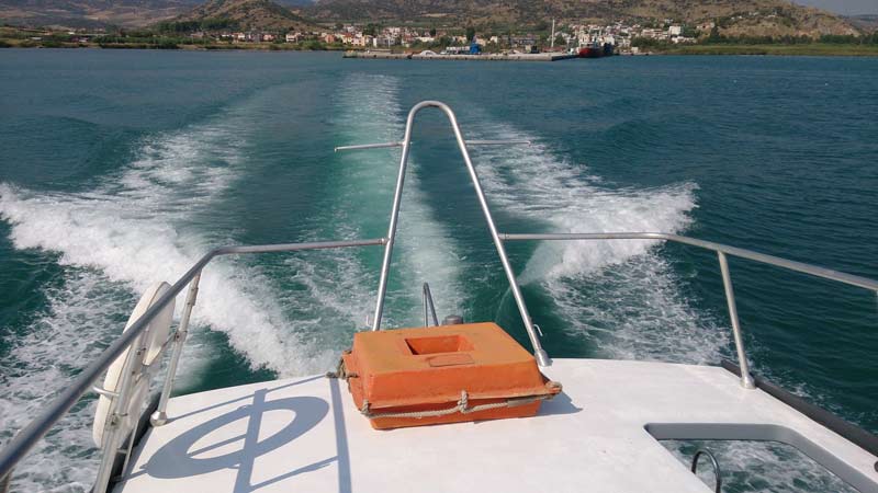

First time she's getting on the plane after almost 5yrs. Very effortlessly, Dimitris, used with his much heavier boat with twin 450 or so CATs was very impressed with the ease she reacts to throttle and relaxed maner that she gets up on the plane. Crappy pic from the yard with us shooting off the port for the first test drive:
and the compulsory wake shot, not very good, got much better now from the aft deck:
10mins later back to the dock next to the boatyard for mooring assessing the situation and checking things:
Three problems identified on this short blast:
Oil leak from the port engine oil heat exchanger, fixed by tightening a screw on one of the endcaps. Still not sure what this screw does, just a blanking one for some odd reason. Probably lost 200ml, messy job to clean out of the freshly painted bilges.
water leaks from a couple of spots, easy to sort with tightening circlips.
leaking stbrd stuffing box. Took sometime to fix, eventually had to add another line of material (had already added one line on each before launching)
So relaxed, had a beer with a couple of friends and then started sorting out bits. By the afternoon and having sorted the water leak, I realised there was some other leak. Murphy's law application meant that it was in the most awful and inaccesible place of all the engine room; under the genny, could hardly see the place and could only fit one hand at a time. That's where I had removed a skin fitting and blanked the hole. All done the proper way (as applied in a few other spots before...) with a big 15mm ply reinforcement inside, bolted through lots of epoxy, etc. Spend a couple of hours in the evening to no avail and reluctantly arrange with Gregory to pull out next morning, sort out the leak and be back in the water the morning after. All that by just pulling the boat up the ramp and leaving her there on the trolley.
