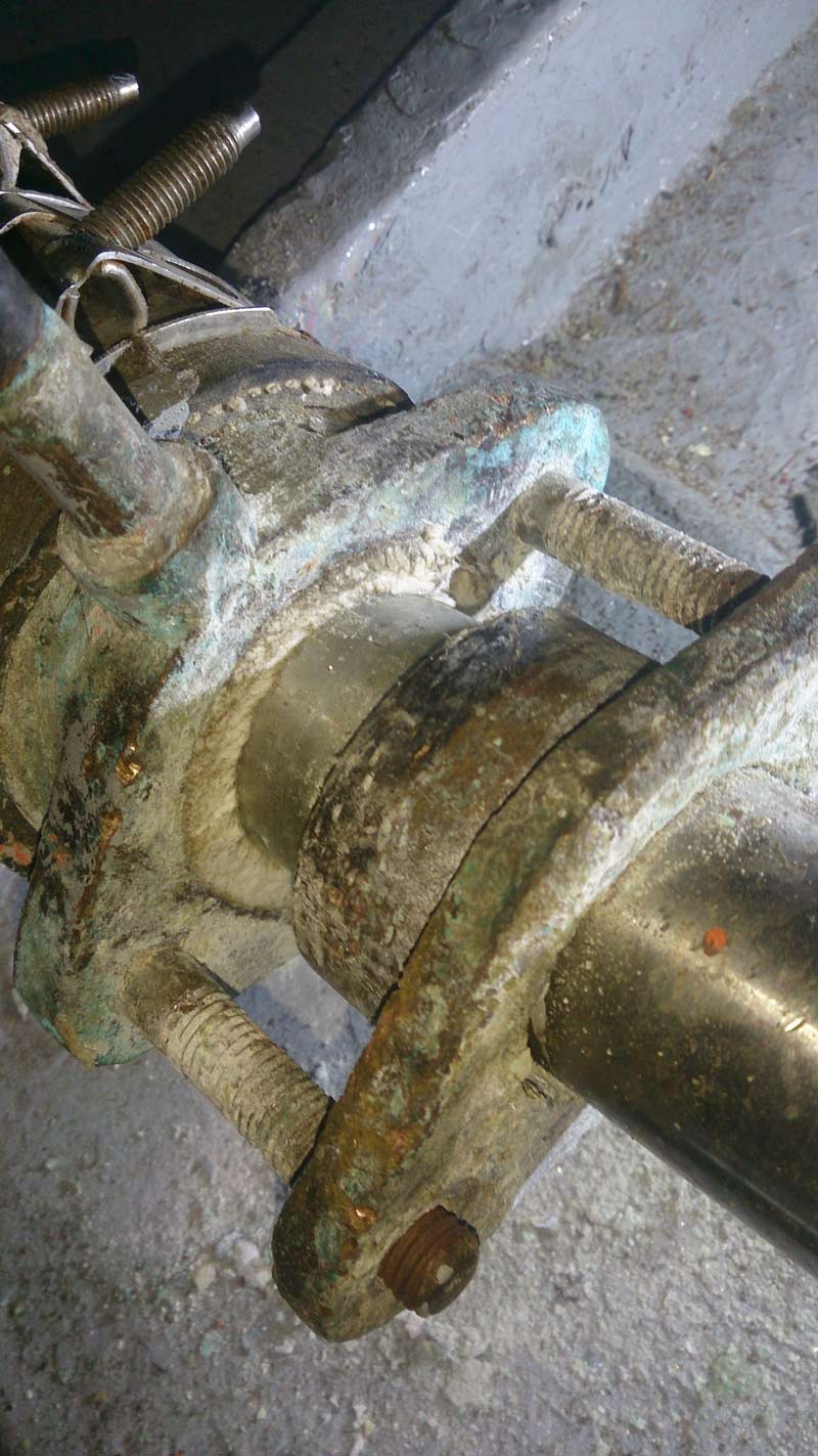

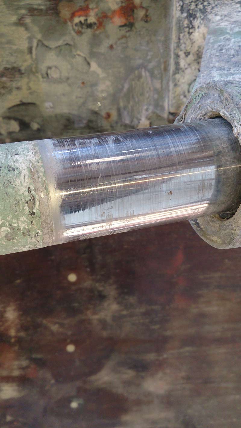

so, continuing with the rebuilt, next task (an easy one for a change!) was undoing one shaft from the g/b and pulling it back so that the state of the ss shaft is established and photographed as a record. A new compulsory test for issuing a new certificate for the boat. Easily done, a few pics of the P bracket bush area without even wiping it clean. Shaft looks ok according to the naval architect and the boatyard owner who checked it. I'm not to disagree, so job done:

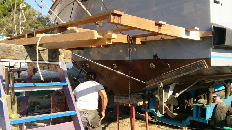

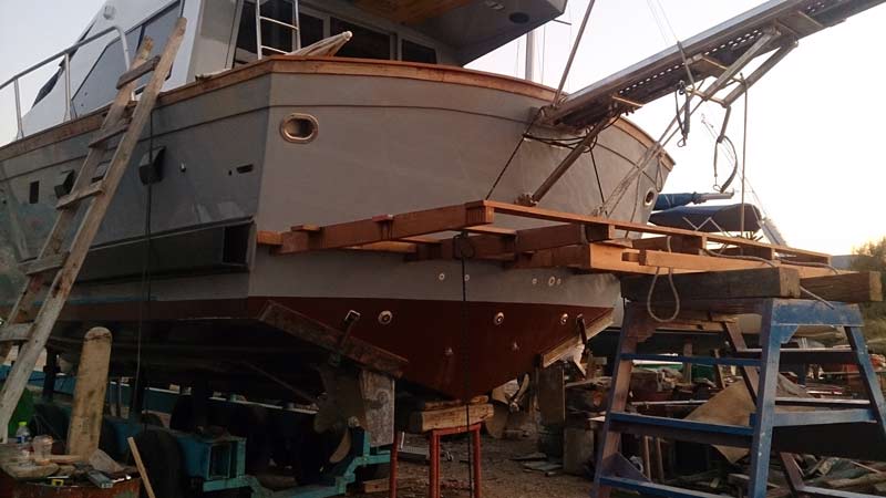

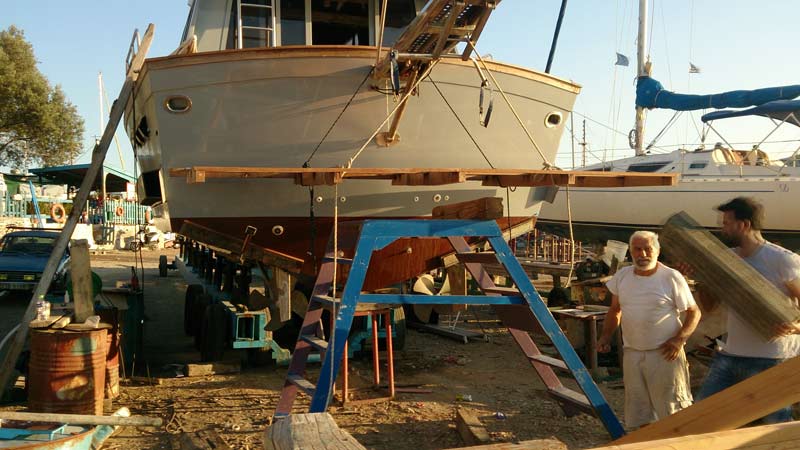

Reaching completion (on a vague definition of the word) one task that had to be done and was impossible to do where MiToS was lying was fitting the bathing platform. Effectively stbrd end of the transom was over the water... So Gregory, the boatyard owner, brought the trolley under MiToS and moved her forward by around 4m giving us plenty of space to work. That was the first movement of MiToS after 4yrs on the same spot, an interesting/important milestone I thought. Well impressed that she didn't fall apart during the move, I kept working.

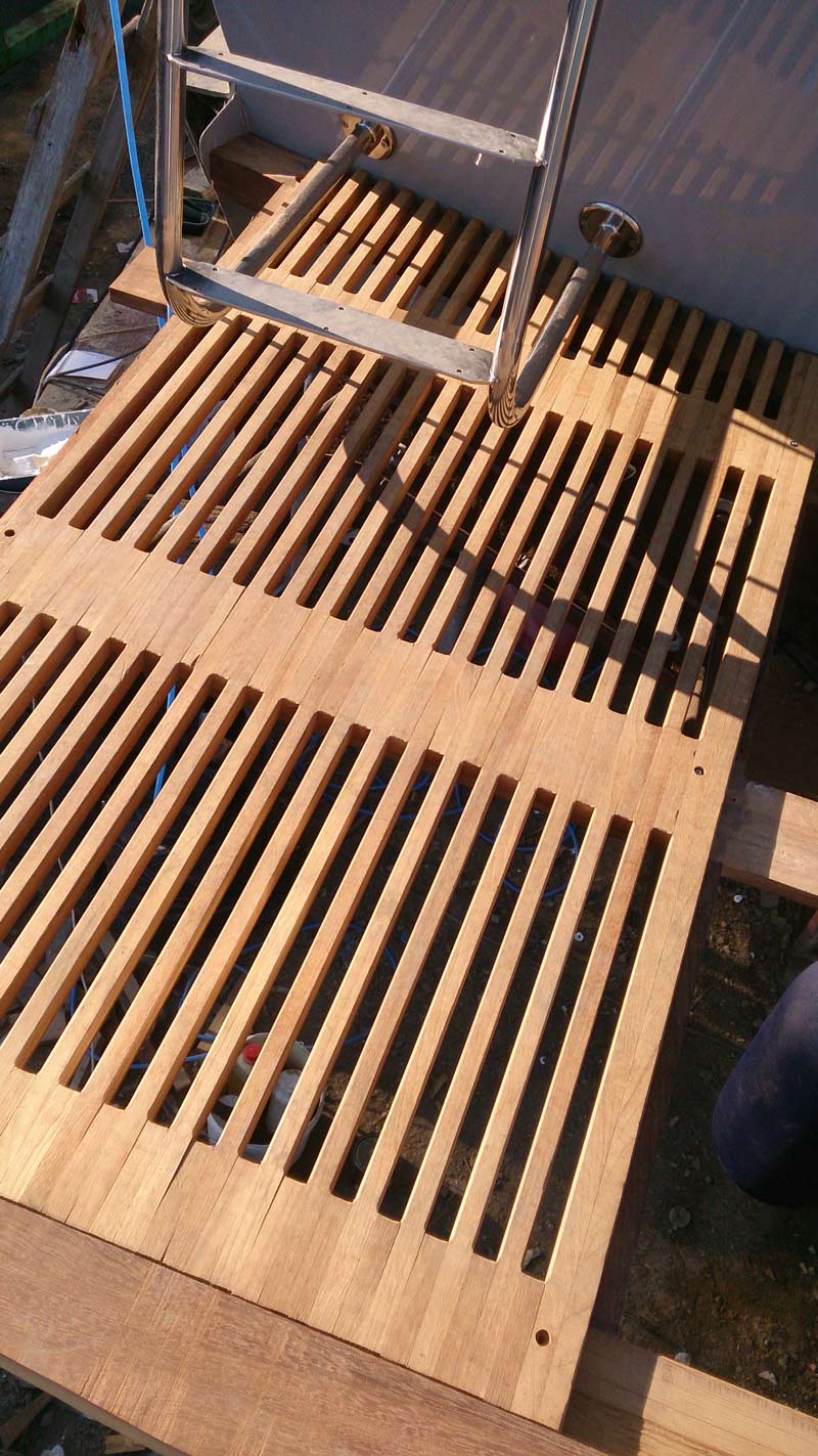

The frame of the platform made out of iroko was glued and reinforced at George's workshop waiting for fitting. Brought it one afternoon and after 3 sweaty hours 3of us managed to secure it in place with the help of the passarelle and a big oddly shaped blue ladder. The four teak "grille" pieces were then test fitted and matched on the spot.

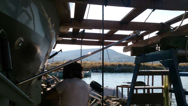

Then the ss fabricator came and did the 6 supports strengthening the whole thing.
and the full frame 25mm dia for the side and central V, 30 for the mid two. Note that I opted for using the trim tabs supporting beam and the ss tirm tabs base to weld the bathing platform struts:

With the teak on top thing feels rather solid. If I'd be doing it again, I'd definitely skip the iroko frame and go for a fully ss frame where the teak grille would slot in. Hindsight is a wonderful thing...

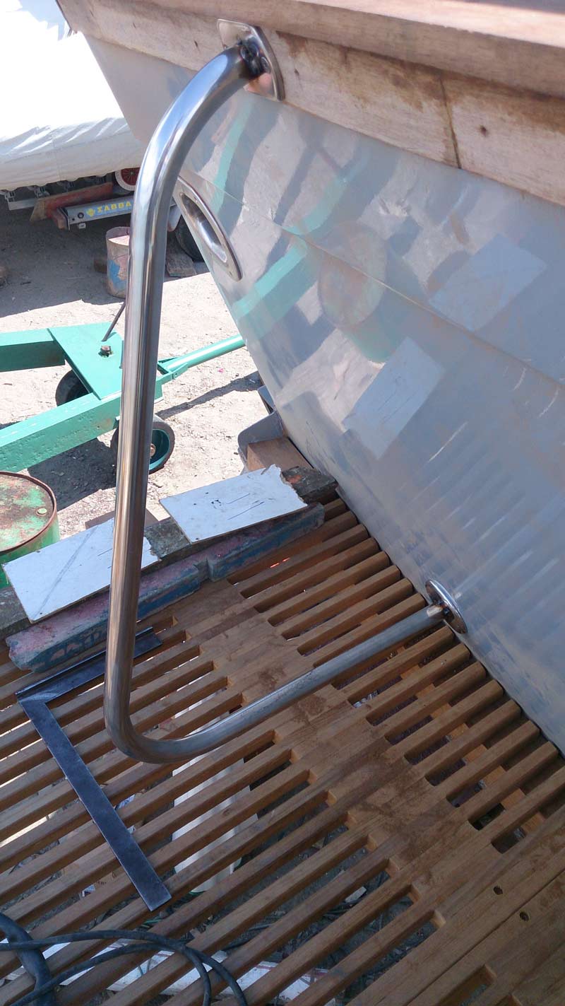

Since I liked Nick's work very much (that's the ss fabricator) and his pricing was reasonable, I went ahead with building the platform to aft deck steps. Curved and slanted (in all directions!) transom meant I decided on a fully asymmetric design with one tall handle (a la swimming pool) which proved very useful in real use. Quite different from my earlier sketches, but real measurements proved them unfeasible.
spot welded in place before even sanding and varnishing the iroko capping:
finished article in place:

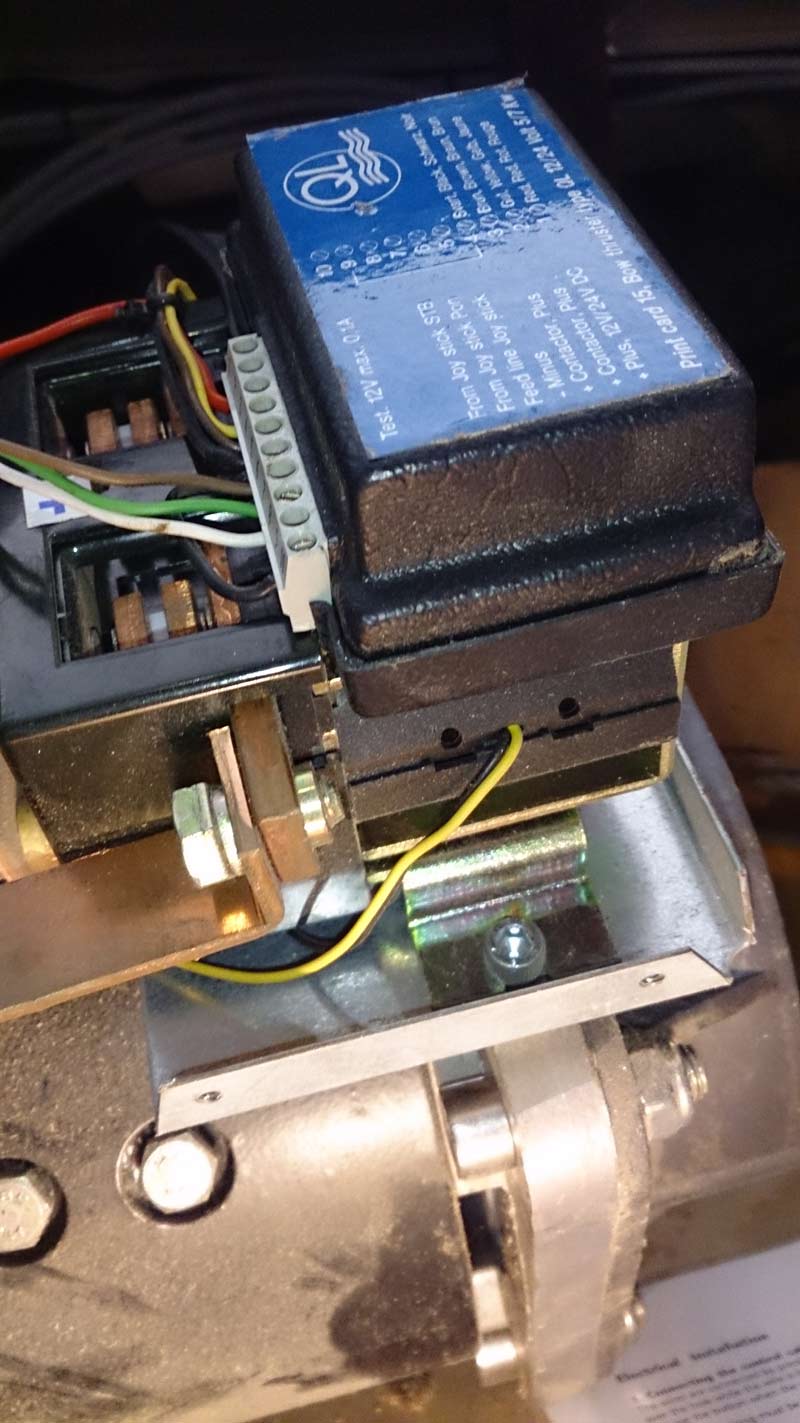

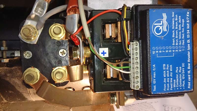

Bow thruster securing, wiring and testing was one of them. Not small job in terms of weights involved, but just a few hours to do. Massively thick wires connected with the motor on the bow cabin floor, control wiring fitted and tested, assembly bolted on in place, propellers and tunnel antifouled and fitted.

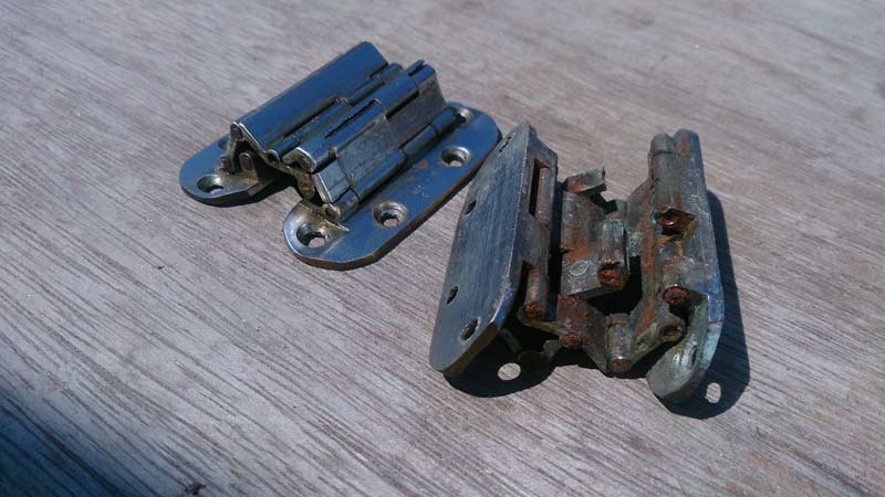

Cabin doors were also refitted, old hinges cleaned and reused. Door stops (old original items) cleaned polished and refitted, door handle and locks the same. Changed keys lock barrels on most of them, all fine. No pics to show but I do have a problem that I've only got 7 working hinges and need a minimum of eight to have 4 cabin doors working, should really have 12... Hinge looks like that, found some replacements but they are deeper, larger with a larger pivot angle to fit on my doors. Anyone got an idea of where I can source a few of them?

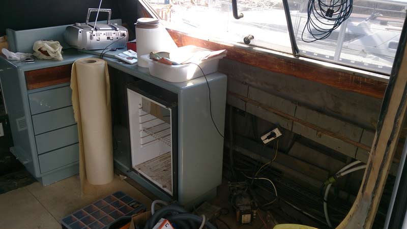

Salon chest of draws and twin cupboard corner piece was back in place, checked, fitted and bolted in place. Old fridge fitted nicely in it, just need to sort out lining the door during the winter to make it match the rest of the furniture.
