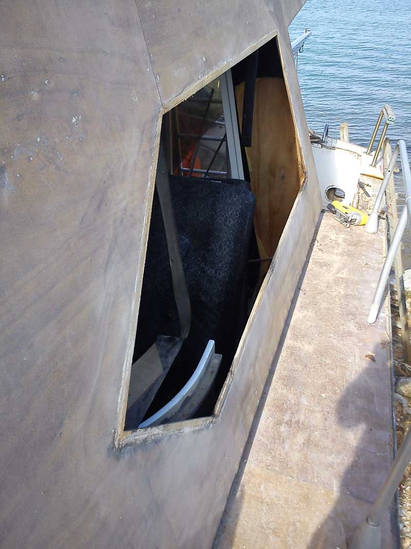

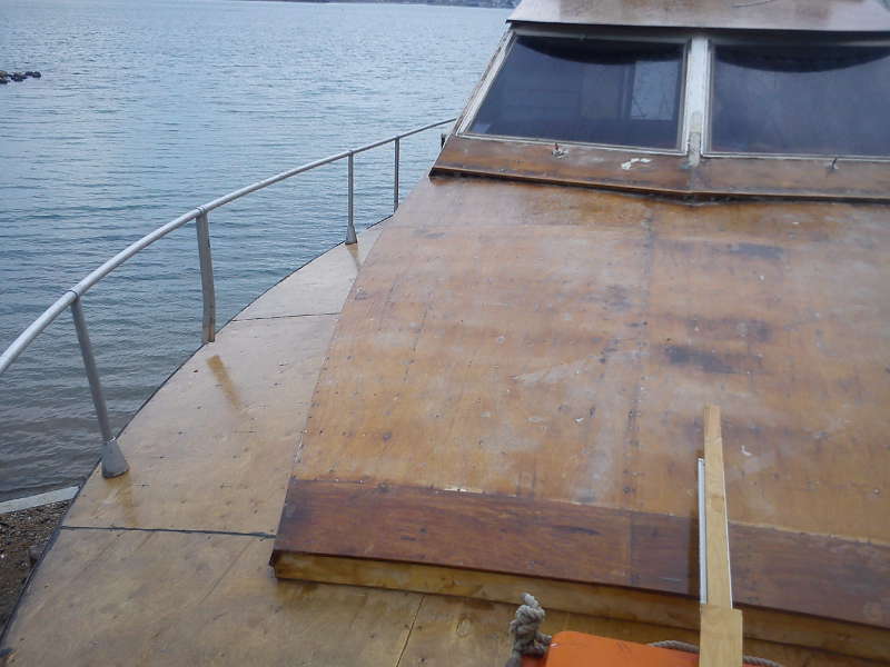

ok, and a few photos of the superstructure as it stands now:

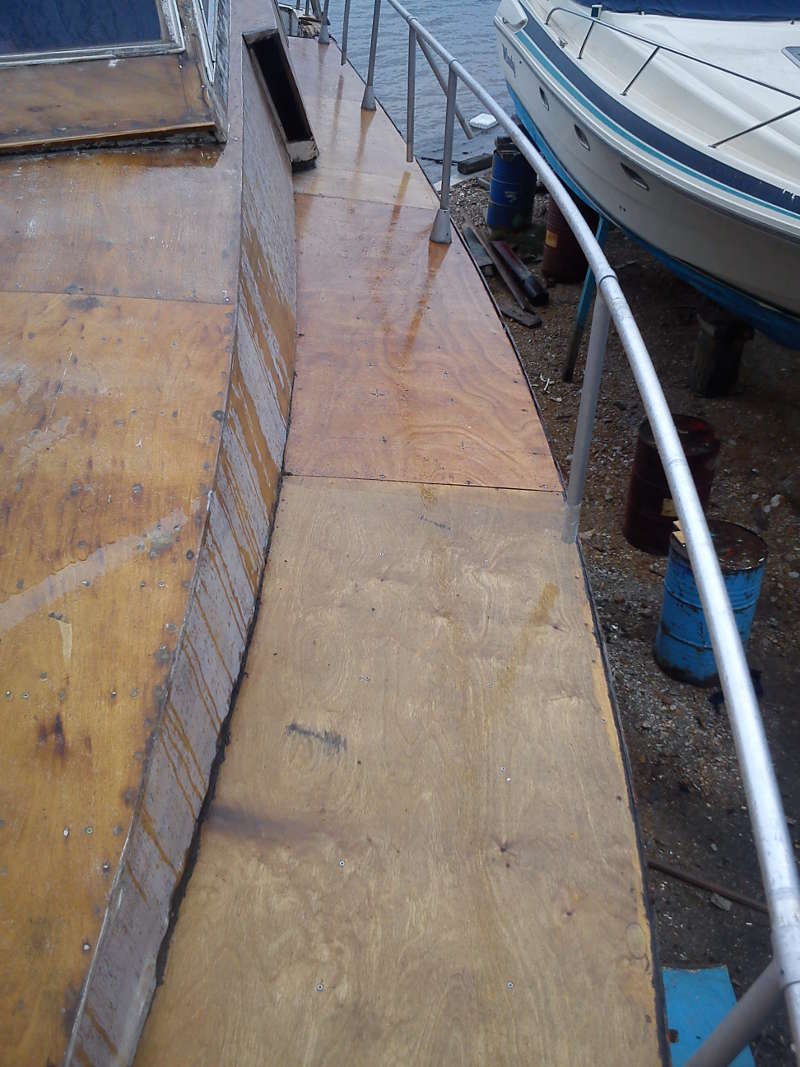

Over the last week with two days of rain to ruin my working schedule :rolleyes:, I managed to get all the superstructure up to 3 full coats of CPES, sand AGAIN and coat the full deck a few more times reaching a total # of coats of 3-4, sika all the seams to the superstructure and the rubbing strake teak strip which i'll probably discard and redo at some point during the winter.
Further, started filling with thick epoxy all holes that were either created by previous owner or have their original filler missing over old bronze screws and galvanised steel nails. I'm talking of hundred of holes, cleaned with my dremel and appropriate brush bit first, coated with a bit of CPES and then filled in. That's what I call fun under the sun...
Result, i'm knackered, especially right knee's had enough. Also want to do the same on the decks with a few dozen 2.5mm holes that failed (as in drilled the hole to fit a 5X50 ss countersunk screw only to find that I missed the underlying frame, so move a cm and did another one... Now, all these are given a proper opening on top (with a 10mm drill) so that there is a reasonable hole to fill with epoxy. More fun working bend over the deck!
Currently trying to figure out a way of covering most of the craft without resorting to a full tubular steel superstructure and thick tent material on top to avoid all the daily humidity of the morning and be able to work a bit better over the rainy season (although i'll be mostly working inside)
Exterior work that needs doing atm is:
  • removing all windows, reparing any local rot with new timber/ply, sealing, coating, sanding and temp refitting windows with new seals until May-June when they'll be removed again for painting.
  • F/B layout redone, finish paint stripping on a few surfaces and half the deck up there
  • aft deck replacement
  • aft deck gunwale (is that the right term I wonder-talking about the "sidewalls" of the aft deck) removing of all old ply, treating existing construction and re-doing it with redesigned access hatches, builtin bench at the back etc.
  • Also time to decide on pasarelle and possibly cut an access door on the transom. These two relate to the decision on keeping or removing the davits as cutting door on transom and keeping davits dont work together in my book (structurally stupid...)

Too much work at real work, not too good weather (rained one day) and trying to fill more holes and improve the surfaces to avoid lots of filling sanding after the coloured epoxy. However reaching a point where it makes sense to use colour as I spot a hole to fill only to find that the clear epoxy makes it look like a hole but it's nice and smooth. After a dozen of such cases you are well p1ssed off and want to start painting :rolleyes:
George finishes all the small patches here and there in the superstructure. Today and tomorrow we'll remove the saloon windows+frames and he'll work on small patches of rotten/blackened ply around (luckily not many)
Rain is predicted for Wed, so if we believe them, plenty of time to dry, coat locally the area and refit. Not had much luck finding replacement seal for the almost 40yo original item (which is rocksolid and breaks apart if stressed!) Will probably get a temp solution with a near fit for the winter and source a proper solution over the winter.

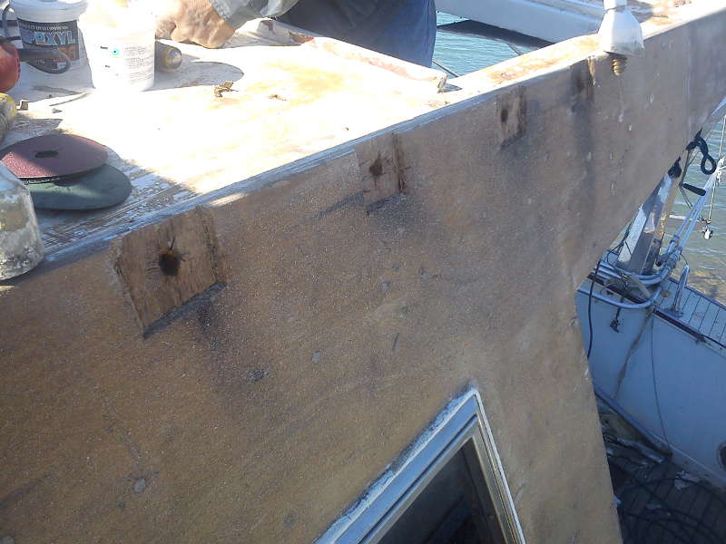

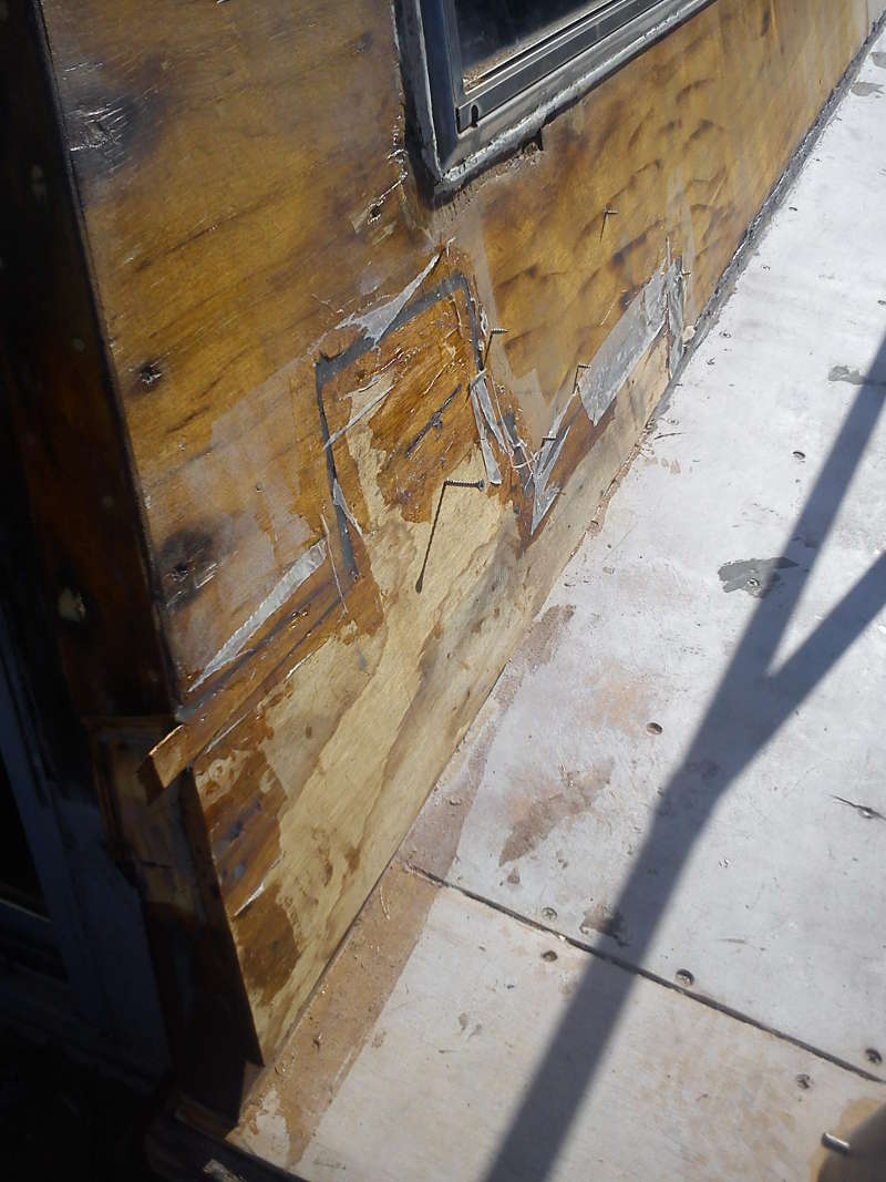

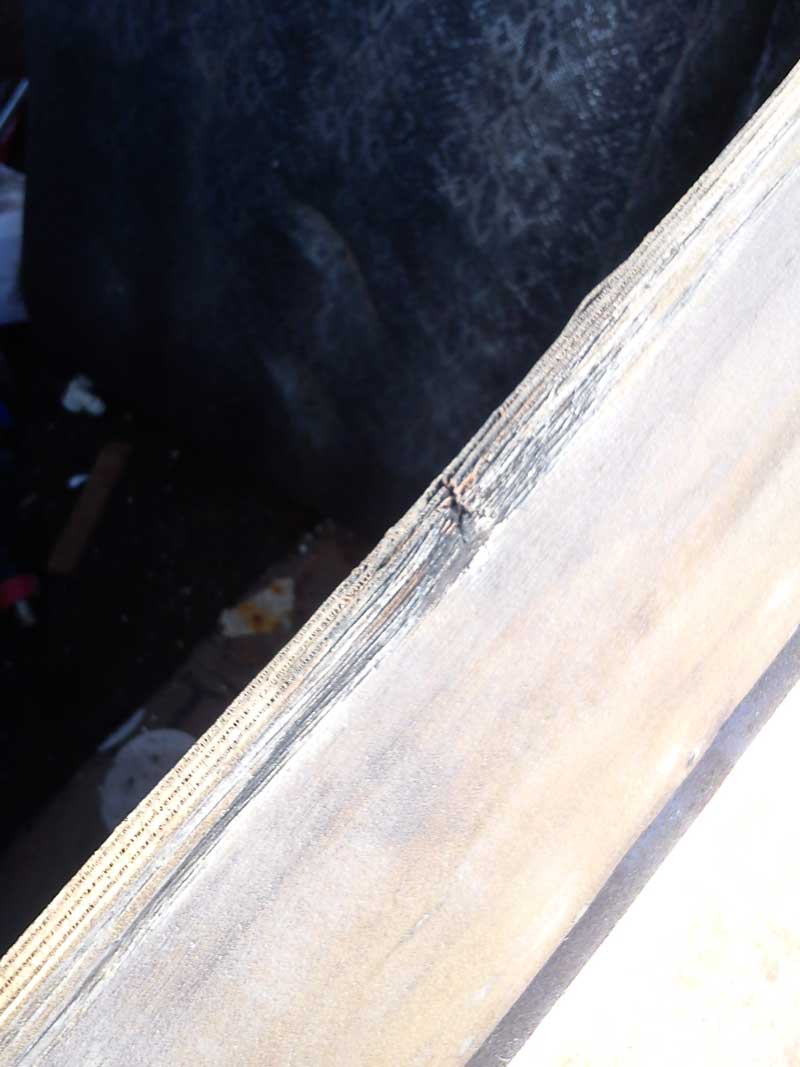

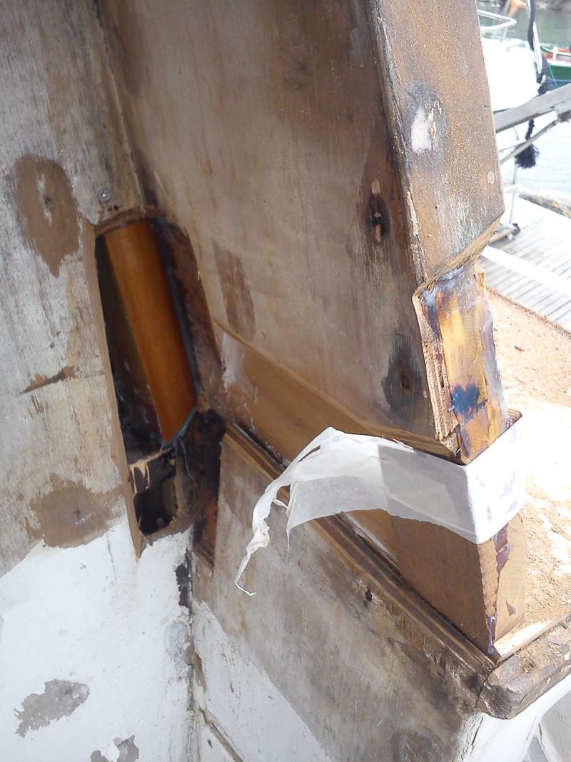

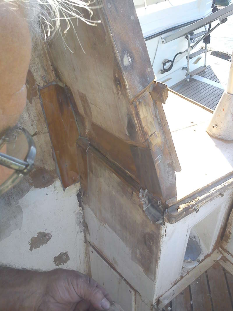

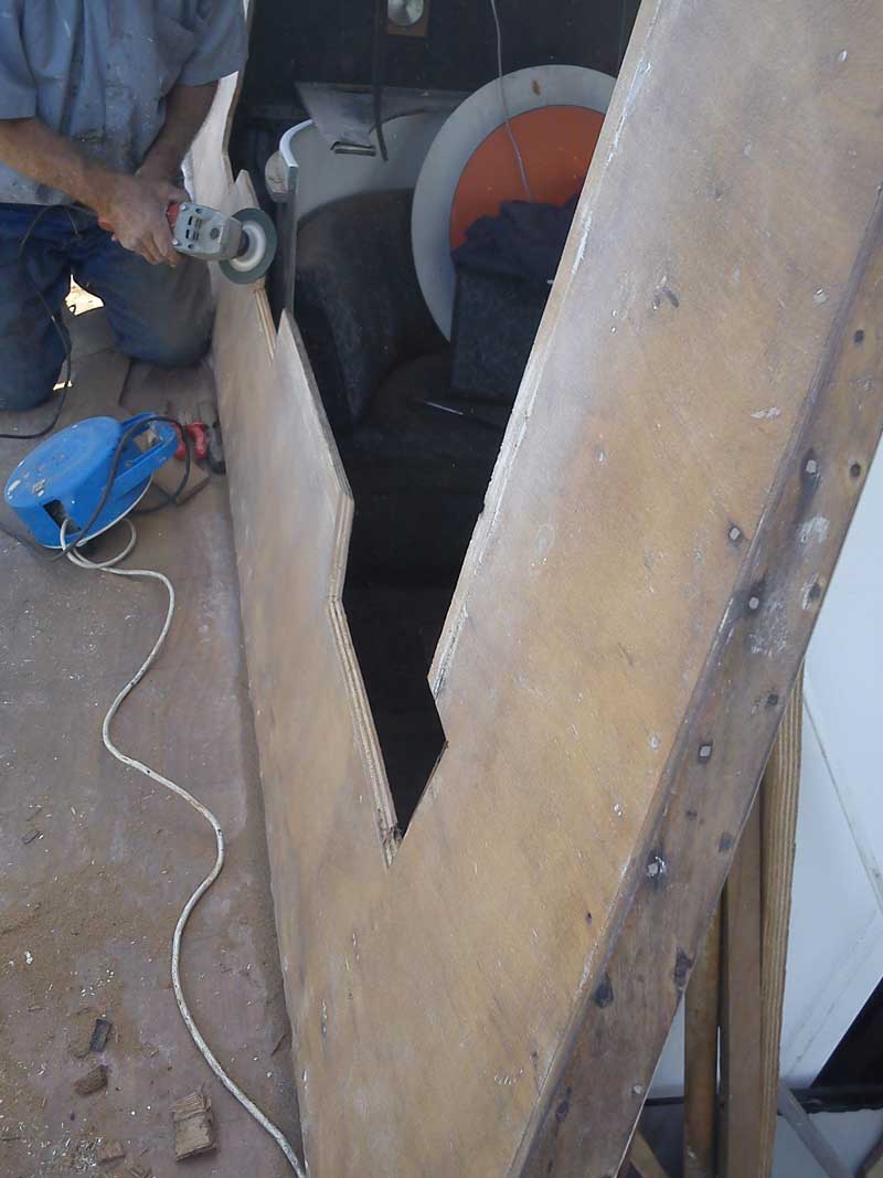

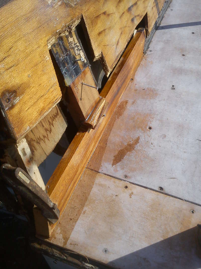

a few examples of the stbrd side repairs

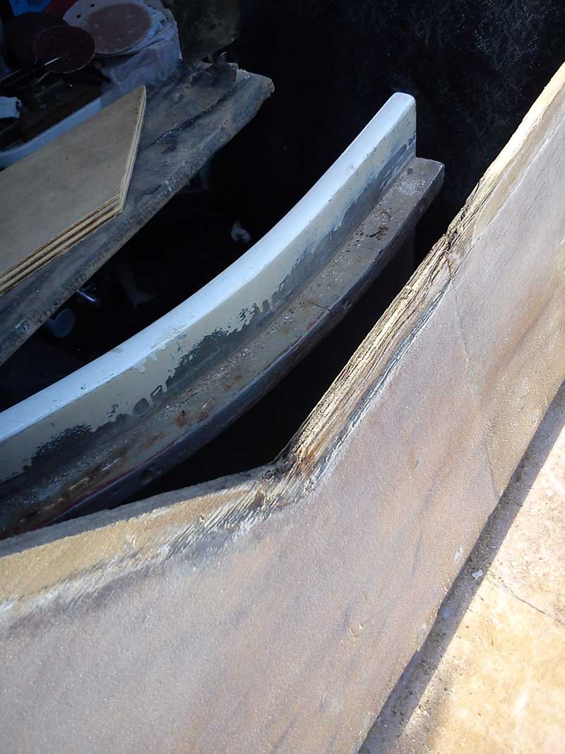

Removed the lump of timber on the port side of the f/b where the arch was secured, found a nicely rotten piece of ply underneath (as per the stbrd side...) and replaced. Photo is preparing the hole, note a dark patch on the right bottom of the pick just off the hole, had to do an extra patch there. All to be sanded and CPESed today:
And after the time spend filling the 4 M10 holes on the stbrd side, cut and replaced them wtih new ply on the port side. Ah, well experience...
BTW must have spent 3h sorting the filled up area on stbrd and it still looks carp. I guess it will be another 3-4h filling sanding and swearing before it looks half decent!
Another round of sanding/filling for me today (also got to finish sanding the f/b floor and remove the two godawful grp seats for the f/b helm) and stealth grey painting in various tones tomorrow for the helm ceiling/sides and sundeck.
New report on Sunday eve if not too knackered.
A new problem that arises is that I was happy with slow curing CPES taking just over a day to cure at 25-30C but now takes half a week with 15-17at night and 22-23C daytime :(
Ended up getting some faster partB component and will be matching slow and fast to create decent 1day solution. Don't really want it too fast as it wont penetrate but not too slow as it never bleeding dries!

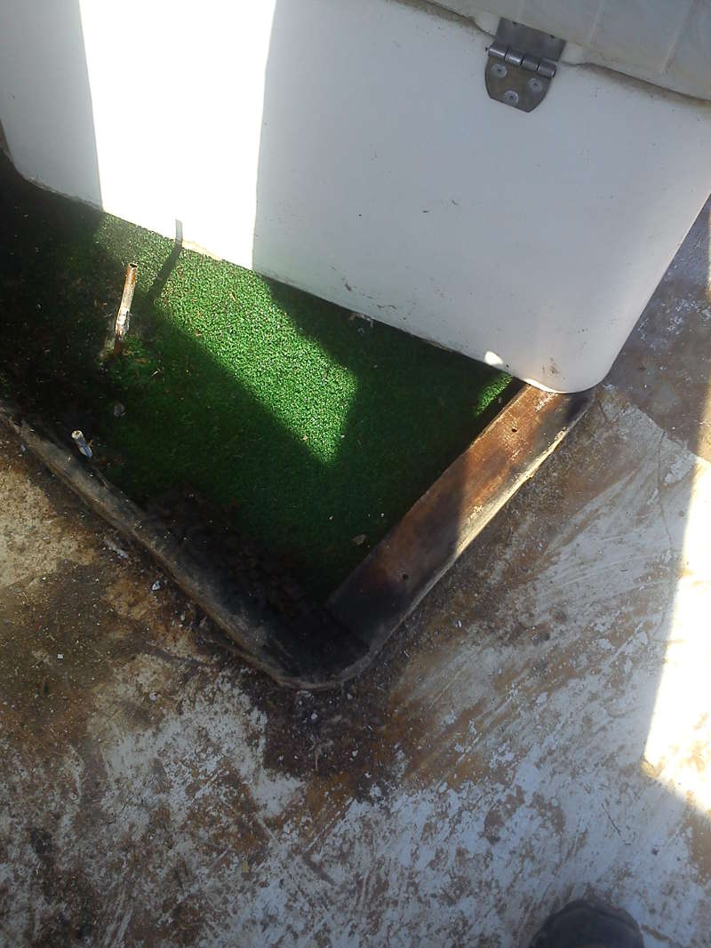

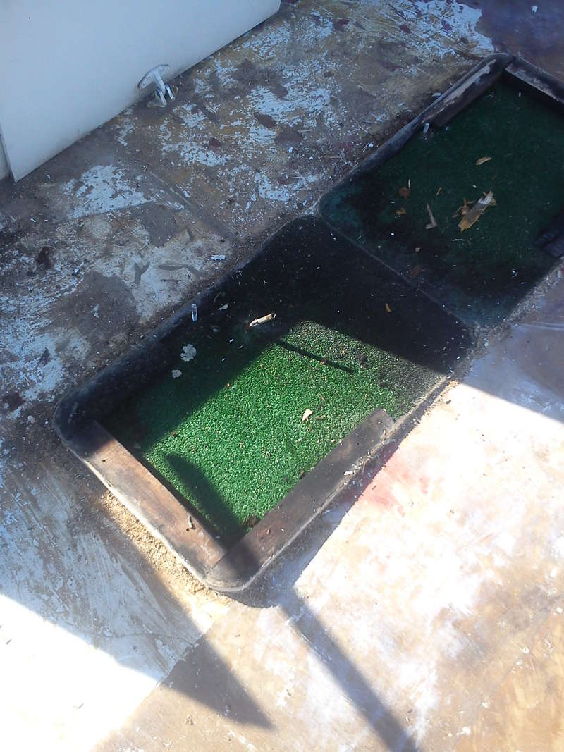

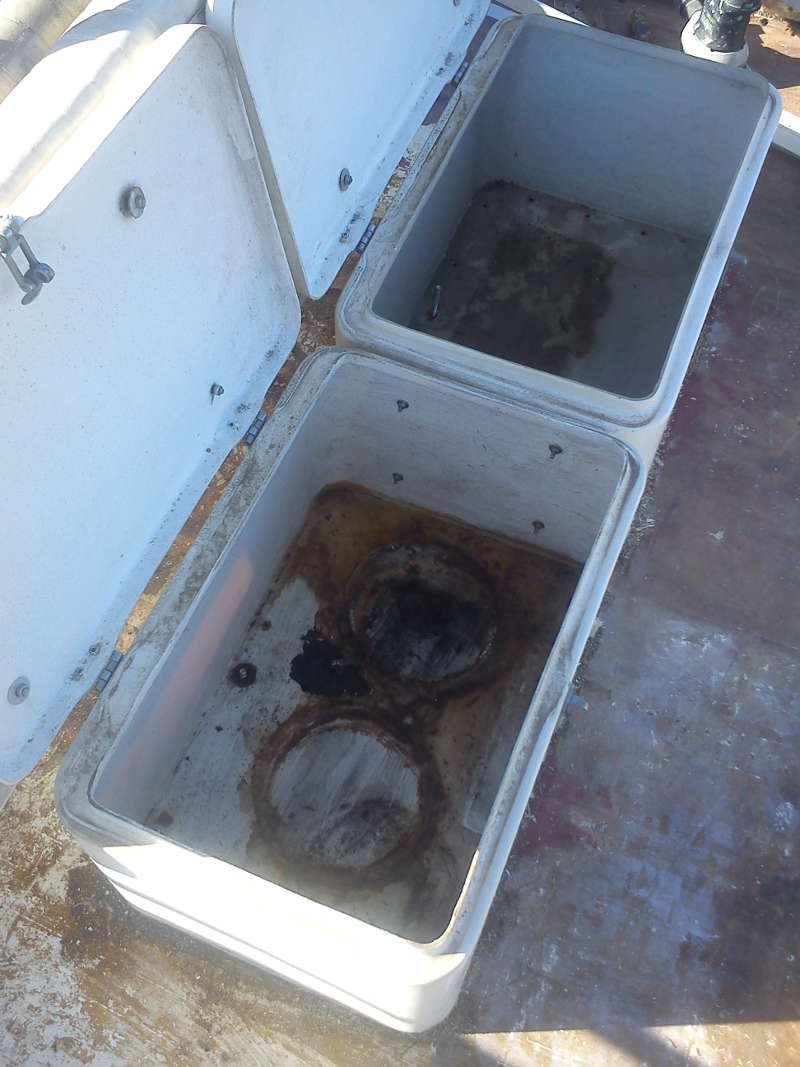

Emptied the f/b in order to seal the rest of it. Had to remove the twin helm seat, a godawful construction rotting away and keeping the propane gas bottle (and a spare in it). Tried to remove the flex pipe (there's a hard copper pipe routed inside to the galley) and came across this amazing detail. PO had an obviously failing flex pipe and instead of replacing it (dunno would cost 20-50cent!) he opted for keeping 30mm length original pipe at each end INSIDE a clear flex water pipe... FFS!
Further, on unbolting the seating I found a nice piece of synthetic GRASS underneath the box, all soaking. Unbelievable!
3h later it was like this ready for CPES, so saved it! Note, that the stbrd side was already coated twice, there is a zig-zag pattern separating the two, but the rest will be on two coats tommorw ;)

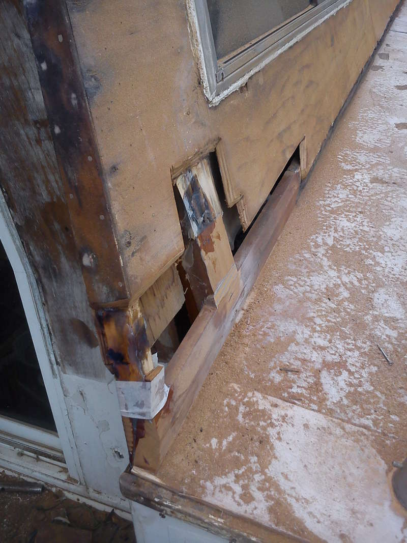

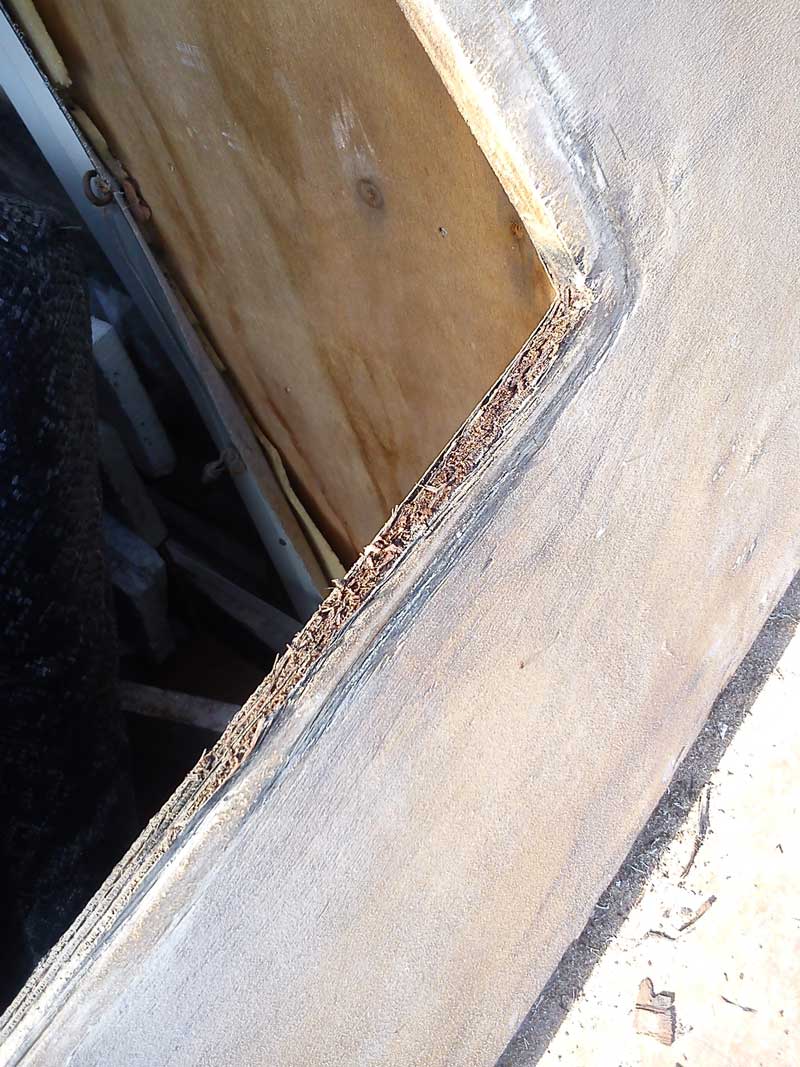

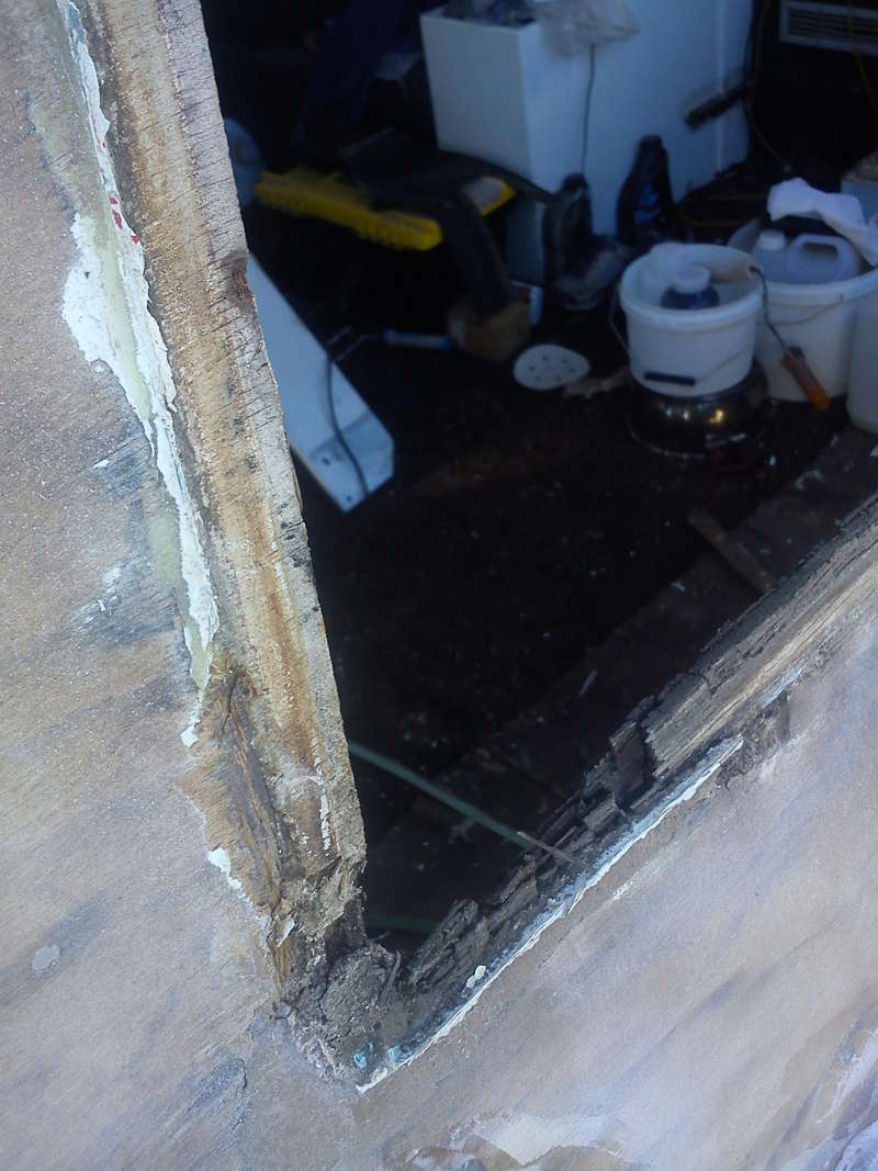

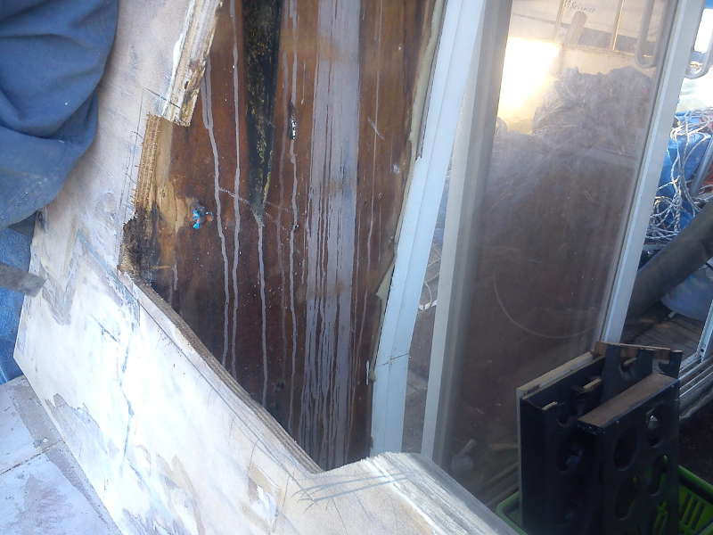

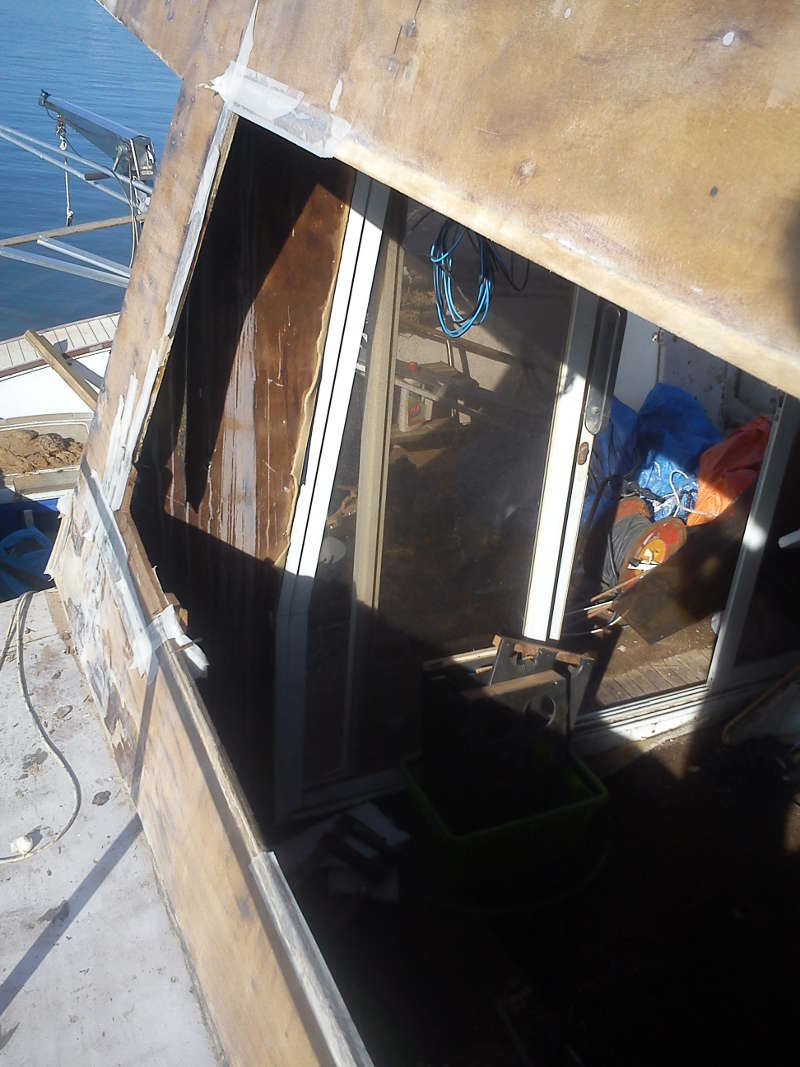

Also removed the stbrd side saloon window frame and George repaired the rear lower corner that was rotten, not a large patch but important nontheless. Also cleared and filled two more spots and sanded/removed old layers of paint the whole surrounding and epoxied it once.

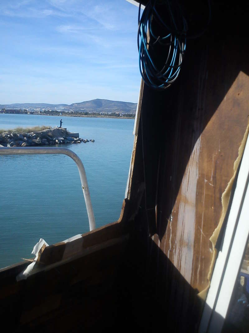

The following is not giving much detail, but frames nicely the bloke fishing in the background. It was a really lovely and v.sunny day!
So tomorrow if I'm lucky I should be coating with coloured epoxy the helm roof and adding a coat of epoxy on the f/b deck.

Good going Vas. Anticipation buiding here because you have nearly finished the plywood fixes and so will be adding the coloured epoxy - can't wait to see
PMSL here at the fake grass. I mean, wtf? I'm thinking maybe the whole fb was done in fake grass, with the seat box screwed on top, then a later owner removed the grass but had to cut around the seat box, so leaving that patch. Can you image the whole deck in fake grass LOL?
Perhaps a previous owner was a golfer, and liked to practice the swing on the f/bridge?
I'm just thinking what a Boat Safety Cert inspector would make of the gas installation too:)

hm, should ask if PO was a golfer...
It would be absolutely hilarious with the whole f/b in fake grass :D
Unfortunately it MUST'VE BEEN like that for sometime, as JFM points, it's clear that they had the grass, fitted the trimmed iroko to take the curvature of the deck, bolted the two boxes for the seating on top and at some later point trimmed the grass out, wouldn't bother with the seating and retrimmed with the less godawful vinil with black strips (a la Princess deck)
Spent most of Sunday at home with the kids so that the wife could finish off some pressing work so couldn't do the coloured epoxy testing/painting, sorry guys :(

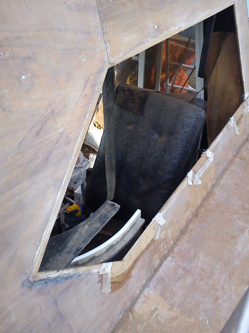

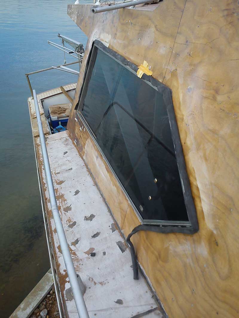

Only had time to remove the port saloon window, George did three patches I filled/sanded/epoxied again the surroundings of the stbrd window and later fitted temporarily both windows in replacing the original hard as a rock seal with some homemade from stripping a pipe foam insulation in two and pushing it in the ss edge of the frame, not elegant but works in case we do have a shower or two before I remove to sand/paint and refit.

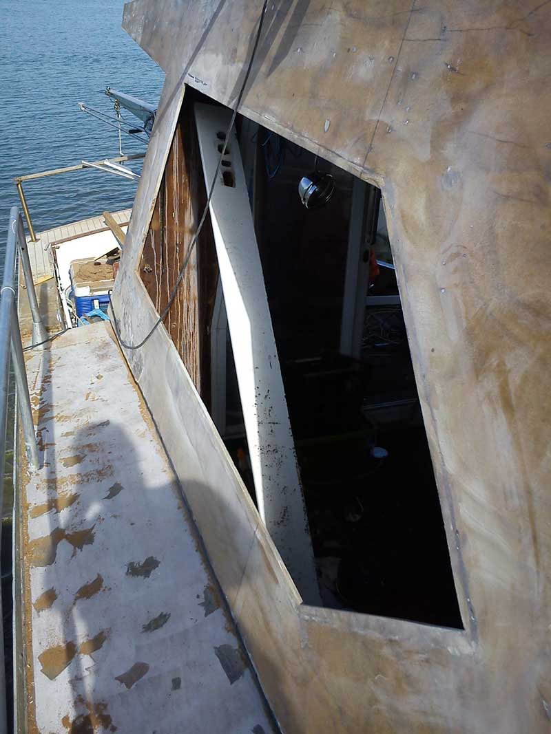

Next set of pics are of the port window, focus on the three patches and repaired/finished article:
Final pics is of the stbrd side finished and replaced:
Since the weather is going to be nice and mild (sun, 18-22 a shower or two on Wed and sun again) I decided to have a go at finishing the basic work needed in the f/b before I cover the top and start working on the aft deck and then hull and inside.
So plan for the next 3-4days is to reconfigure the f/b helm, do a couple more patches on the aft of the f/b deck where the two main supports for the railings are, decide on a way to fit the railing again in place securely and paint the helm roof. See how much of that I'll manage with all the work disruption :D

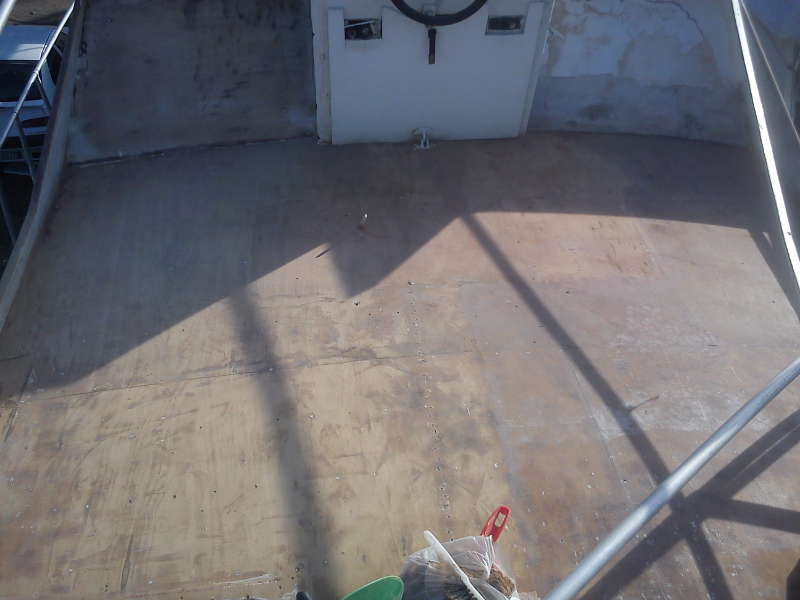

One thing I'm not particularly happy and sure about is what do I do with the f/b flooring. I mean I will have a fixed L shaped seating with the actual helm seat doubling as a corner sofa sort of thing (some swapable backrest needed/half designed it already). But I don't particularly like painted ply (and I wont even discuss astra turf or other synthetic grass options!), so I'm thinking of laying teak there as well, maybe a bit thinner 8mm compared to 10 I'll probably do for the deck (or 6 vs 8mm, not decided yet).
Concerns are weight way up there, railing supports that will be lifted 8mm and wont quite fit properly on the fixed points towards the front (not really a serious issue tbh)
So, what does the panel think?
teac for me, without doubt,
same type like downstairs.
I would do the complete empty surface,
because you never know in future if you like another configuration for the seats, etc...
jfm
16 May 2001
23,811
Jersey/Antibes
Yup, teak. 6mm is fine; you don't need 8. Or synthetic teak as in Ellesar's current thread. Then make the seat base boxes in ply or GRP
