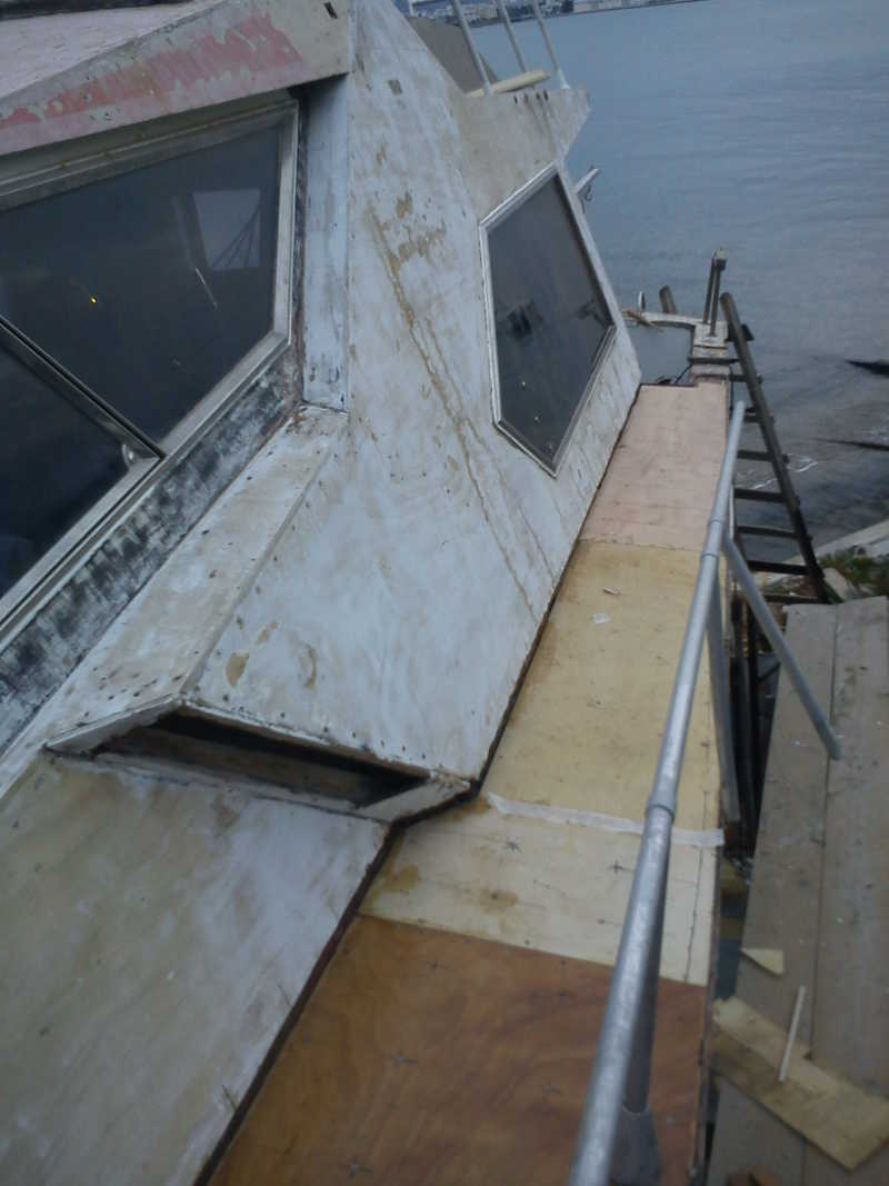

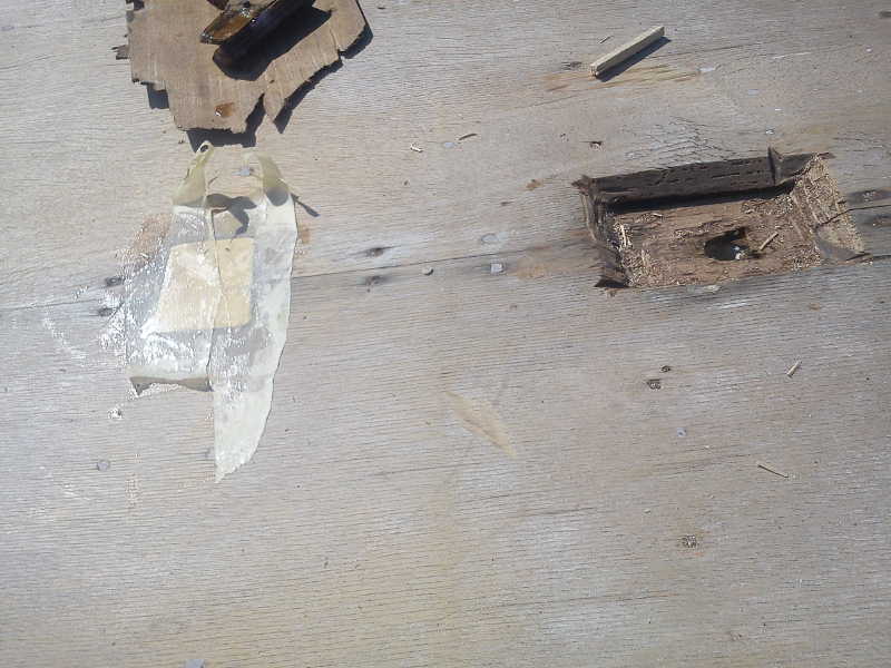

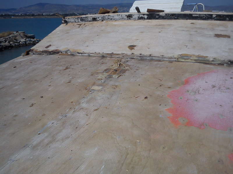

The following pics are the before and after the 1 only coat of epoxy that the sundeck got treated with. Reason was that I'm running out of the stuff and trying to sort out delivery from the UK but I'm slightly stuck in the hazardous and flamable nature of epoxy and may have to buy locally at almost double the price :mad:
Was rushing to get everything sealed before it starts raining and forecast (in a similar way to yours) the rain and now reports that may have a shower or two in 6days time. So time to work on the rest of the deck tackling the dodgy part where I don't have access from the cabins but through the galley cabinets and saloon sofa on port side.
Stbrd side is going to be a pain as I'll have to shift the el/panel (almost impossible!) or remove the actual helm cabinet and further aft dismantle the whole cupboard thing in the saloon. So, i'm starting with port side :rolleyes:

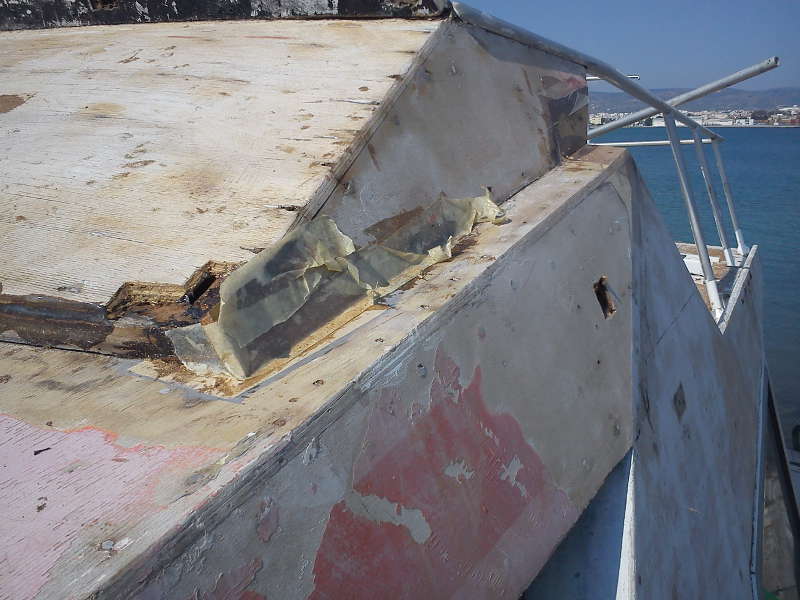

George is working on the few helm roof patches. It is again interesting to realise the story (and mishap/stupidity) behind each hole...

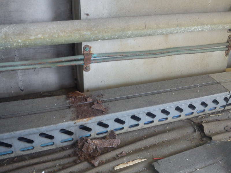

especially in the next pic where you see a large patch on the right (the cabling for the horns!) and a smaller patch on the left (the mounting holes for the horns!)

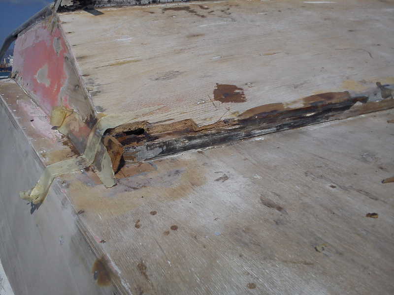

Well, the next one, i'm not fully convinced it was the previous owner, maybe a slight design issue as there's no way for the rainwater to leave this space. may have to drill drain holes and seal them properly. Or then maybe there were holes that the six or so coats of paint fully blocked :rolleyes:
Tomorrow should see some reasonable progress in the port side deck and I should have the alu panel/window maker coming to figure out what we should use to reseal the ss window frames (that have to be removed, checked and replaced)

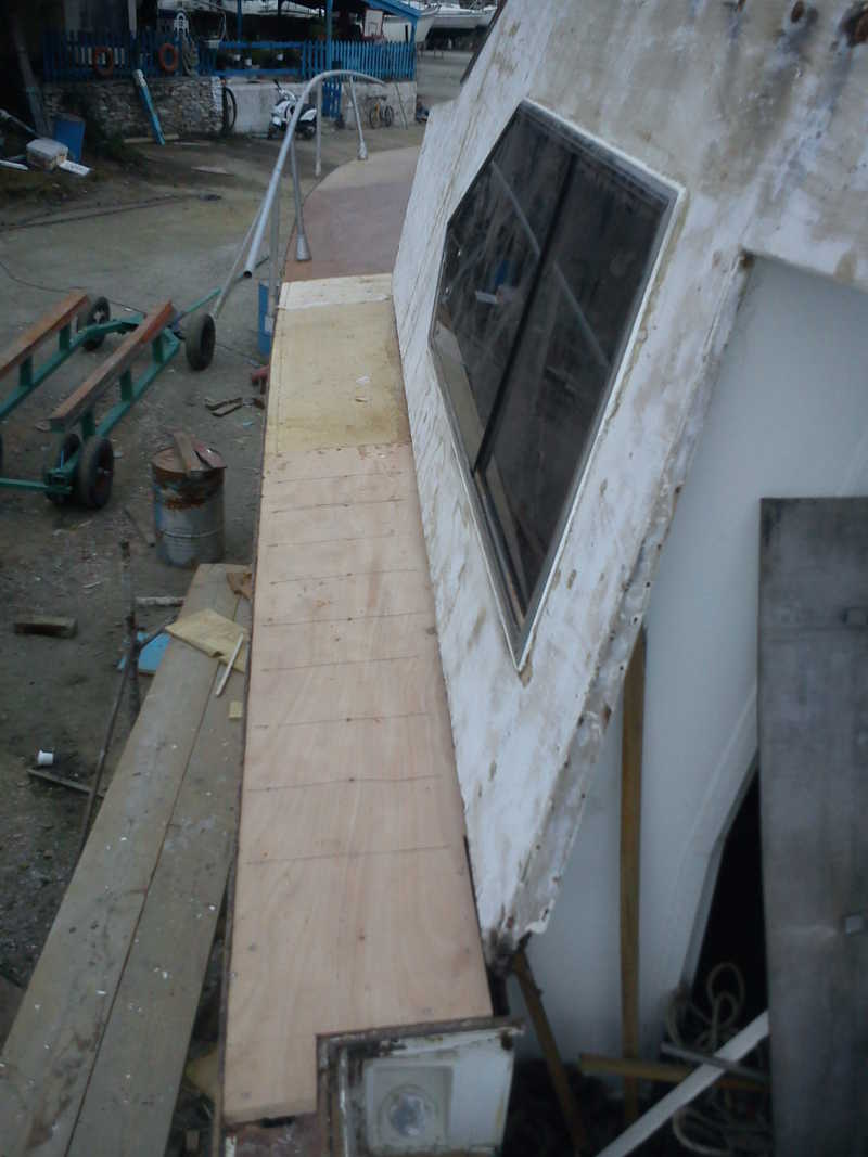

some decent progress although temp was again 29C and no clouds blocking the bugger...
On the helm patches front some progress as well, should be finished on Monday as most patches were a 3 level job, first the bottom is epoxied, next day, cleared/sanded/checked, side wall part is added and the third day the capping is added...
The two photos above are taken today after day two, so sides are done.

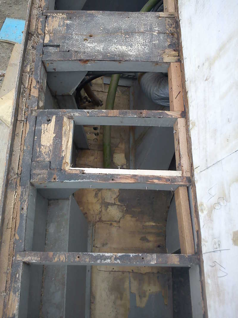

After an 11h session yestereday together with George managed to complete the port side all the way back to the aft deck. Good enough as rain was predicted for yestereday, didn't materialise and only had a 4min shower an hour ago :rolleyes:
Was nicely overcast throughout the day yesterday and I have to say it was the first day that I was wearing a t-shirt throughout. Temps were still 20-25C.

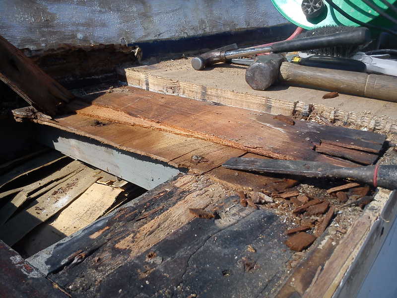

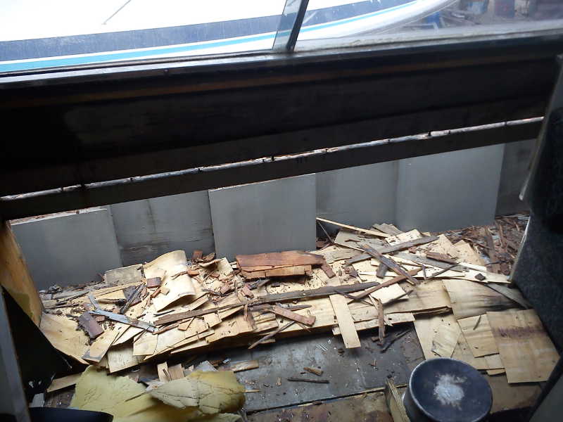

closeup of the cleared frames:
and the mess it produced in the sofa area:

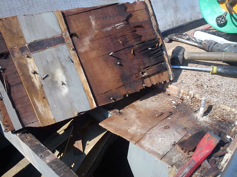

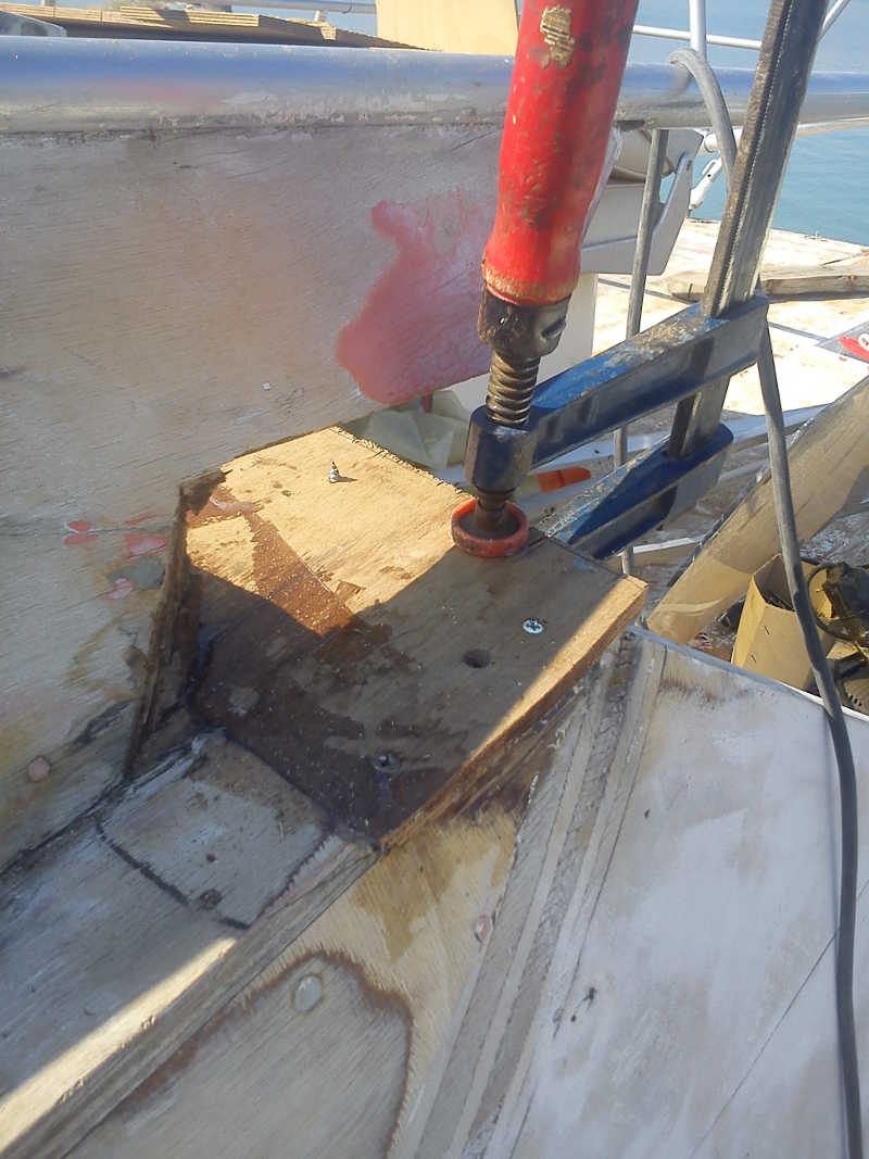

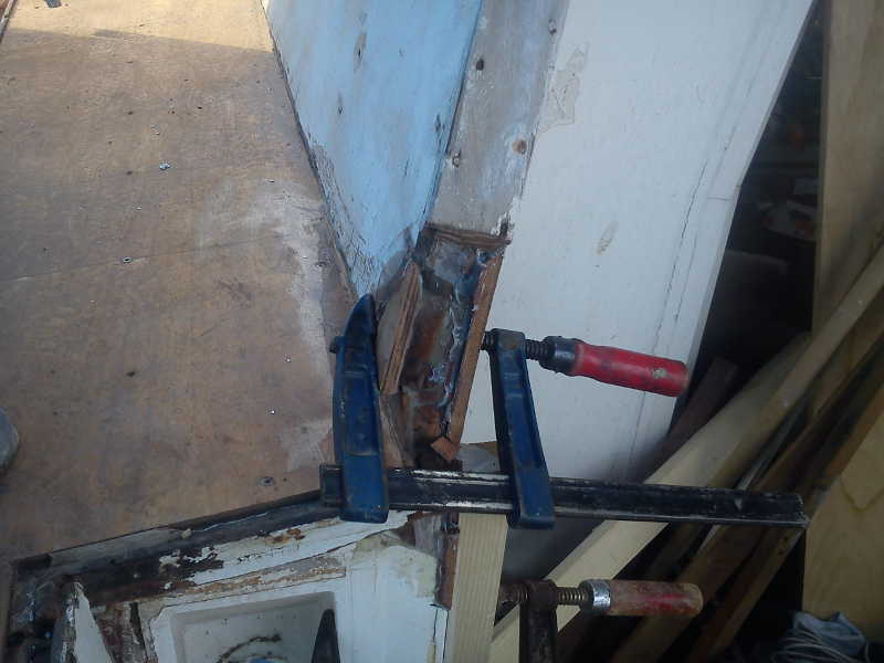

some delamination on the edge of the flooring ply touching the hull. Cleared some of it, will treat it and replace larger sections as appropriate. This is the one responsible for sound isolation and fumes isolation to the engine room, so I'll take a lot of care and possibly remove larger chunks of ply here (if not ending removing the lot and do spare me the jokes with the broom plz :rolleyes: )
lots of glue:
and the finished article:

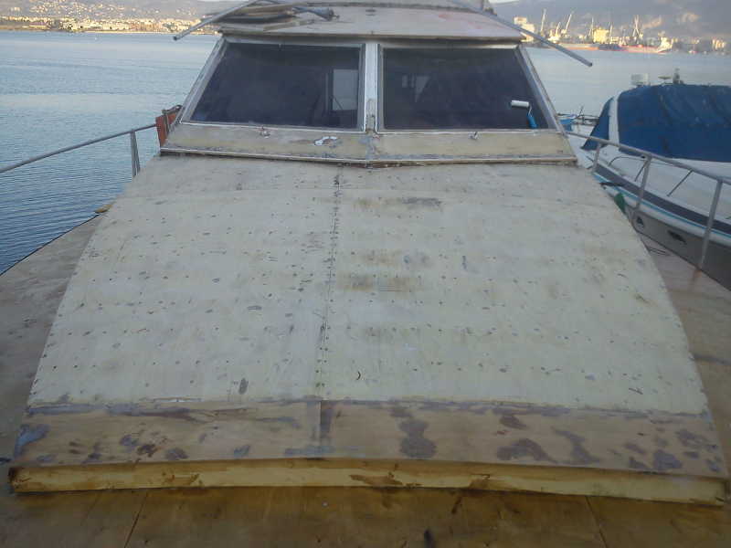

Helm roofing fully sealed and all of the f/b floor that I've already paintstripped and sanded was also treated with West. Next photo for rbcoomer with wall-to-wall clouds :p

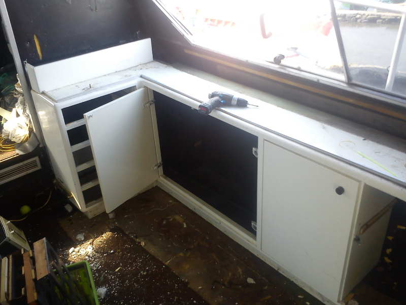

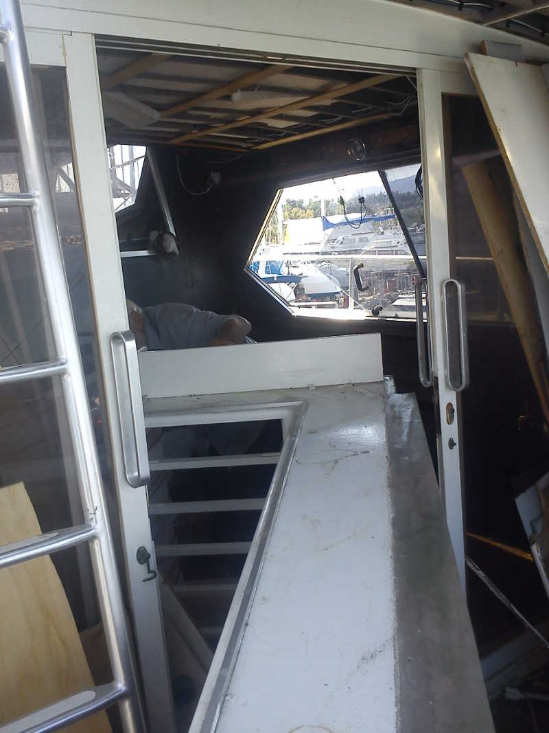

Today most day was spent removing and loading the stbrd side saloon cabinet to George's car. To be stored, refurbed and lacquered over winter and to be added back in MiToS when the time is right.
OK, wasn't an easy task. Bleeding thing was around 80kg and fairly awkward to deal with. Removed all cabinet doors and drawers (to reduce some of the weight...) and finaly were only 4 screws holding the whole lot in place! Two under the lower helm seat and another two at the aft end of the cabinet.
For sure it's not coming back that big! lowering it down to the ground was let's say "interesting" Me on the the f/b with a thick rope holding the heaviest part of the cabinet, George on a temp scaffolding leading it down, at some point it STUCK on the fiberglass exhaust cover and had to wiggle it about, eventually after 20mins got it down to the ground, phew!
Just considering adding a two seater sofa (1.4m wide) on the stbrd side instead of the 3 550mm narrow cabinets. I find the 3 cabinets full of glasses and cups a bit extreme and I'm sure I can get them stored in a more space efficient way. Idea is to keep the 5 drawers towards the helm bulkhead and replace the four cupboards with 1 fridge towards the bow where the height is larger and I could shove it half way under the deck and a two seater sofa. Odd plan is to use the section under the sofa towards the fridge for glassware cabinet (possibly two LARGE drawers under the seating) sliding out and revealing lots of glasses/cups) and the other half of the sofa for storing life vests (got 10 onboard and they aren't currently in an easily accessible place - under the galley floor!)

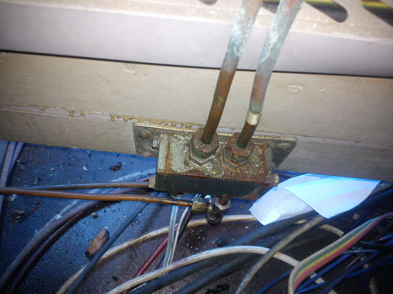

Try to figure out what's happening on the following pic:
And finally the following pic shows the routing of the diesel towards the tanks. I'm thinking of replacing the flex bit and it's loop.. Mind is this loop useful for anything? I've got my ideas but would like to know what the others think.

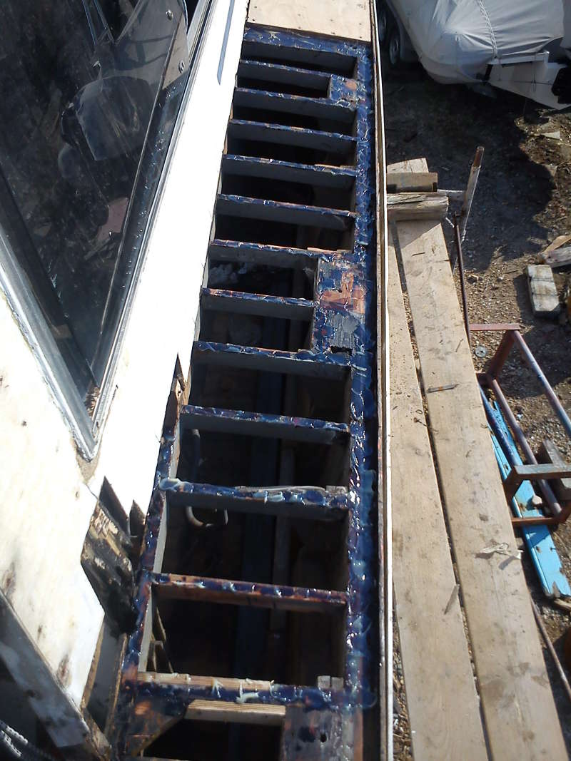

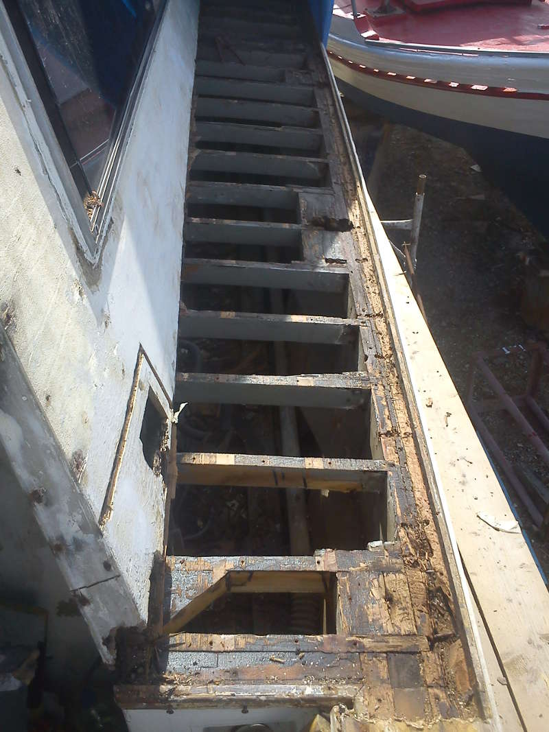

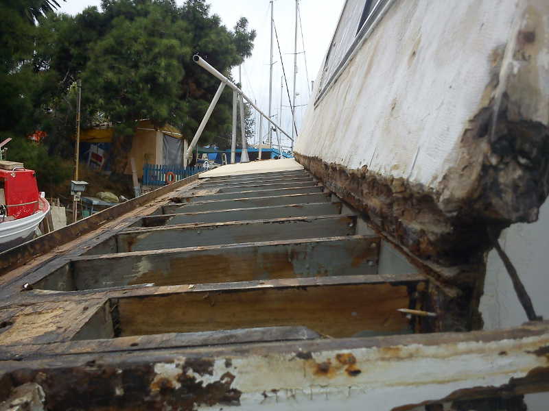

finished stripping the stbrd side deck all the way back to the aft deck.
Suprisingly, there was a lot of water damage nicely covered by the saloon cabinet so no remedial action was taken by the previous owner. Although his actions were mainly stuffing the place with white silicone (from the inside!) so tbh wouldn't be of much help :rolleyes: Note the marked to be removed area of the ending of the superstructure to the deck. Apparently the ss through bolt rusted, rot affected the 35X90 iroko beam and when I was removing the outer ply bit (soon after the photo was taken) the iroko came along... So George is preparing a new piece for this section.
Have a feeling that a sheet or two of 1250X2500mm ply will be needed on the stbrd side and that's above the waterline!
Frames are ok except for one horizontal member that needs strengthening on the offside.

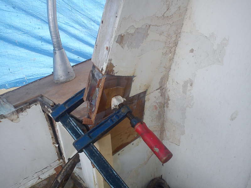

George finished working on the port side patch where the superstructure was ending and rotting together with the deck. A 5 level job with inner frame of iroko, followed by supports for the inner and outer ply skin and finished with a thin strip completing the ending to the aft deck. Looks very nice and extremely strong and solid ;) Probably took 200ml of epoxy to do as well and two dozen inox countersunk 4X50 and 5X50. Level four is shown in the following pics before glueing the cap today.
Plan is to let the stbrd side frames dry (from the dampness gathered there over the two short showers we had last week-kept covered this week) do all the preparations tomorrow and cover it up on Friday.
Gives me enough space and access to tackle the leaking steering separator box or whatever you call this thing: Has two copper pipes bringing fluid down from the flybridge, and under it are two T-pieces going aft to the pump and bringing the lower helm fluid on the other side. Turns out that the top racor (is that how you call them?) on the one T is leaking (A LOT!) All cables under there are a right oily mess, but on the positive side, ply around there hasn't delaminated and looks brand oily new :D. Maybe I should bathe the whole hull in steering fluid oil :rolleyes: Definitely cheaper than penetrating epoxy...
Managed to get the short pipe to the tee from the bottom of this separator box out and will check it out later on at home. Needless to say that without the deck out, this was an unbelievable job to do as I'd started it during spring and left it untouched since! So one of the good side products of stripping the whole boat to pieces...

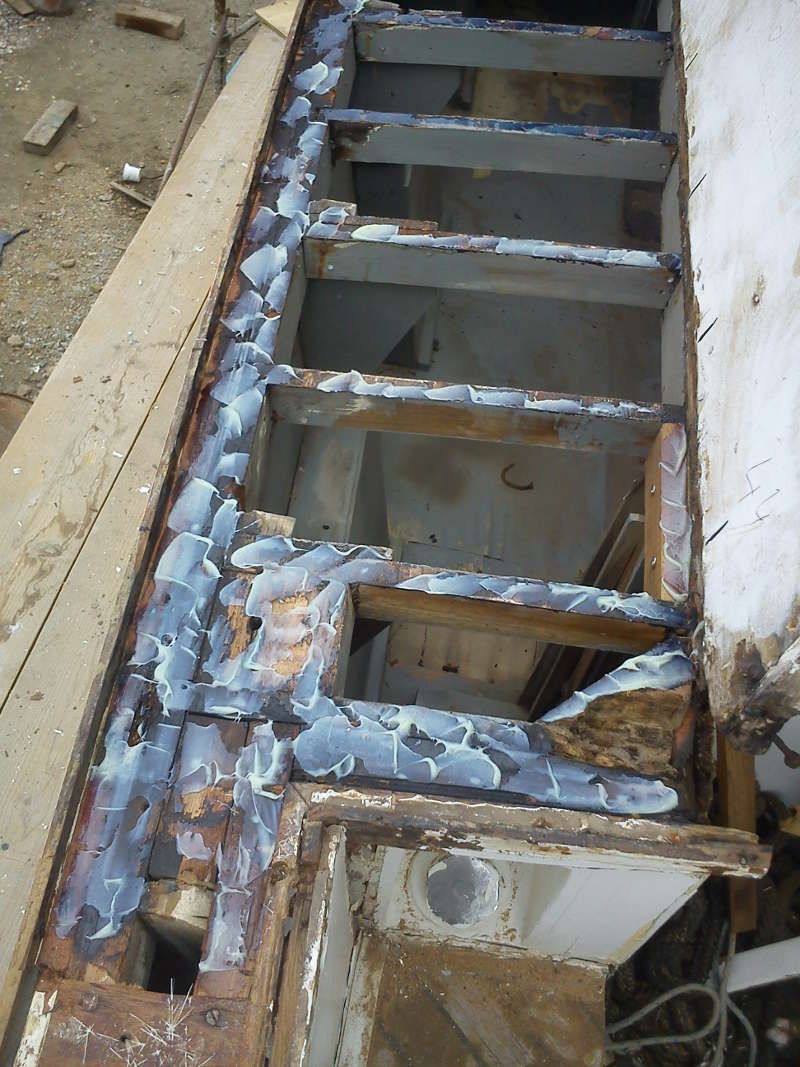

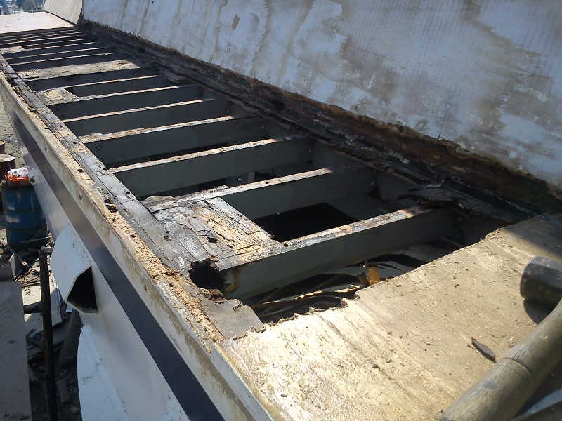

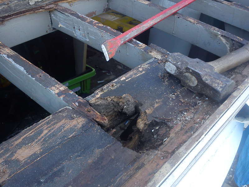

Finished the gunwales at last! But I've just realised i've not got a bow looking back photo that covers the lot to prove it, just trust me :D
Next photo shows some interesting damage which was part of water ingress and part of my stupidity when I was paintstripping with the heatgun and effectively put the inner bits on fire... Nice one. George is replacing the inner vertical column thing and builting on top layer by layer. Straight forward but takes time:
Next one shows the almost finished article with glue everywhere just before fitting the final piece of ply:
Once the whole of the gunwale was replaced I started working on sealing the whole of the superstructure before the rains kick in. So Fri and Sat spend a few hours sanding with 40 and 60 grit on my 150mm dia orbital festool sander the whole of the superstructure. That's bloody lot of sanding I'm telling you...

The method these days seems to be to seal the base if it's ply with epoxy and matting and then stick the new teak down on to it
When I discussed that with a wooden boat builder (quite some years ago, though), he told me that this could be a recipe for a disaster.
Fwiw, according to him, it's unavoidable that with the frequent temperature and humidity variations any boat is bound to deal with, some moisture builds up inside that plywood deck encapsulation, even assuming that no rain water finds its way inside it.
On the other hand, this moisture will not dry out as easily as it could do with a normal ("non-encapsulated") wooden deck, and this could quickly lead to rotting the plywood and the frames supporting it, thus eventually needing a complete deck rebuild...! :eek:
I'm interested to hear your view on this, anyway.
Maybe nowadays there are materials available which can keep moisture formation at bay?
