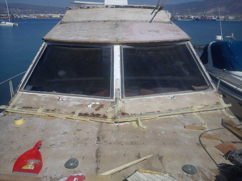

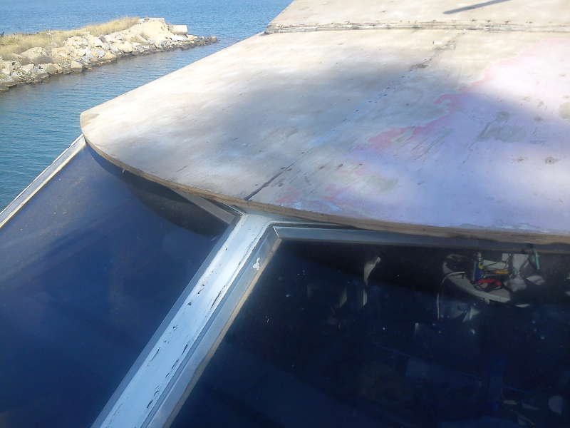

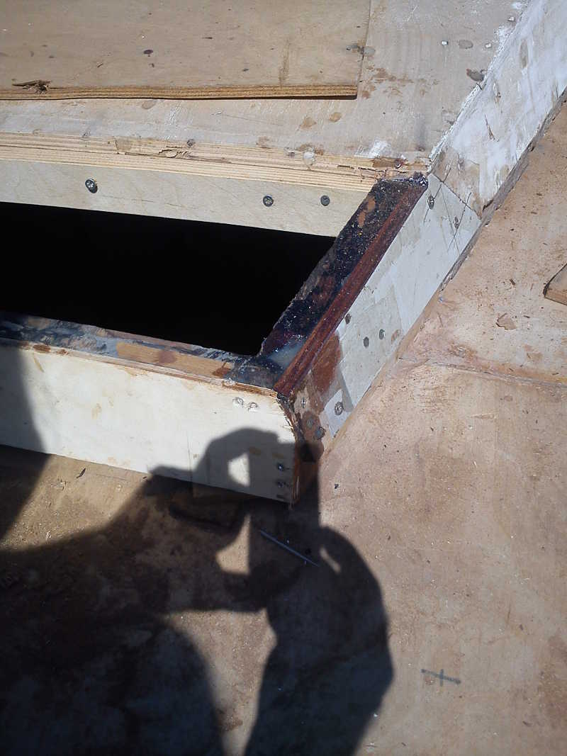

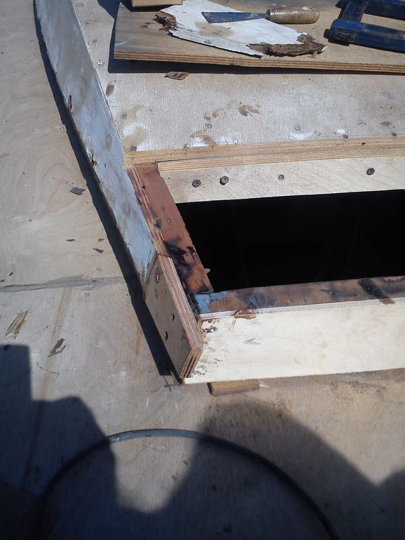

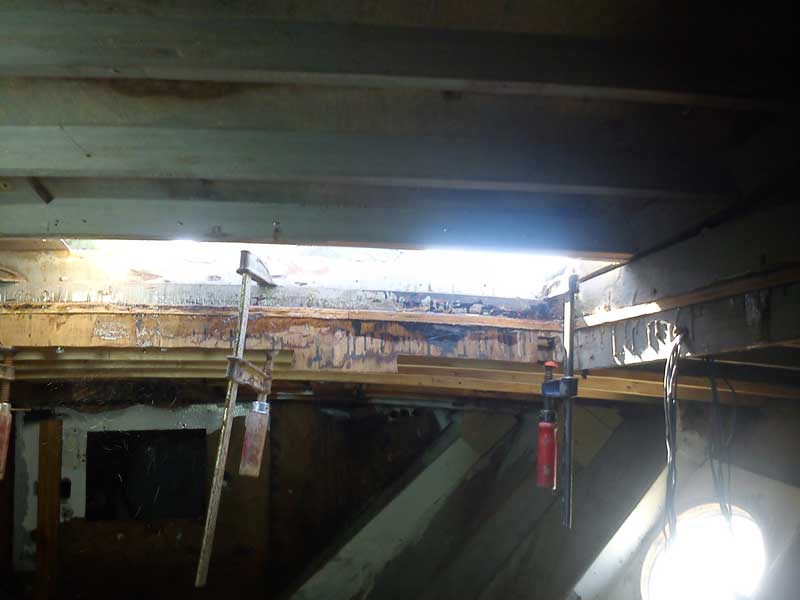

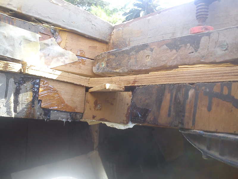

finished the flybridge patch yesterday. Straight forward no problems:
George did an interesting job in creating plugs for the 4 round holes in the sidewall (where the chunk of wood supporting the arch was bolted onto the structure). Will fill in with thick epoxy and cut/smooth next week:

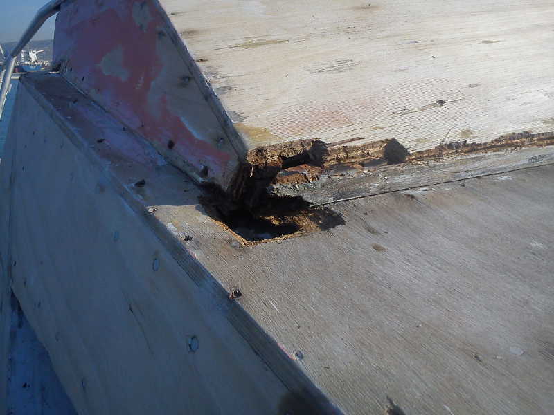

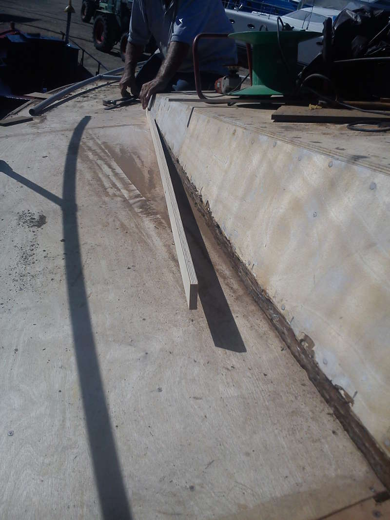

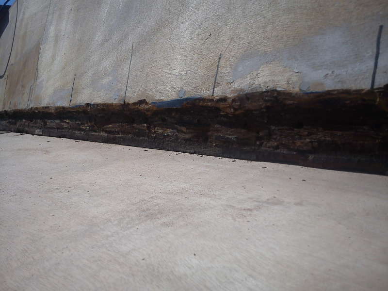

Also removed the dodgy part of the sundeck forward ending strip (where all the rain water was draining and was held by some dodgy repairs, as per usual...)

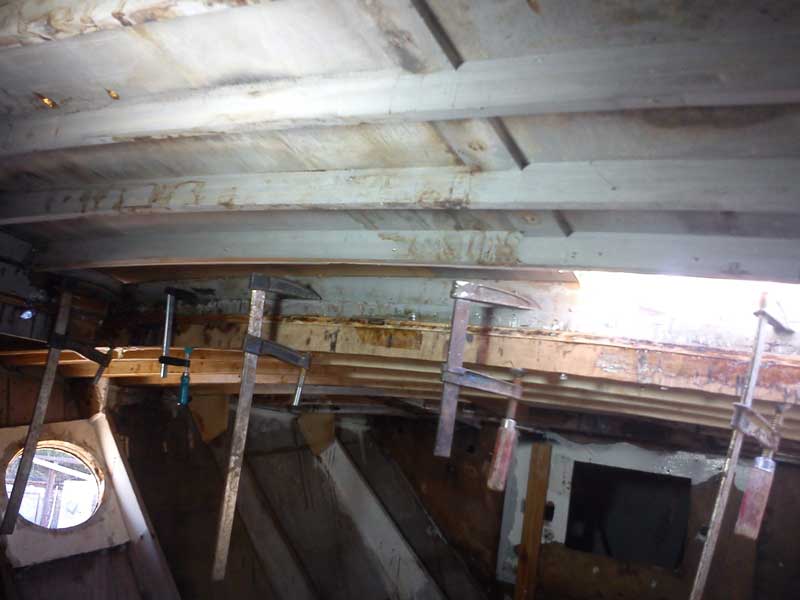

Bolted a second beam on the front of the existing one (visible in the next pic) to better support the new piece. Should be finished tomorrow morning.
Next in the immediate line of jobs are the rest of the deck work, sanding once more the sundeck filled holes, two coats of epoxy on all new deck + old stripped from paint/primer ply, strip the f/b deck from glue/primer and epoxy it. Should keep me busy for the following couple of weeks while the weather is kind to me :) 28-30max full sunshine predicted for the forecoming week. Rafiki, mind it's a bit chilly in the monring 15-17 but picks up ok during the day, typically we turn on CH in mid to end of October.

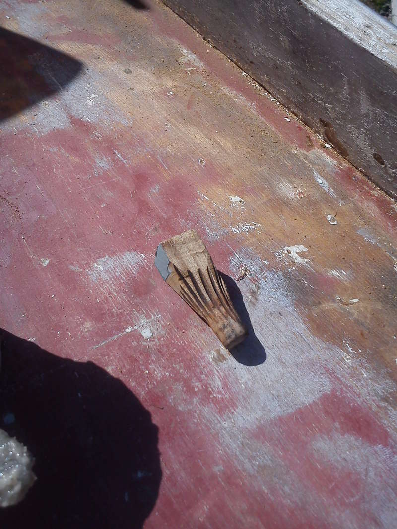

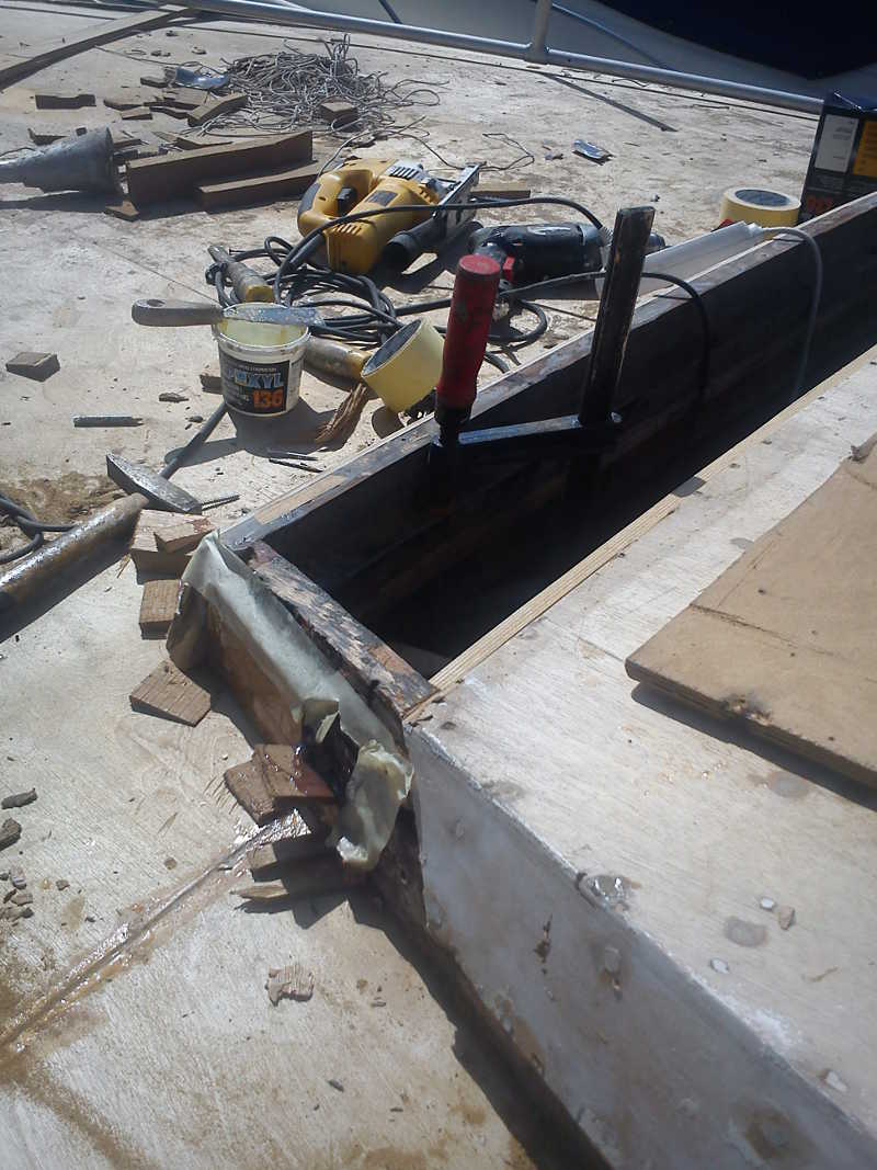

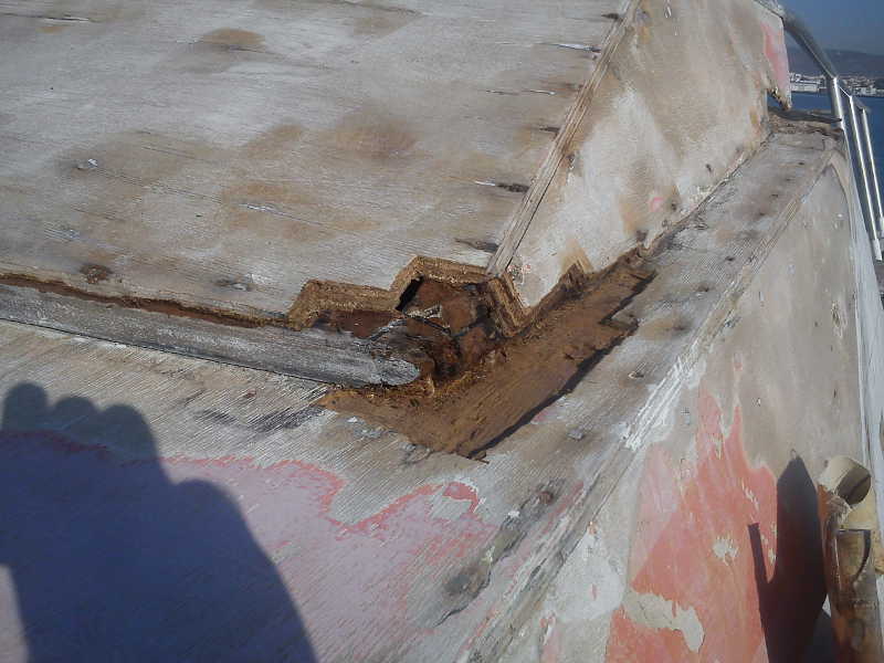

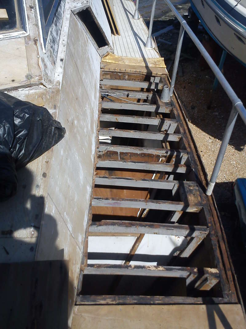

slightly slower than expected progress at the sundeck bow ending, with lots of reconstructing surgery on existing timber, various new bits glued/bolted etc. All set for glueing the 15mm ply cover tomorrow.
Unfortunately too bleeding hot today reaching 33C ffs! Was rather tired by 12:30.

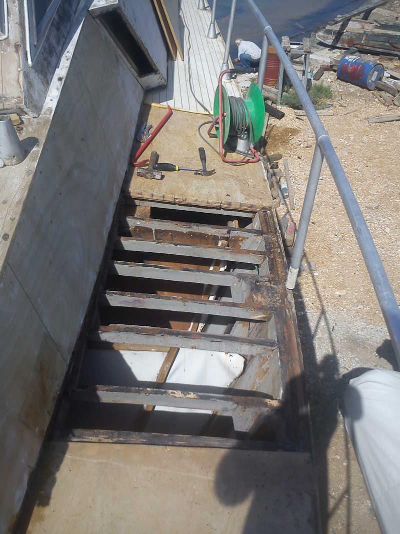

Port side deck lots of progress as the next 2m are almost ready for fitting the new deck.
As part of my experimentations, I noticed that doing cuts across the deck every 2 beams meant an awful lot of trouble and effort needed in order to remove the 3layers of old deck. And that was from 4nails and 4 screws (2+2 on each beam!) Also wouldn't come off in one package creating lots of rubbish that I had to dispose. It's amazing the strength you get along the securing on two beams. So instead of sweating like a pig and doing my arms, I tried cutting across every single beam and realised that it takes 10secs to lever and remove the strip (compared to maybe 15-20mins on the two beam assembly!). Further, it comes off in one go, minimum offbits around to pickup, so progress is much faster and I'm happier :D

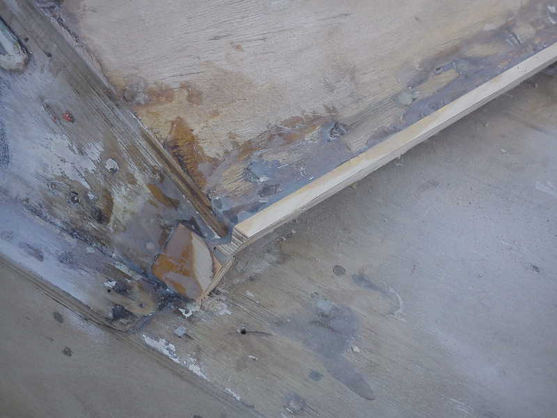

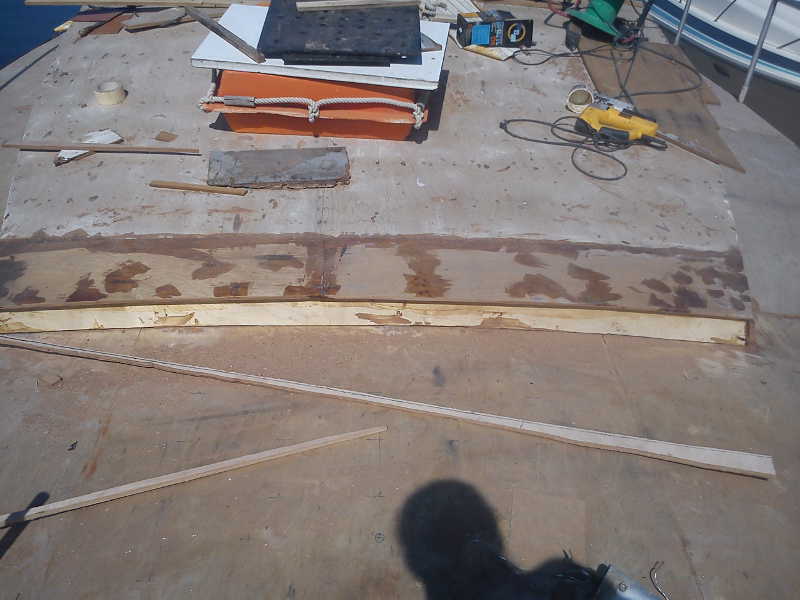

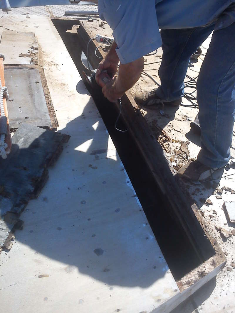

Another 4h today with the help of the carpenter managed to finish the sundeck ending. Slightly dodgy bit, as it seems that the whole sundeck has sagged a wee bit (ok, less than 6mm over 2m) but enough to make for some interesting discussion and testing with slanted supports to make sure that we get it level and doesn't look naff. Finally although we prepared the supports and made the appropriate grooves for them, we decided not to add them and glued/bolted it as is. Once I get the interior partitions shifted, I'll make sure I push up a bit the sundeck and then decide if there is a need for any extra supports.

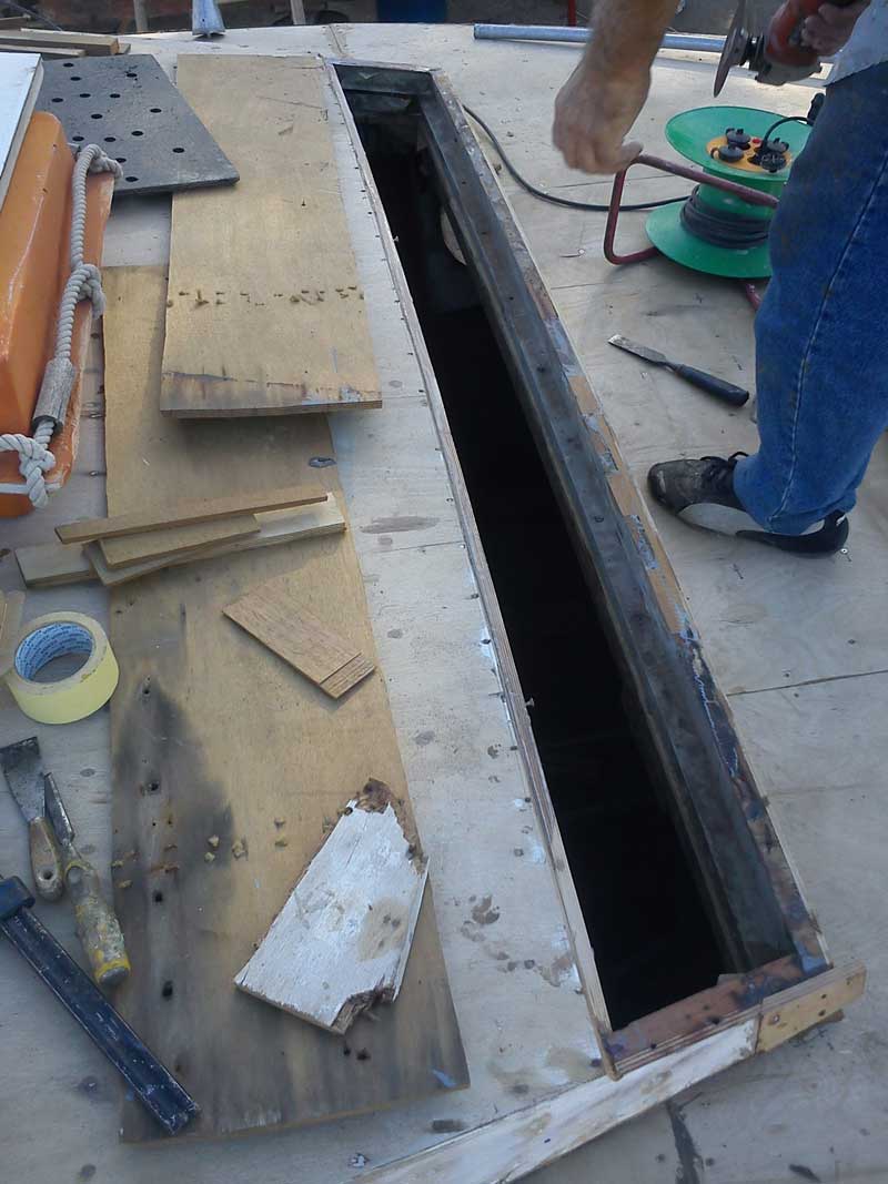

The following two pics show how the deck joins to the superstructure. Drilled 11 8mm holes for 120mm long bolts. Together with copious amount of epoxy, I recon it should be fine for another 30 yrs or so :D
I thought I took a pic of the finished article but not on my mobile, will get some tomorrow and post over the w/e.

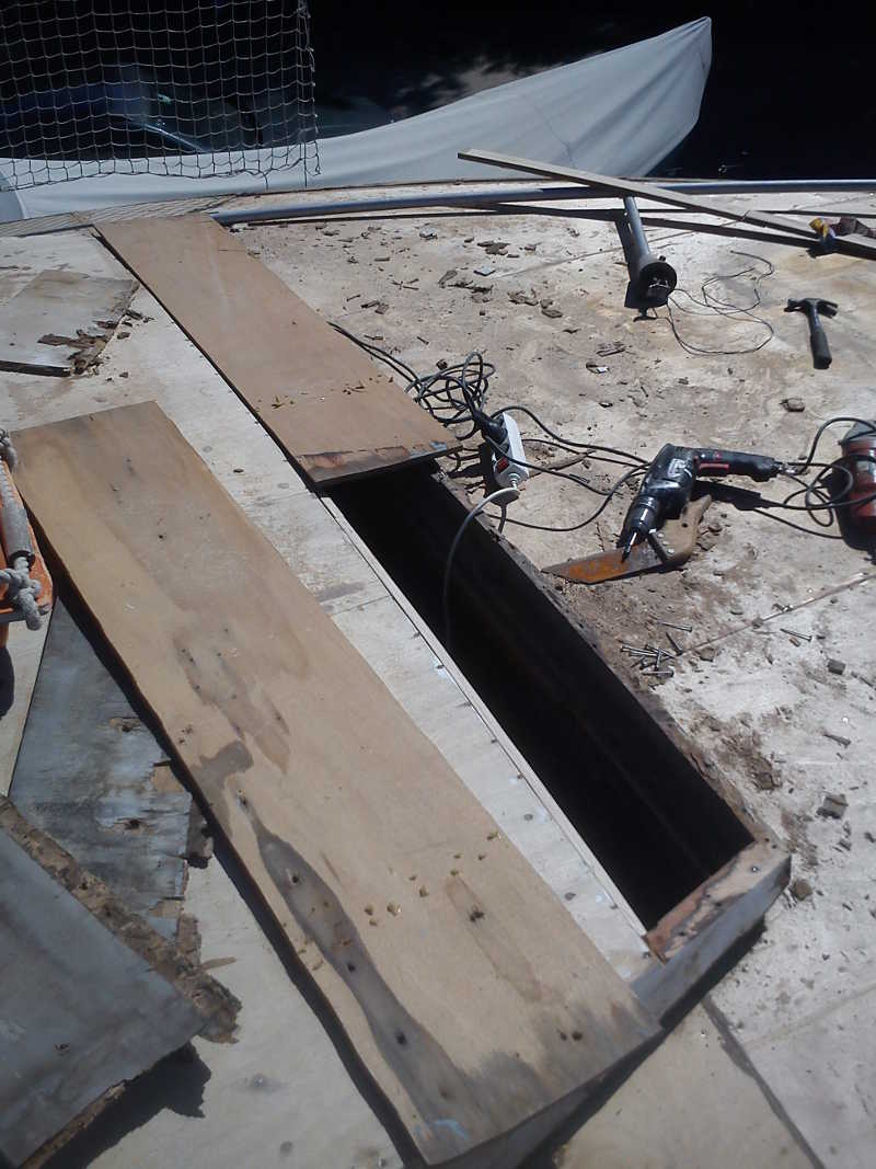

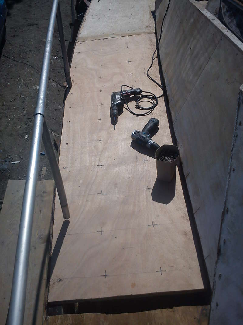

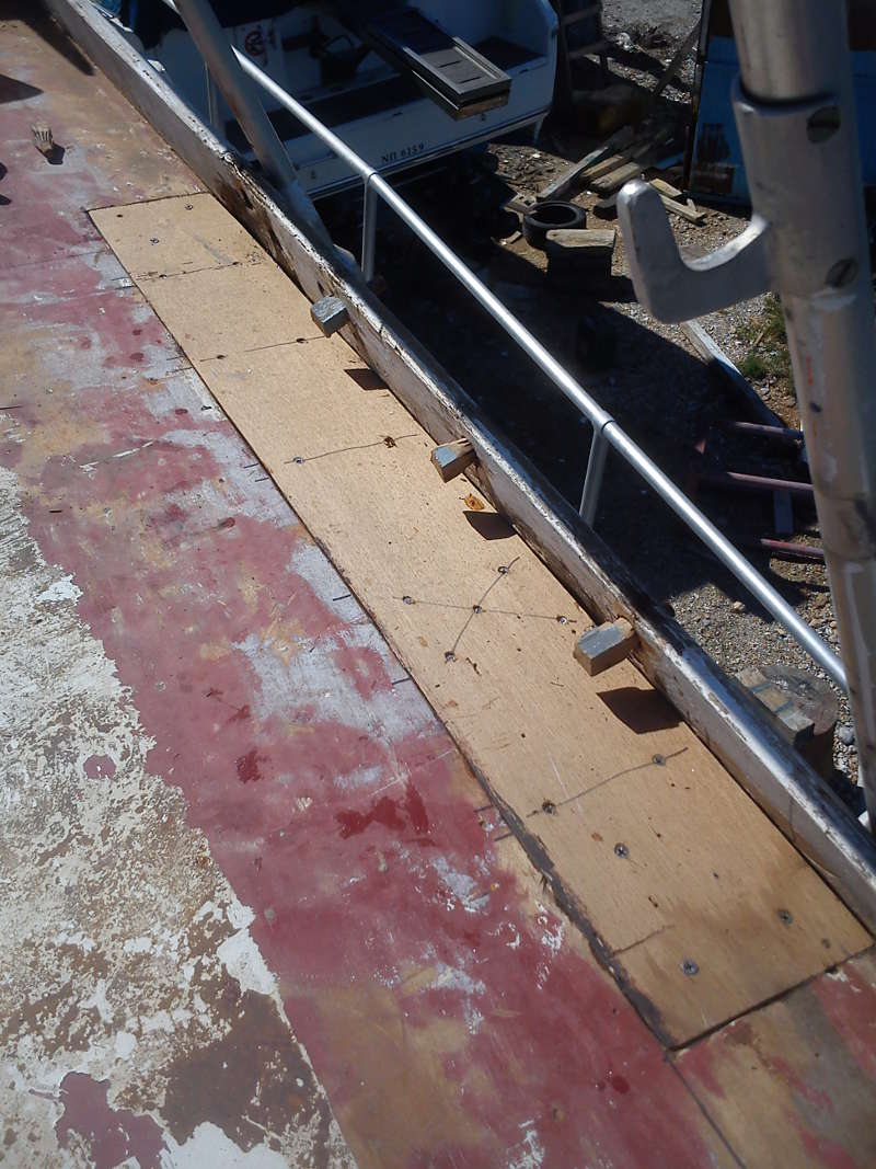

Almost completed the preparation for adding the new ply deck on the next 2m of the port side. Should be done tomorrow morning.
Over the w/e I should setup the scaffolding on the stbrd side and start working on the final 3m of the deck
(yeah, then I need the final 3m of the port side and the WHOLE aft deck which is like a strainer must had collected 50+lt of rainwater over the two days in belted it down last week when I was in Prague..

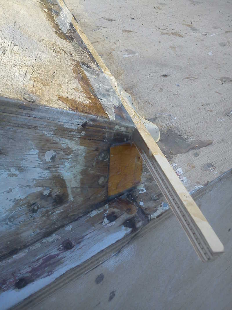

A photo of the sundeck ending towards the bow, so this bit of repair is complete:
On Friday the next port side bit was done. So now I only have 4 (and not 3 that I thought) metres of deck to replace to reach the aft deck. Things are getting tight (around 50cm width) so will be using a scaffolding from now on.
Note on the following pic the dark strip of wood (it's actually the main support beam for the superstructure) that acts as a "separator" between deck and superstructure. It's around 50mm high (will be 40odd once the teak is layed) and has a very lousy detailing so planning to "built" the top edging to the sundeck sloping sidewall with epoxy and woodchips when it's too much and add a thin strip of teak in it before the teak laying.

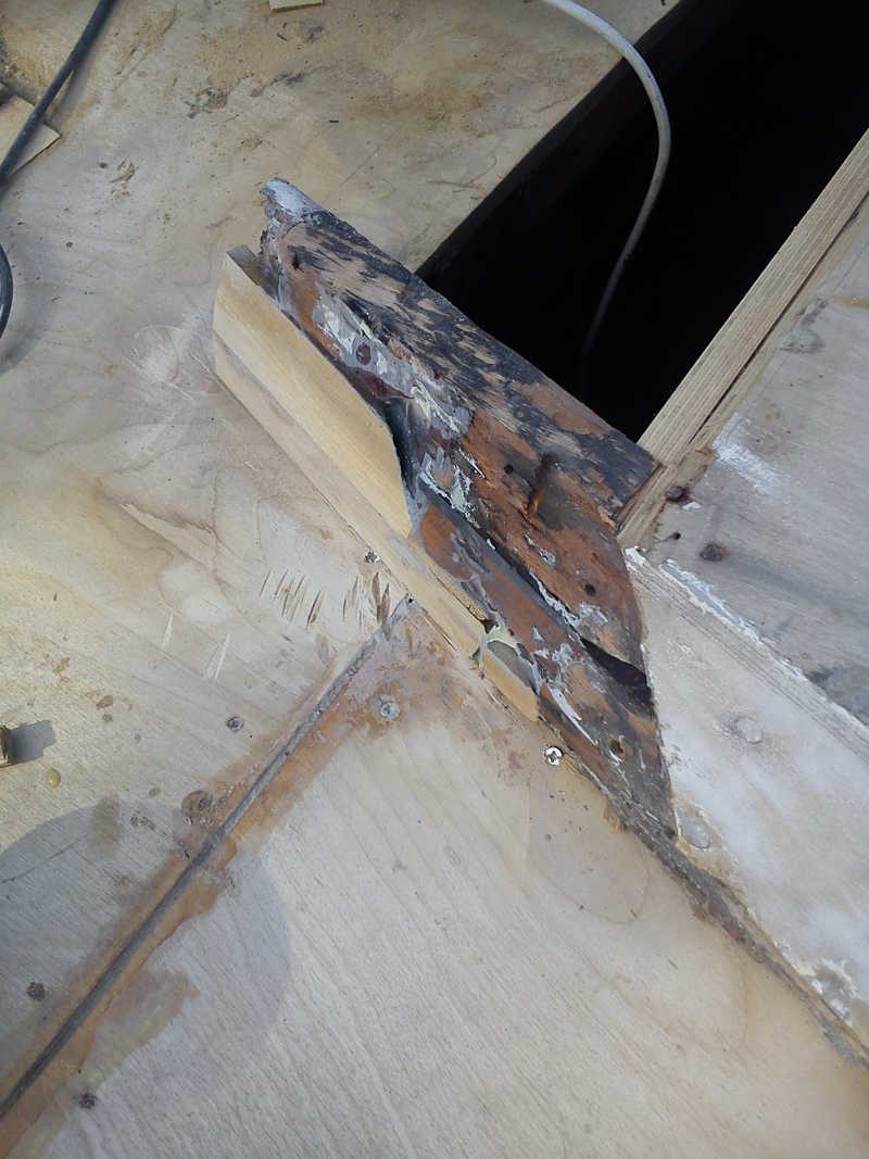

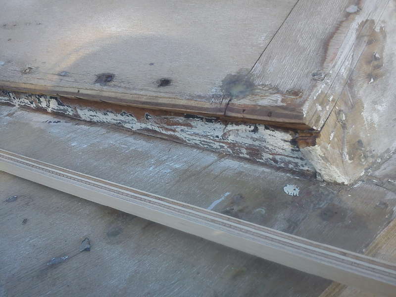

Now, the fillet/scotia/separator between superstructure and the deck had some lousy detailing to the superstructure. George made a 45mm ply strip that temp bolted onto this "groove" and filled it up with epoxy. That's test fitting this section. Today was removed and slightly sanded. Pics of the finished epoxied article tomorrow :)
Clearing the mess around the windscreen frames and helm roof, we ended with a v.interesting detail devised by George in order to remove all flaky bits of ply and recreate the 12mm ply overhang. I find it excellent and worked pretty well:
Regarding the round finish/overhang to the helm windows, we cut 10mm of it (following the curvature) and the new edge is immaculate bar two small patches that need a bit of reinforcing.
