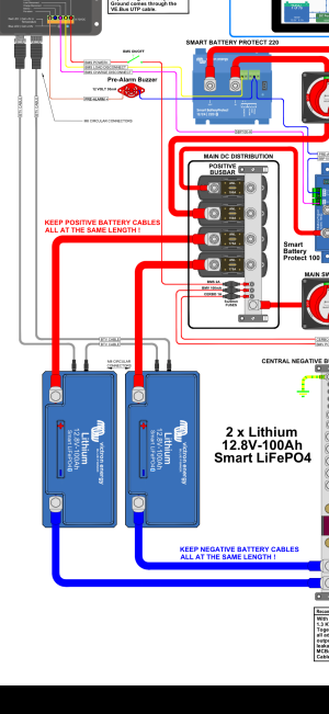

I’m just about to do the final bit of fitting the batteries, all else upgraded over the last two years, using the Chinese crimpers has been fine, just to ask all, the Victron stuff shows battery fuses at puss bars and others show close to batteries? Any comments?
As close to the batteries as possible. ABYC say 7", ok that's not a UK standard but I can't think of any reason to have the fuse any further from the battery than necessary.

I wonder how much it really matters to keep the main +ve and -ve runs the same lengths? LFP has a very flat voltage curve so there will be minimal difference between the batteries unless you are in the top or bottom 5% of SOC, which isn't somewhere your batteries should spend any time.
People have paralleled up vastly different LFP capacities, and in hybrid systems put them together with a different chemistry entirely, and it doesn't seem to cause any problems.
Perhaps the requirement to keep the runs the same length is a hangover from best practice with lead acid?
I did on my first LFP build but with my latest with EVE packs I have not bothered. All the negatives are at the same length from all the packs and all the positives are the same length from all the packs (to the mm) but the pos and neg are not the same as each other and it seems to make absolutely no difference to anything . When you think most people have things like a shunt in the neg circuit anyway which either adds length or resistance or has some other minute effect I think its more a broad stroke piece of advice from the old days .
