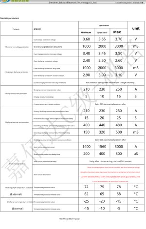

My JDB SP04S034 200A BMS will deliver (according to the datasheet);
210-250A for upto 15-25secs before a Primary discharge overcurrent protection current kicks in.
400-480A for upto 150-500mSecs before a Secondary discharge overcurrent protection current kicks in.
I have these on a 350A fuse.
I have not tested these, but have started the engine off it so would assume it can deal with engine start current spikes.
My point is that a some/most mosfet BMSes can deliver over their rated nominal current for short periods like an induction start load spike.
