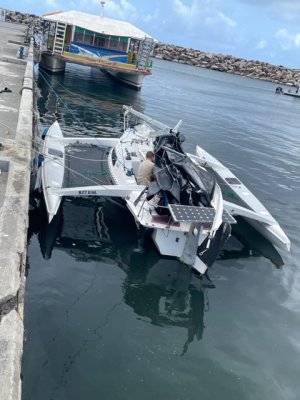

Kittrina - dismasted.

Ooops, Rum, sorry to hear. Well done on saving the crew and the boat. That will keep you out of trouble for a week or two. And you can always use the old mast as a flagpole and CCTV in front of your pool.
Best of luck. Keep posting pics.

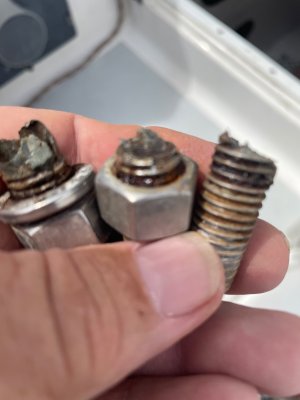

One 1/2"stainless steel nut I tried to move on a structural fitting below deck sheared off at first movement (same day another story. But it looked OK.
The ones in the pic below are from other side of the hull.
These are the bolts

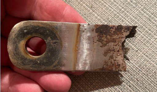

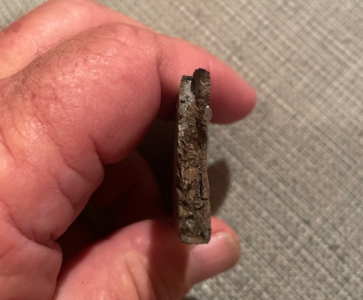

the tang in question

Same with my even older Golden Hind. However unlike many designs (such as the tri in this thread) all the chain plates are external bolted through the topsides with stainless backing plates inside rather than passing through the deck. A disaster waiting to happen unless the seal through the deck is perfect and the attachment below is not hidden or embedded in a knee or a bulkhead. Many 1970-1990s designed boats fail in this respect - and the chain plates fail through a combination of crevice corrosion and stress, just as in the photo in post#34.
Probably little to do with the quality of the material - even the best 316 is susceptible to crevice corrosion.
