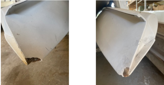

  1. Mast (+/-US$14,000.00 excl boatyard profit and labour.)
  2. Main sail
  3. Standing rigging and fittings
  4. Some running rigging
  5. Wind weather vane
  6. Mast top nav lights
  7. A deck recessed chainplate (the one that broke) - others (not part of claim) have to be checked/replaced
  8. Deck (2) fixed pulleys
  9. Hand rail on coachroof
  10. Jib
  11. Jib roller furling system (Harken)
  12. Large stern hung solar panel
  13. Stern ends/tips of outriggers - damaged in manoeuvring to get yacht out.
  14. Other small miscellaneous items
