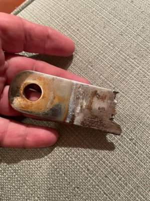

Bang. The bracket holding the folding mechanism for the outrigger parted company with the boat.
Only had 1/2 miles to a little Harbour.
Replaced the 1/2” stainless steel bolts that had sheered off - cavity corrosion.
Set off again.

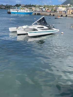

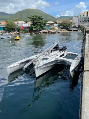

Bang, mast broke. Stainless steel Tang on the port side holding outer shroud pulled out. More cavity corrosion. ☹️
Thankfully nobody killed or injured. 🙂
Now all structural stainless steel fittings and bolts need to be removed, inspected or probably replaced just in case.

Not unusual. have had cavity corrosion on ss hull of Waverider buoy where barnacles had settled.
Took ss rudder heel fittings off a Prout catamaran. Outsides nicely polished, insides looked like a cross between Swiss cheese and wood attacked by gribble.
