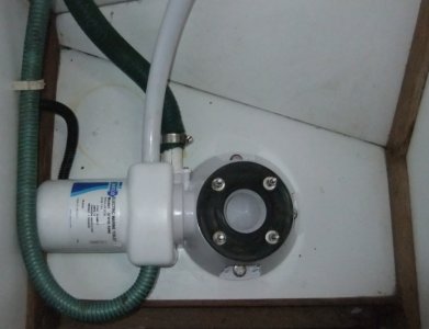

My advice to anyone thinking of converting is to think hard and think twice.
They are
Power hungry (though not normally used frequently)
Noisy, especially if used in the middle of the night.
Replacement parts are expensive.
My experience is that the motor shaft rusted through, which I managed to fix at minimal cost.
When the motor finally gave up the ghost it was cheaper to buy a complete new installation than a replacement motor (see pic in #9).
Now, when I leave the boat I turn off the inlet and flush through with fresh water fro the sink.
