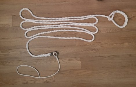

So i've gone for floating 8mm rope that is rated to excess of the anchor in line with a D/E variation. I bought 6m and then spliced both ends. The large spliced end will be looped through the head of the anchor (mine has a small bar); chose this to avoid a shackle that i'd no doubt drop the pin overboard when attaching! The small spliced end with the SS carabiner will clip to anchor chain as its fed out. The small rope (im going to modify further) will be tied to a cleat as a safety anti-drop measure whilst the carabiner is attached to the chain. Im hoping this will make the whole process easy when i need to deploy.
Can you feed back how you get on in due course?
I use a 'sinking' line with buoy tied to the amchor and I hank the rope to shorten it for depths under 10m. But am open to try these alternative systems.
I nearly always use it. One of the few times I didn't I picked up a massive old rope about 4 inches diameter which my winch managed to raise and I could free the anchor.
