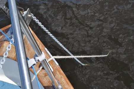

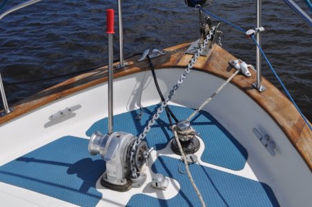

Sounds to me your overdoing it,, use the trip line for what it does and trip the anchor if it snags up.
I simply attach the trip wire to the anchor (CQR type) and send it out with the anchor, saved me many times over the years
