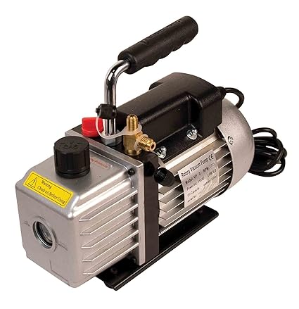

Just one point to add, the pulling of the vacuum is not just about removing air it’s about boiling off any moisture in the system, your old compressor will not pull it down into a low enough vacuum but as most systems are small and boat air dry you could get away with it. I pull about 4 torr or below vacumn to commission which is nearly -1 Bar.
superheat6k
10 Jan 2012
6,715
South Coast
+1 - we work on larger systems at < 5 torr, but let's not split hairs eh. I reckon this old compressor at best would achieve around 100 torr vacuum. Not much moisture flashing off there, then the user wonders why there is reduced gas flow and utterly fail to understand the effect of moisture frozen at the outlet from the capillary, but does note the frozen plate, fully charged system and no leaks.
I have a proper vacuum pump, which was £70 from eBay at the time (plus pump oil, which wasn't included). Bit heavy to sail around with, but turned out to be quite useful, as you can use the same pump for vacuum bagging/infusion and I've also used it to remove moisture from inside our rudder :)

Will add that it’s not possible for a valve compressor to pull down that far due to leakage on each valve stroke, vac pumps are rotary vane for that exact reason, you professional gauges will not read accurately in low vacumns that’s why we use a Torr gauge. Just for reference it still is my full time job and has been for over 30 years
superheat6k
10 Jan 2012
6,715
South Coast
+1 if we could all use an old compressor as a Vac pump believe me we would. But Vacuum Pump Oil is snake oil in its finest form. You can use basic engine oil in a vac pump without any problems at all (not in the fridge compressor). The big issue with fridge 'kits' is the quality of the joints, always. Brazed joints are always superior, but pre-charged units will then require a vac and regas.
