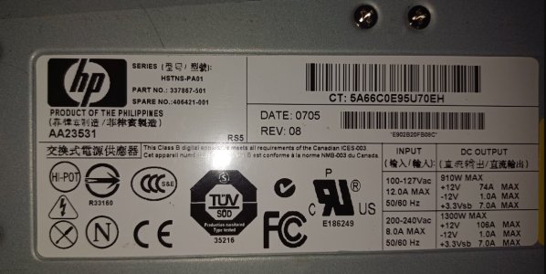

just thoughts ... many modellers convert PC power blocks into high power 12v PSU bases ... I have two HP units capable of up to 1300W ...
Its an example .. and I know its not marine grade / proof against marine environment ... pity ! It could just about power everything !!

William_H
28 Jul 2003
13,989
West Australia
That HP computer power supply would be very good but I think you will find the 12v output is just that. Exactly 12v so not much good at charging a battery. Ok if you connect fridge direct to PSU but put abttery on line and battery will supply all current until it is down to 12v. Of course you could get 15.3 volts if you connect from the -12v to the +3.3v but then limited to 1 amp. ol'will
