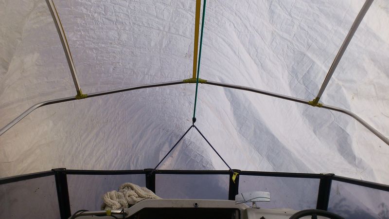

Well, finally some dry days. Spent some time last weekend figuring out the frame for the camper cover and fixing up a temporary extension to it to hold up the tarpaulin and withstand the weather.

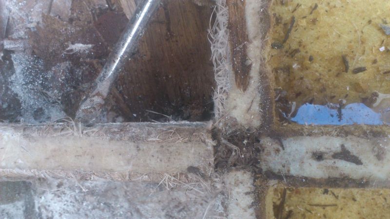

Cross section of bulkhead - the black area to the right being the engine bay and the left half the starboard floor stringers. The original was 9mm ply, but I intend to double this given that the bulkhead is only half-height (top half being formed by rear seat to facilitate engine access).

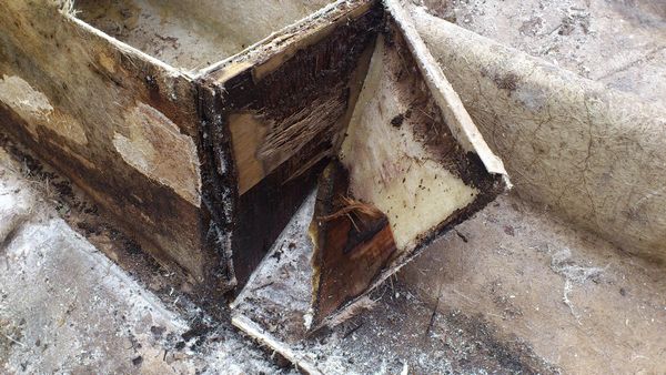

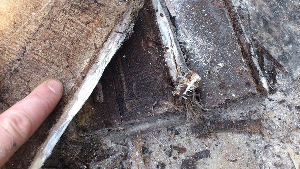

Having started to cut away the stringers from the aft end, it became apparant that although solid but wet higher up, the bases had largely rotted away.
Cutting down each side and then breaking away seemed the best means of removal - although solid, this wood was so wet that the vibration of the cutter caused liquifaction - with water oozing from the surface!
Method used was to cut through the base of the fibreglass (into the stringer)...
...then up the sides...
...and finally, decapitate from behind!
Once cut, a screwdriver prys up the fibreglass...
and pulls away from the stringer.
A bit of cleaning up, one side removed.
Both sides cut out enough for grinding back and glassing in new bulkhead. Note that the 1" protrusion of the engine bay carriers has also been removed at this stage. These will be replaced anyway and new ones glassed onto the bulkhead, but not through. Additional bracing at either end will compensate for any reduced latteral rigidity.

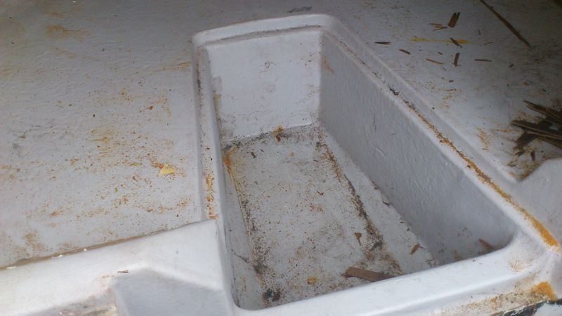

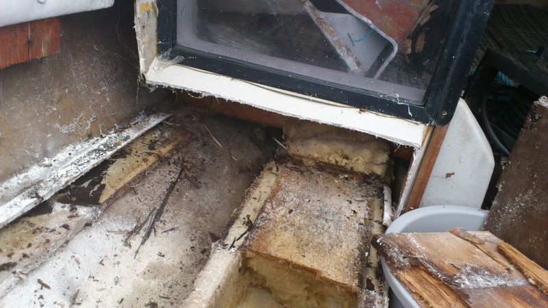

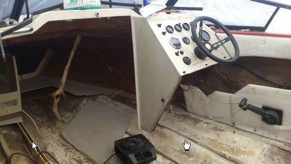

The problem with the cuddy is obvious in this next picture. Although the ply floor ended just past the threshold, the stringers continue forward - as does the buoyancy foam - complete with it's water...
Interior removed, cuddy floor looks solid and being fibreglass only (no plywood) you would think ok...
However, having decided to remove I thought I'd best keep the moldings for future reference/reuse!

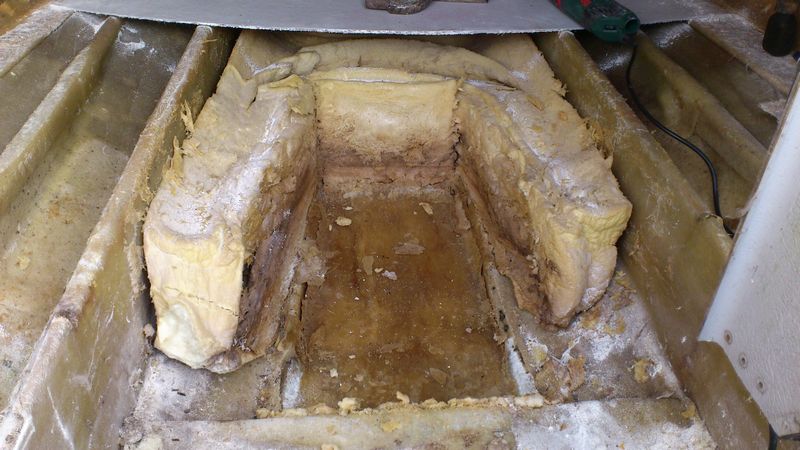

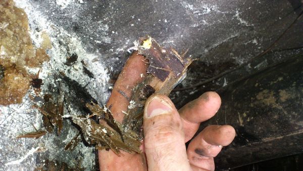

Below the sculpted recess was wet - VERY WET!!!
...so much so that it was a suitable habitat for a stowaway worm! :eek:

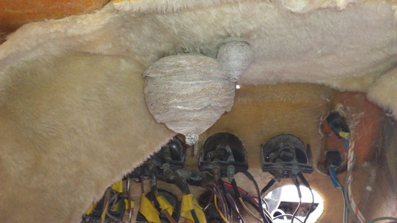

However, the stowaway prize must go to these fellas who had obviously made home between the back of the dash and the cuddy bulkhead...

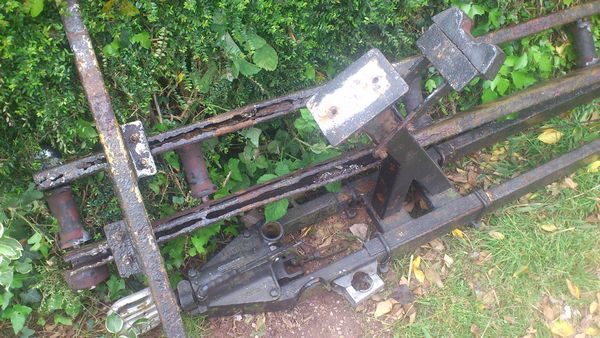

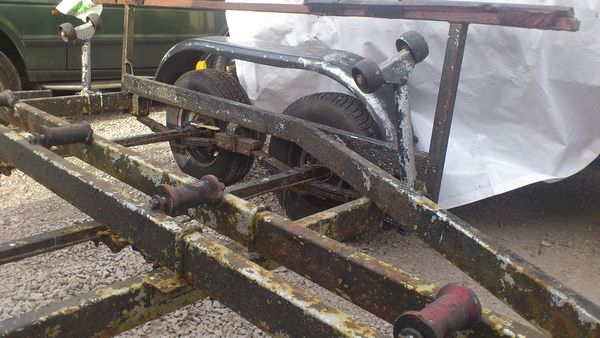

The first distraction has been Charlie (the 14' Arrowflyte) and her trailer needed a major refurb - new rollers, repaint etc. Charlie needed a good clean, new throttle cable, fitting of transducer for Lowrance Elite 5 (Going to use this between both boats!) and some emergency repairs to her seats (Duct Tape!). Charlie will be refloored, re-trimmed and new gel coat after the Arrowbolt so just need to limp through this season I hope :rolleyes:

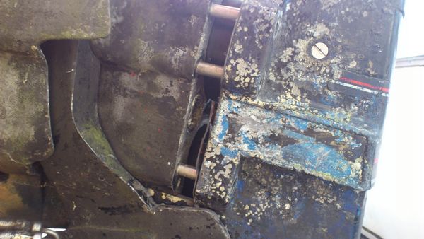

So that's why that didn't work then... :)

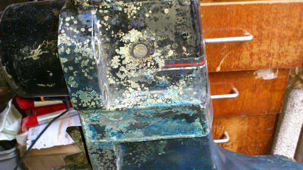

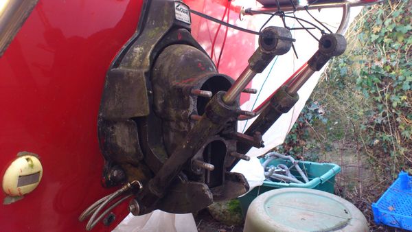

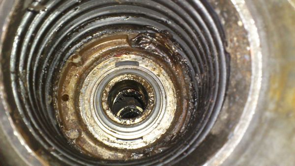

It's an Alpha One Gen One, but not much chance of finding a model number I fear!
A bit of a clean up needed here.
Probably a bit more than a buff-up with a wire brush too... paint stripper perhaps?

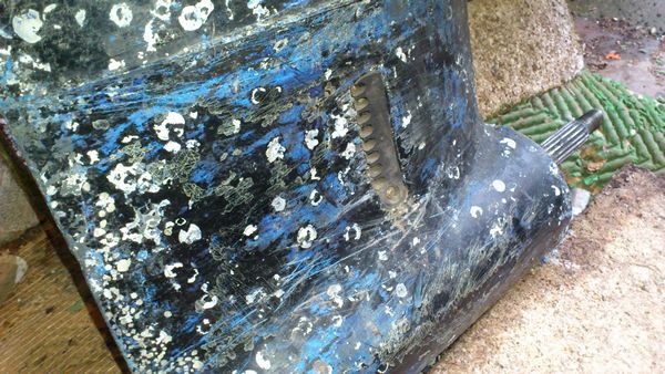

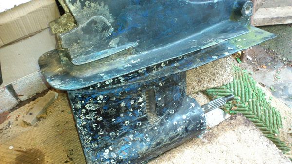

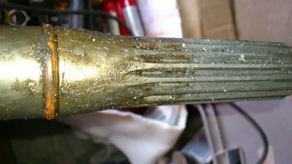

Splines ok - Prop end...
...and drive end.

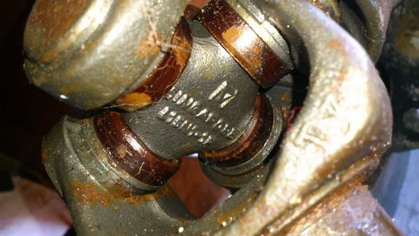

Nowt more than a bit of surface rust on the UJ.

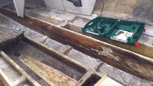

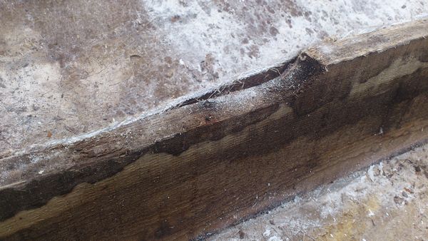

Having made the decision that although they seemed solid, the stringers would be replaced not patched or joined, I removed the facing fibreglass and proved the decision was justified! Now removed the forward starboard side and will hope to do the port side and what I can of the aft sections tomorrow/during the week. There will be a few days of cleaning up and cutting back the excess fibreglass to do and some extensive cleaning before the reinstatement phase beings... :)
Much of the afternoon was spent labeling cables, removing engine ancillaries and removing the last of the rotted plywood and buoyancy foam in the stern section. Once the rest of the stringers are out, the gimble housing, transom shield and engine will be the next to remove before the transom itself is removed via the inner skin (the outer flibreglass skin will be left untouched to maintain structural shape)
One thing is now certain - 20kg of resin ain't nothing like enough... :rolleyes:
Facing layer of fibreglass removed
...and simply fold forward to remove...
It almost made it one piece but literally fell in half!
Not much left of cross sections.
Outer stringer - not quite a bad.

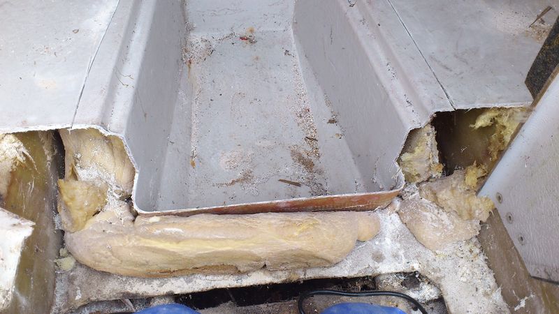

...and on to the engine bay...
Starboard side opened up.

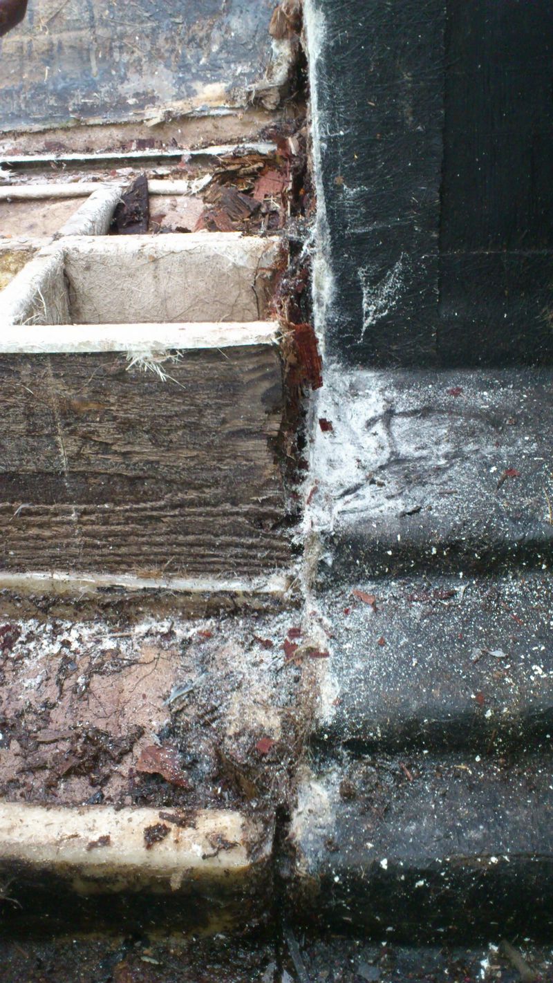

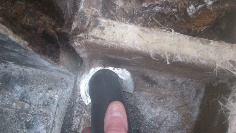

'Wood' from transom...
Are you supposed to be able to push finger into transom? :)

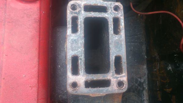

Manifold looks ok and water jacket seems clean.
Riser in good nick...

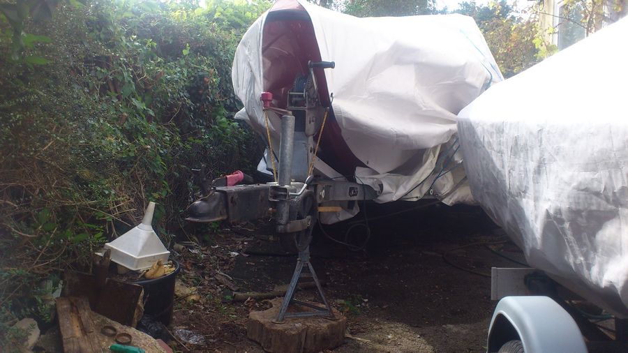

Progress currently a bit slow due to work, getting ready for June rally and because I really need to lift engine out now. I think progress will have to halt a short while soon whilst I source and rig a lifting mechanism! I'm currently working on the theory of a gantry, block & tackle plus a scaffold to resite the motor... :rolleyes:

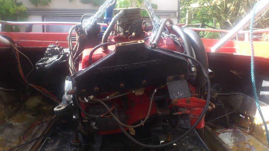

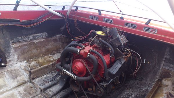

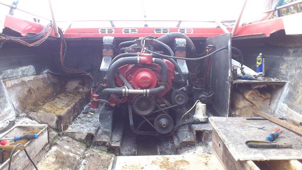

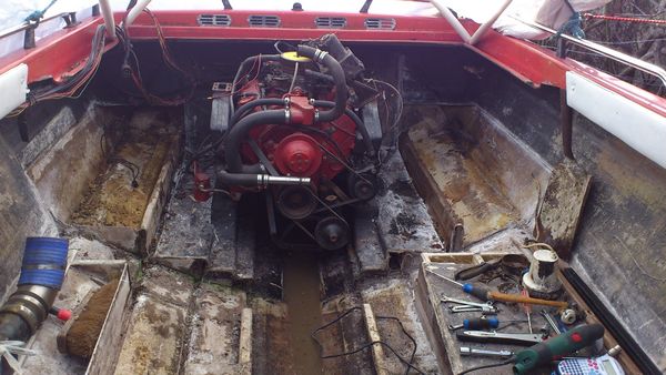

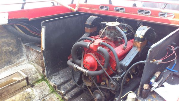

Most engine ancilliaries now removed (and lots of notes and photos :D) - transom sheild, steering etc next...
Engine's looking a bit smaller now with a bit of 'free space'!

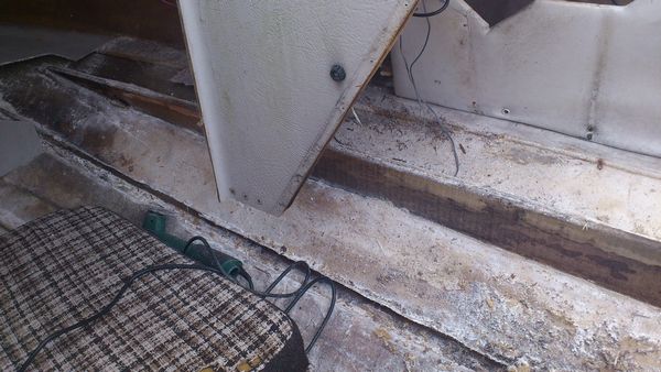

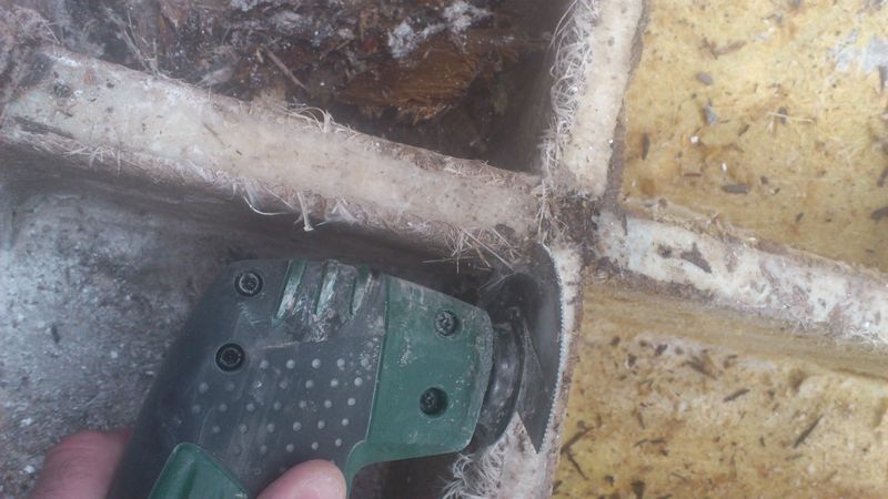

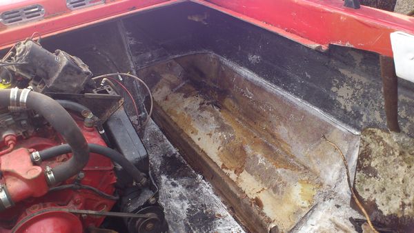

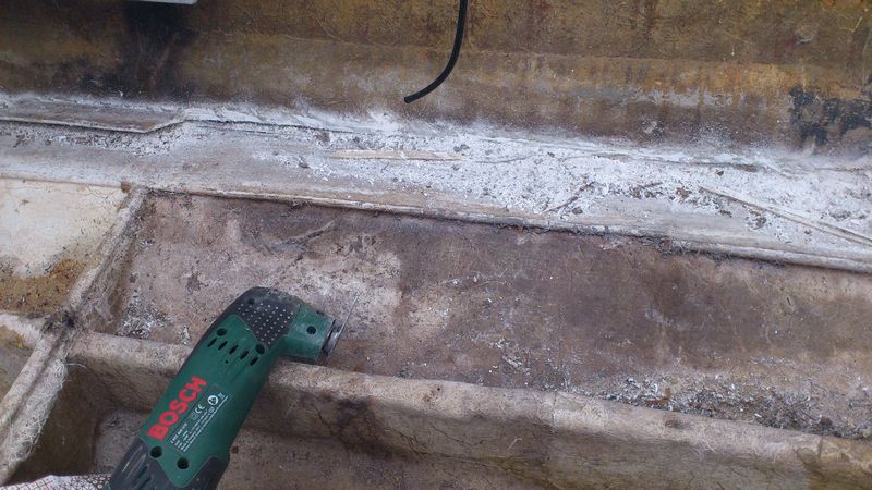

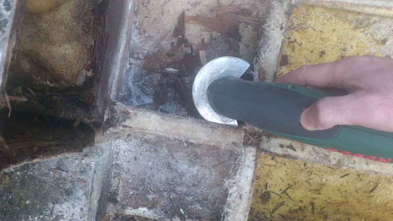

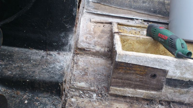

I have been cutting back the tabbing (hand pointer) and stringers now removed (arrowed)

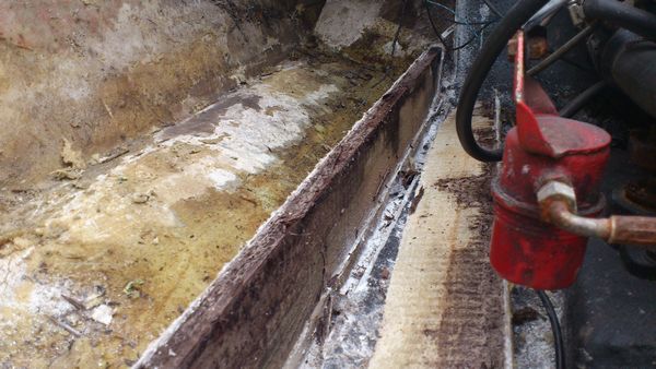

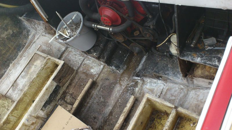

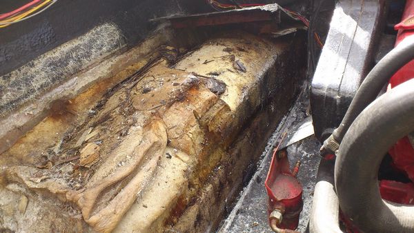

Exposing the engine bay end of stringers:

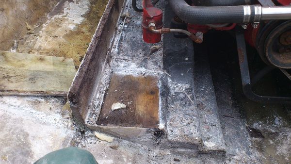

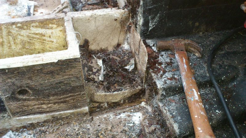

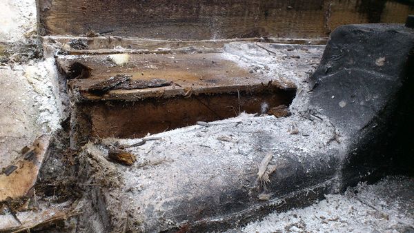

Engine bay 'floor' (these are ply sections created for level space either side of engine)

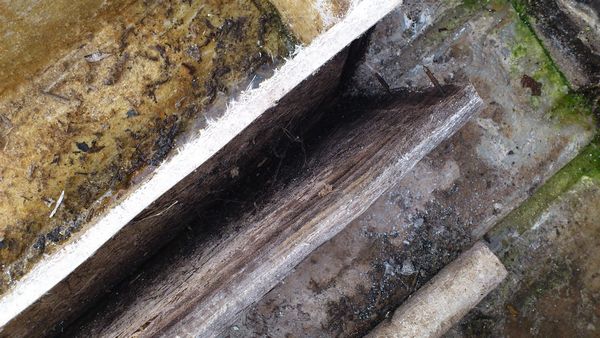

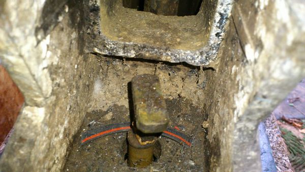

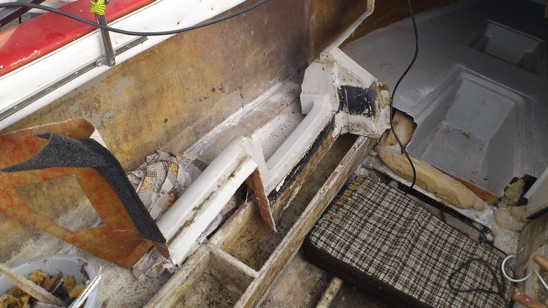

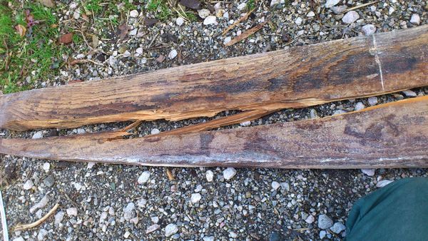

Engine bearers :( Actually more solid than they look, but like stringers very wet!
:cool:
If the wood is really wet you have 2 choices, chop it out and replace, or tent it off and dehumidify (prbly cheaper and quicker).
Thanks Ben, I've opted to remove and replace. Whilst it will add a few hundred quid to the project, at least I'll know it is 'as new' when I finish :D Whilst most of the stringers were still solid, the base of area's had rotted and all of it was soaked - much of it starting to blacken/soften. That said one of the largest sections split in two when removed so best out IMHO.
Not yet decided on timber to use to replace, but Iroko or Sapele seem to be top of the suggestion list so far, with Meranti also suggested. I'll need to establish what is available locally and go from there I think. With all the marine ply, I'm expecting to accrue shares in the local merchant :rolleyes:
For those sorts of jobs I wouldn't pay the premium for Iroko (and it'll be tough work by comparison), Sapele or Meranti, not much to choose and both fine for the job.
The plywood, buy BS1088, far eastern will be fine, you dont need to pay for Robbins elite!

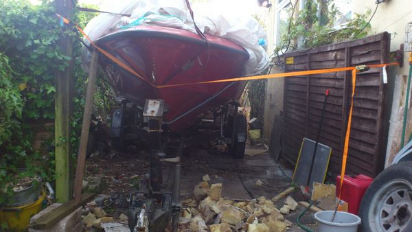

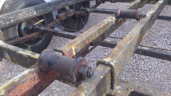

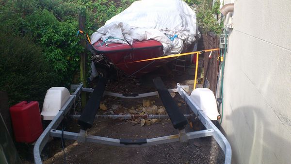

Biggest cash outlay was a new (to me) trailer at £550. The old trailer could have been repaired, but aside from repair costs that were looking close to £1000, the original wasn't galvanized and was in fact rotting from the inside out. It was also heavy - weighing in at around 550kg by my approximations. The new trailer needs some work, but this is largely just a brake overhaul/adaptation (hydraulic), addition of some keel rollers and raising of bunks (new brackets).
The single axle will also make rotation in my driveway easier (road too busy/gateway too narrow to reverse in routinely). Now by this point you're probably wondering why I replaced trailer this early on in the project, but there is method in my madness... First a foremost one came up at a sensible price, it had a much lower keel position (over a foot lower) and was easier to move in the confined 'project space'. The latter two were important because they will facilitate the engine removal which is the next step - see below. However, I'm also looking to keep options open on the repaint and if I decide to take to a spray shop after preparation, I'll need a roadworthy trailer!
New(ish) wheels...

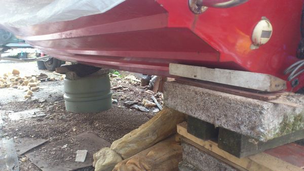

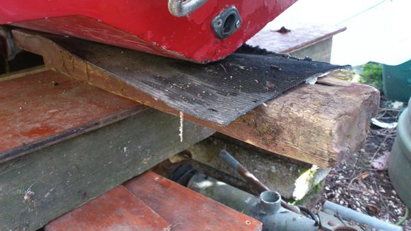

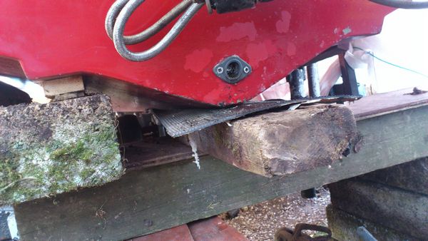

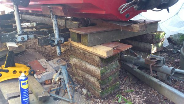

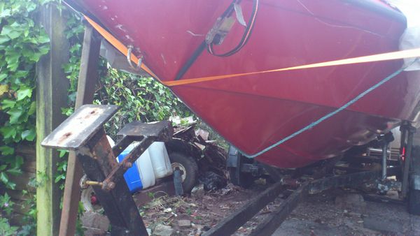

Boat (ahem) 'lifted' to remove old trailer and swap... (stern on blocks - H&S look away now!)
Ooh look - no wheels :)
Hrrmm - a bit light on the nose wheel!
Old trailer out.
Job done!

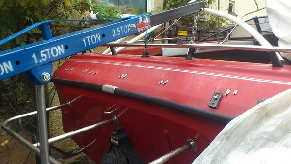

Load test complete - weight on hoist. Temp lift for now as I need to remove swim platform and move hoist closer to facilitate the lift prior to pulling boat forward.

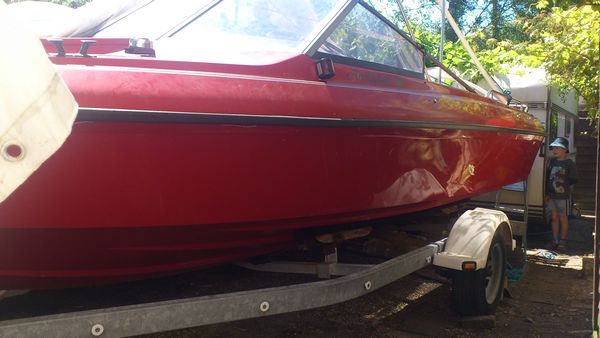

Last of all, a quick reminder what all the efforts are for...

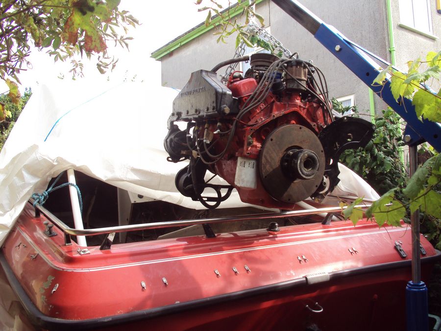

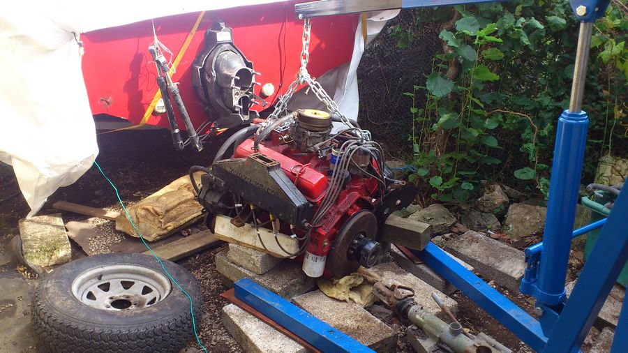

Engine finally out yesterday prior to the arrival of current weather front - it's been rather grim out there today!
The screws on the swim platform proved harder than expected and having blunted two further 'hardened' bits (carbide coated), I drew a blank. I didn't want to damage either the SS frame of the platform, nor the outer skin of the transom however. As luck would have it, I got some carbide tipped (not coated) bits from a guy at the boat show however and he demonstrated them drilling concrete, steel, ceramic and wood. Sure enough they made short work of the hardened screws too. :cool: Once the swim platform frame was removed this enabled me to get the hoist far enough forward for the engine to move forward on lift - necessary to clear the stern section of the hull. To get sufficient lift, the process involved removal of the hoist wheels and raising it on blocks too (H&S look away!) - but I did also strap the legs of the hoist to the A-frame of the caravan that it was straddling in order to improve stability. Once the hoist was at full height, it was still necessary to lift the bow of the boat and walk it forwards to clear the engine before the latter could be lowered. None of this would have been possible with the original trailer. All now covered pending the next work-less, dry day when I can hopefully relocate the engine to workshop and also recommence work removing the last of the floor, engine bearers and transom.
Then the restorative work can begin in earnest. :rolleyes:
Following many discussions with others who have done it, I'm almost certainly now looking to use a marine paint rather than gel-coat for re-covering the hull. This is in part down to cost, but also faith in my ability to do a good job and get a decent finish. I have sprayed before and although I would have to tool up for this, the hand application of gel-coat seems likely to be fraught with problems. Once the transom is replaced, painting may well be the next job - whilst the hull is relatively light and I can use the engine crane to flip over (i.e. before re-fitting the floor)
Anyway, here are the latest pictures of the ongoing chaos... :)
All disconnected and ready to go.

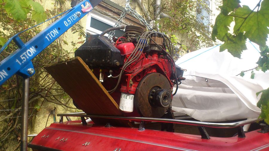

Up she goes (The old lump of chipboard there to prevent a spin as I'd rotated 90 deg to help clear the stern.)
A bit of extra height needed at the stern end.
A few final adjustments - should just clear...
Boat moved forward - a few inches at a time...
Engine out at last - next destination the workshop. :D
Well done. That did not look easy, especially with the access for the hoist. Reminds me of removing the engine from a Mini. Disconnected the front subframe and ancillaries, then 2 of us lifted the body over te engine.
