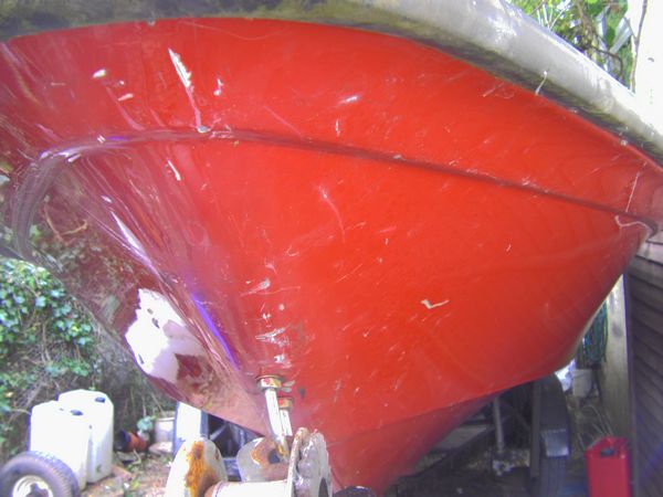

Sent prop off for a refurb, but suspicions on condition confirmed - too electrolytically corroded to repair. Old prop was a 17 pitch, which also seemed a bit course, so now have a new 19 pitch (not fitted yet).

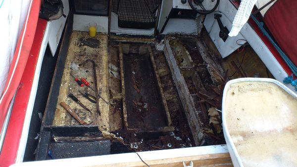

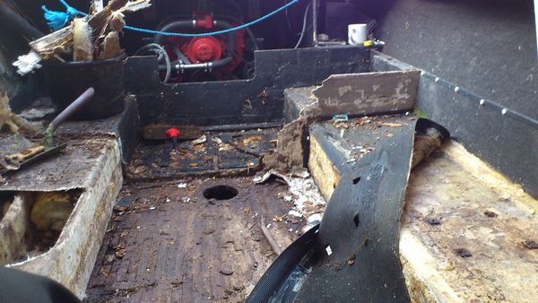

Have today started removing floor and bulkheads...

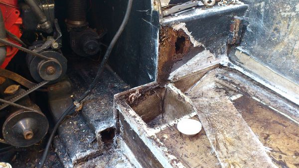

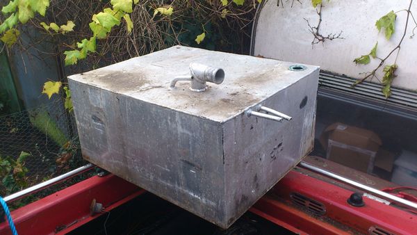

Tank out and in good nick fuel gauge wasn't connected so need to run new wires and perhaps fit new sender. Have removed old one and will test tomorrow.

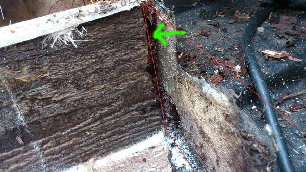

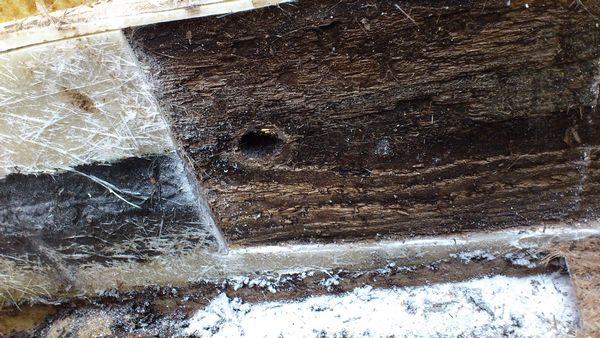

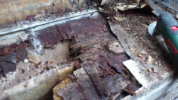

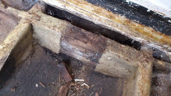

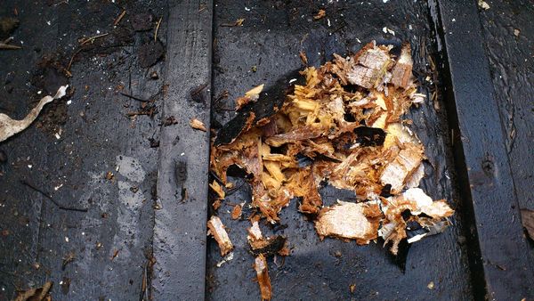

Removed top layer of starboard floor (seems to be two!), much wetter than expected! Removing fibreglass base layer and then lower floor - also rotten. Stringers appear solid, but will probably cut into fibreglass covering of them to confirm this. Will then either replace or re-glass as required. New floor will be glassed before fitting and then glassed into place.

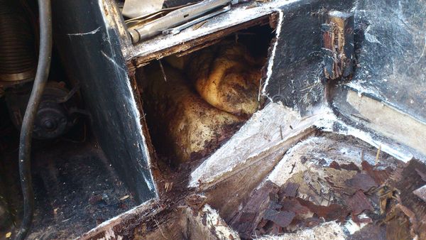

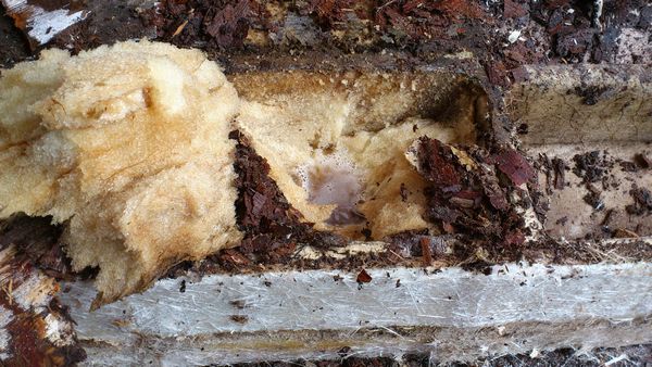

There is some buoyancy foam between stringers, but this can be wrung out so won't replace! Contemplating plastic balls or similar as an alternative!

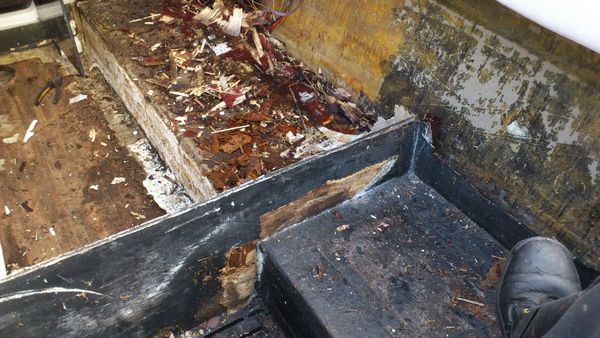

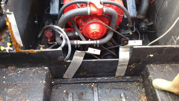

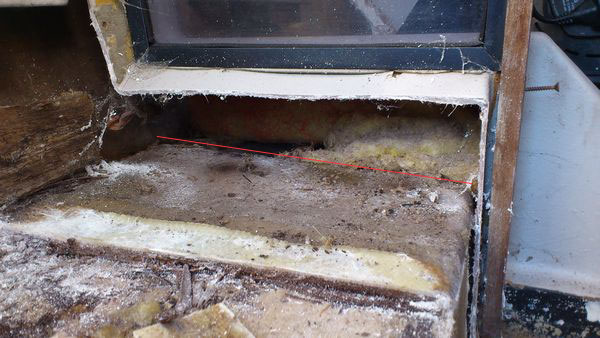

Rear seat and fuel tank removed.
A layer of paint hides a multitude of issues...

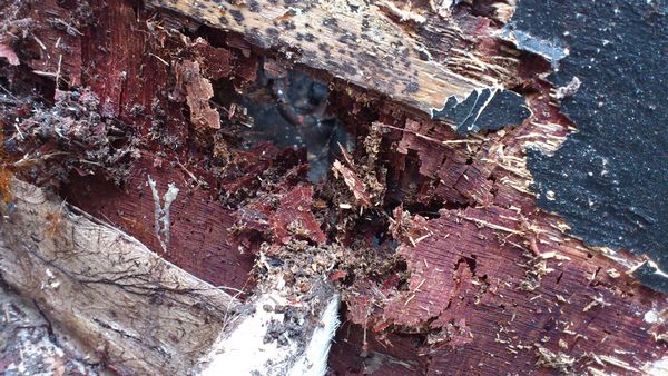

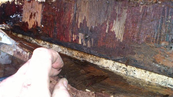

The light coloured wood has the texture of cottage cheese! (removes with fingers)

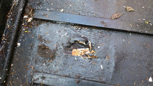

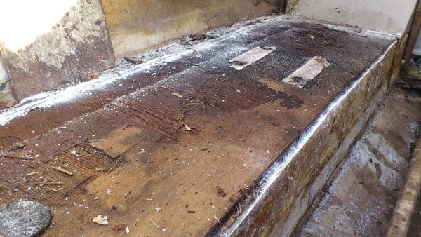

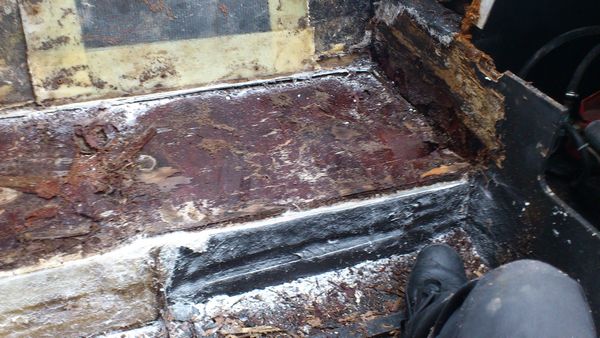

Starboard floor doesn't 'look' that bad - just a coule of soft bits...

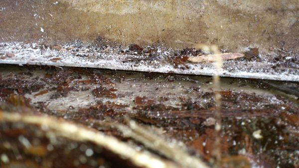

However, knowing what lies beneath prompts some digging! Lifting away the fibre-matting...
First layer of 'floor' gone, also started to remove tabbing from bulkhead - I want to use as a template so hoping to remove complete.

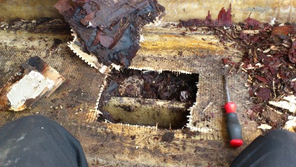

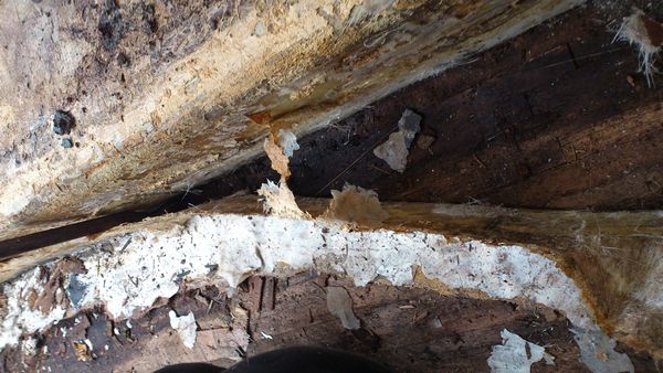

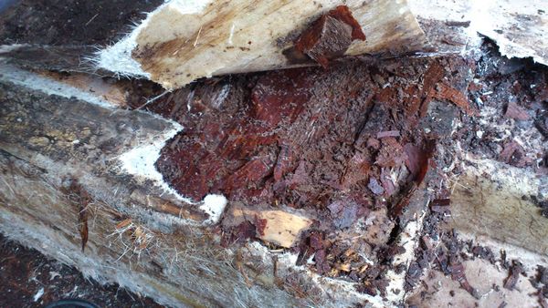

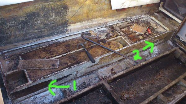

And so on to the underneath layer... Bit harder going now as much more fibreglass. I think this is the original floor - top seems to be a later 're-inforcement'...
More tomorrow if it goes to plan and perhaps an idea on the condition of the stringers...
