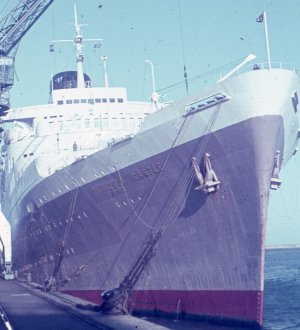

It's basic procedure, or at least it once was, for a merchant ship's mooring ropes when sharing a Bollard with another ship's mooring ropes.
Not just when sharing with another ship but also sharing your own lines on the same bollard - an old day job seen here in Port Elizabeth. Probably not the best example as the port authority supplied big coir 'tails' to absorb the surge in that port but you get the idea.
Speaking of surge - about 10 years ago I left the boat in Antofagasta for maybe 4 months. Multiplait nylon spliced eyes ashore. The heating caused by the load coming on and off over the time essentially melted the nylon and hardened the eyes. I could have used them as knobkerries.ships003.jpeg

Ha! I was in the Rhodesia Castle. That photo brings back memories and the old Ports.. Mombasa, Beira, Mozambique, Lourenco Marques, Zanzibar on the way to Durban, PE and others. Those Coir tails weighed a ton when they were wet, and when the strain came on them they shed water by the gallon! :)

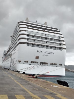

We are anchored off today. I will hopefully get close enough to take and post a picture when we disembark back alongside tomorrow.
Complete with rat guards....

Just to clarify one point. All ropes stretch even FSWR, it's just a matter of how much. In the lengths used on yachts there is no effective stretch in old halyards etc which is why they can put heavy snatch loads on deck fittings. Big ship ropes made of much the same material will have enough stretch due to size and length to be fit for purpose.

Steel hawsers used for towing have the same properties I understand.
Have seen them used as dock lines on submarines too. The synthetic ones used now are far more popular with the casing party.
