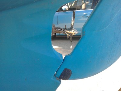

Anyway you have what you have and suggest you talk to Chris Hares at Darglow for his advice as to the best way to go. He has done 4 props for me over the years and knows his stuff. The photo is the latest. 17" on a Beta 30 with a PRM 2.5:1 reduction box.
