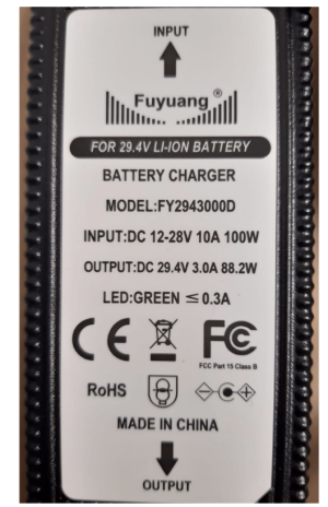

It looks like a simple 100w panel could be used directly as long as the open circuit voltage is not above 28V. The 12V charger adapter(DC-DC converter) should look after the charging process. 2 panels in parallel could cover the cloudy days.

That's why I included the specification label which indicates that the input can be 12v to 28v. If the input is 24v it will only draw 4A to produce the required 29.4v 3A for the charging. A solar panel should be fine for this but I would check with the manufacturers. The only problem I can foresee is if a cloud comes over and the panel output drops below 12v the charger might have some intelligent algorithm that resets or gets out of sync with the charging cycle. In that case a battery buffering the panel and keeping the voltage up might be necessary.
