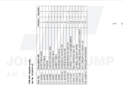

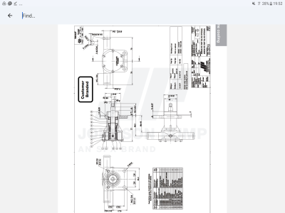

A quick search gives a Johnson part number for the complete pump as 10-24751-01 which is a F4B-903 model.
Individual part numbers of cam and screw and copper washer are shown below. The screw is shown as a 8-32UNCX8
