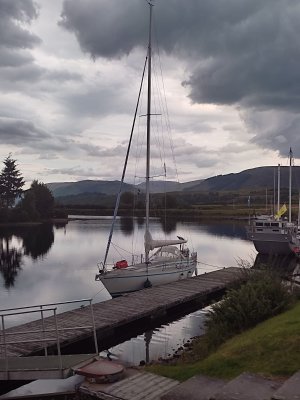

I might just stick with my current boat. A Stephen Jones Hustler 33. Good old IOR boat that weighs 4t and runs like a train on rails downwind. Also fractional rigged but fixed stays and swept back. She’ll be flying in the trade winds.

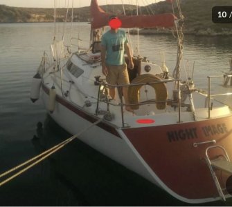

That's interesting and useful, thanks! So, considering that:
1. The rig was originally a masthead (with runners already there) then at some stage they added an extra section at the top to make it into fractional.
2. The boat in question (as shown in the picture) has a fixed backstay; two runners starting from the top of the mast level with the forestay and two lower runners starting from halfway between the first and second spreader.
Can we conclude this post by saying that both sets of runners are not integral to the solidity of the rig whatever the wind/sea conditions and that they are only there to add extra support to the rig going upwind in rough conditions and also to enable pointing higher or performance tuning?
I am told by the owner that he sailed the boat in question single hand from Sweden to Greece via the Shetlands in whatever conditions including a F8 with 6m+ waves without problems. I can only assume the rig is strong enough.
