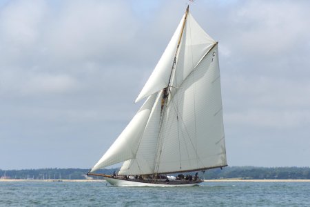

This is the way to do it. A photo by John Green of my favourite big boat, the Mariquita.
Note the lee runner (checkstay in modern parlance) and the lee preventer (backstay in modern parlance) are both set up and she can tack on a sixpence.IMG_4060.jpeg
Note the lee runner (checkstay in modern parlance) and the lee preventer (backstay in modern parlance) are both set up and she can tack on a sixpence……
……. with her usual race crew of 30 or so :cool:
Lovely boat that have seen often - sometimes off Fairlie where she was built. But not an average blue water cruising boat!

That's pretty.
With two crew, would only take about a day to get onto port tack.
The lee runner is set up. Putting a straight edge on the picture, it's taut. The lee preventer may have been eased a tad, as there is a slight curve in it, but not much. I think she can tack on a sixpence, and considering the speed with which she is thundering towards the Beaulieu River in the picture, I fancy she did just that.
