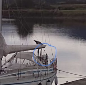

I’ve seen this boat for sale and I’m interested but a bit concerned about the complexity of the rig. See picture.
What do people think about this fractional rig? The boat has a big ballast and fairly heavy displacement at 6.5t (35ft boat). 45% ballast to displacement ratio.
From what I can see it has two running back stays and two additional side running stays. The aim is to take the boat to the Caribbean and Pacific. I’ll be shorthanded.

Its not easy to see in the pics, but it looks like the sprreaders have minimal sweep aft.
This generally means that you need to keep the running backstays on to keep the mast standing & for forestay tension.
If the boom is able to clear them (and the roach of the main) then you can probably set & forget while cruising.
If they don't clear, then every time you tack or gybe, you will have to release one runner & tension the other.

The spreaders are swept back, so no real need for running backstays. Just remove them and fit a single fixed backstay.
You may how to have the leech of the main re-cur though to clear the backstay if it has a big roach.

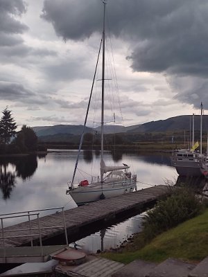

Actually I just spotted ( from the picture of the whole boat) that the back stay is fixed (but it splits in two at the bottom) and there are two additional running stays to strengthen the rig while going to wind in a blow i assume.

You would certainly need to use the running backstay whilst beating to tension the forestay, but should be able to sail at other points without tensioning them. You might need some tension in heavy airs downwind to steady the mast, but a reefed mainsail should cause no problems to gybe.
Luckily my ¾ rigged Fulmar has swept back spreaders, so no need for running backstays. The downside is greater wear on the mainsail whilst running from rubbing on the spreaders.

Looks a nice boat. It seems to have a backstay, what I take to be running backstays at the quarters plus some tackles taken down to the genoa tracks.
Don't know a lot about it but interesting.
You would not be wise to ignore the use of designed features, which are probably vital under reduced canvas and in poor conditions.

OK ... basically think on this ...
The Main backstay if its like mine - goes to masthead ...
The ruinning backstays go to mast near where forestay attaches ....
The two have different jobs.
Main sets the main rake and support of mast.
Running backstays set the forestay tension by tensioning the windward one ... tack and change stays.

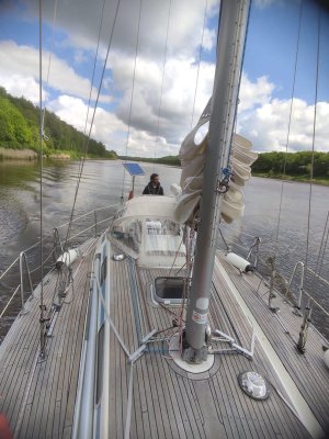

Here's mine with similar setup ...
Difficult to see but similar to OP's ...
The running stays of course being fastened at the fractional point on mast - mean they conflict with mainsail ... so lee has to be slacked to avoid this.
Am I removing them ? No. My boat is designed for racing and IMHO - that means designer had a reason to have them. Pain I admit ... but once you get used to them ... its not so bad !!
