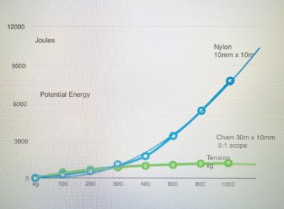

And here is the data. The calculations are based on 5:1 but you can extrapolate and understanding the advantages is easy. And it does not matter how strong the wind is - the nylon will continue to replace the effects of catenary. The data is also on the basis of all chain 5:1 and all nylon, same depth as the 5:1 scope. In real life you would use a combination of snubber and chain.
If we calculate, 5:1 scope and 30m of chain this then implies 6m from bow roller to seabed. A 'short' scope might be ... 3:1 which would be deployment of 18m of chain. So.... you can have a deployment of 18m of chain at 3:1 + the same 10m of 10mm nylon and the nylon will give you better reduction of snatch loads than with 10mm chain deployed at 5:1 (because the nylon stretches and absorbs the snatch loads much better than the all chain 5:1 scope).
The death of fears of short scope. :)
And no more hold reduction due to short scope - it can be consigned to history along with the 'Bigger is Better' mantra.
Now personally I think 10mm nylon a bit skinny for a yacht carrying 10mm chain - I'd use 12mm nylon and more of it (run it down the sidedeck - no need to be all forward of the bow, you could have 10m down the deck and 10m forward of the bow - but I'm being picky).
