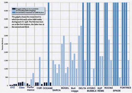

The 2006 YM/Sail/West Marine tests were carried out in three very different seabeds, one selected because it was poor. The concave anchors (only Rocna, Spade and Manson were in production then) plus Fortress held well in all of them. From memory the Rocna and Mantis did not quite make 5000 lbs in the poor one but otherwise all held at above this figure. All were 15 or 16 kg models except Fortress, which was proportionately too big in error.
Anchor pull tests are valuable, but nearly all have been conducted in good substrates that are very uniform. Alternative results would be helpful. For example, testing in weed would be invaluable, but this it is difficult due the irregular nature of the seabed.
You can have a look at the many photos I have taken of anchors underwater or look to Panope’s video results for an idea how various different models perform in more difficult seabeds, but some maximum holding power tests would be valuable.
The extensive 2006 study you mention was probably the largest anchor test and looked at four different sites. The Mantus was not tested (it was not around then). The three best performing anchors were the steel Spade, Rocna and Fortress. The 15kg steel Spade generated 2500 kg of holding power at three of the four locations, but only 250 kg of holding power at the fourth location. The Rocna generated 2500 kg of holding power at two of the locations, 1300 kg at the third and 750 kg of holding power at the fourth. The physically larger Fortress generated 2500kg at three locations and 750 kg at the fourth.
The Fortress is a great anchor, but it does not do well in difficult substrates (apart from very soupy mud) and the strong results suggest no locations were particularly difficult.
The only comprehensive static pull tests that have considered a difficult substrate were the Fortress tests in very soupy mud. The test results were very inconsistent, showing the problems of conducting this type of test in less than perfect substrates. The Fortress and Danforth did best, as you would expect. These anchors excel in this type substrate. All models suffered a significant reduction in ultimate holding ability here (it must have been very soupy mud). This shows how much reduction in holding power that anchors can suffer when the substrate varies. Even the Fortress FX-37 at 32° only achieved 451 kg. Setting the fluke angle to 45° improved this to 845 kg, but it is still well below the 2500 kg measured in more conventional substrates (at 32°).
The substrate is very important and will have a significant impact on the holding ability of your anchor. If you are expecting 2500 kg holding power all the time from a 15kg anchor (as some posts in this thread suggest) you will be disappointed.

Possibly then we could also agree that for any particular design, whether or not it is good for hard sand, soft sand or soupy mud then if the anchor is of the recommended size, for the yacht and the seabed, it will be impossible to use the full potential hold of that anchor - negating the need for a bigger one.
No, this is wrong.
If, for example, you look at the results of the extensive 2006 anchor test that Vyv raised, a 15kg Spade recorded an average holding power of 2500 kg in three locations, but in the fourth it only held on average 250 kg. This would not be enough for most cruising boats of the size that might consider this sized anchor. A larger Spade with its higher ultimate holding power would be required to anchor safely at this location for stronger wind.

No, this is wrong.
The reality is that you cannot predict whether this is correct or not. There are many reasons why anchors may not develop their full holding power and size is only one of them. The Chesapeake Bay tests showed that increasing the size of most anchors made no difference - they still dragged.
In the real world we reverse hard to test the anchor holding. If it drags we try again somewhere else.
Minor correction to your earlier post. There were three locations, as I said. They recorded results from the first twice. I am not sure why as I know they carried out dozens of tests in each location on every anchor. YM test table.jpg

Not only is this true, it is freely agreed upon even by those that argue that small anchors are adequate.
Look at the results in post #29 again. In this substrate a 6kg Spade only reached an UHC (ultimate holding capacity) of 120 kg. The 15 kg Spade increased this to 420 kg. Jonathan has suggested he would be happy with 600 kg for his vessel. It would need around 20-25kg Spade to achieve this holding power in the test substrate and the Spade was the best performing anchor in this test.

It will depend on the substrate but it is the real world we operate in. If true, then a massive argument for over sizing.
Precisely the kind of data I have asked for several times. The measure is hold achieved against load applied. So if I set my anchor using my engine I am applying between 250-300kgs. The size of anchor is irrelevant - the hold will be the same. This will continue as the load increases (the wind gets up) until the anchor drags - and both anchors will behave the same. The question then is whether the larger anchor will hold for higher loads.
It seems to be accepted that dragging is now rare, and when it does happen it is more likely to be because of the nature of the substrate , too little scope, poorly set etc rather than limitations of the ultimate holding capacity of the anchor
