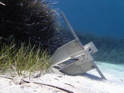

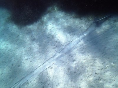

This is an example of a Guardian (the slightly simplified and less expensive version of the Fortress) struggling to penetrate hard sand. Despite a reasonable anchoring technique and giving the anchor plenty of opportunity, it only managed to penetrate with the toe. You can see the long setting distance in the second photo. 6m @4:1.
Nevertheless, the skipper stayed overnight. It shows how you can often get away with an anchor that in reality is performing poorly.
