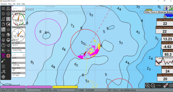

I dragged!!
Red before, magenta now.
Now that is interesting. 😎 No real wind from that direction don't think. LAT/LONG/wind/heading/sog/cog all in a database. Might take a few days with an AI to get the data into some sort of useful format.
If anyone wants an objective chat about digging into the data & see if anything useful can be found it's blatantly oblivious here is not the place. I've a random discord channel, Join the Raspberry Pi boat monitoring Discord Server!
Good a place as any imho, public forums just end up in a conformation bias fueled bun fight. 🙄
It looks like you might need tide information as well, since the AW and TW seem quite different. With a strong tide, this could be close to impossible to decipher, and even to decide if you did drag. Maybe not. The location of the original drop would also help.
Pretty sure it didn't drag but a silly error instead. To get it to fit the range ring distance seemed to need to be greater than the chain length, but if you remember that the gps isn't at the bow it all seems to fit better. Confidence in the impeccably (so far) behaved oversize spade restored. But a good thing to think it might have dragged really, reminders to keep a very open mind & not have too much confidence in anything are a good thing 😎 Opposite of "the forum way" 😂
AW &TW seem OK I think but in the previous image the heading sensor was turned off. I did have a look at tide regarding the range ring but it's less than 3m here & with some simple Pythagoras it doesn't really make enough difference to be bothered about.
Regarding the drop, tried to be very careful logging the position at the bow when the anchor drops so often but it never seems to work. Don't like buoying the anchor but at some point will have a little float on a pulley & weight attached to the hook so it's easy to go out with a mobile phone & measure pretty accurately the position & try to see how accurate the final position is to the drop position. Which is sort of why I really don't rate these extended anchor threads, just reeks of conformation bias with page after page of extremely confident "it's like this, 62% of that & 20% of the other" Not a mention of ", hmm, maybe not.."
